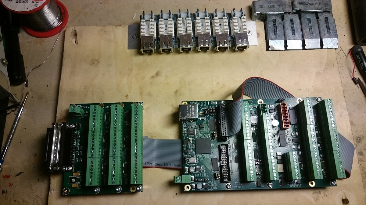

As regards the use of #1 I only need 3 encoders so 7i85S will fix this.
How do I setup HAL?
setp hm2_7i76e.0.encoder.00.scale [AXIS_0] ENCODER_SCALE
setp hm2_7i76e.0.encoder.01.scale [AXIS_1] ENCODER_SCALE
setp hm2_7i76e.0.encoder.04.scale [SPINDLE_9] ENCODER_SCALE
And then where do I connect the spindle encoder 3rd or 4th encoder input on 7i85S
I will have to pre-wire everything on this board before I put it in the cabinet, all connections will be with shielded rj45 cables.
Will go quad on step and A/B/Z on encoders so 1 RJ45 handles each axis. So 3x8 pins left over for 2xMPG Estop and combined home/limit, coolant.
Replied by tecno on topic Help needed to get my 7i76E + 7i85S + 7i73 on my mill going.
Tests done
#1 7i76e board for lathe is busted as regards pin 13, A/B flickers when shorting.
#2 7i76e board for milling machine seems to be OK so maybe it is so that I have watched wrong encoder like 00
So now edits have to be done to HAL and INI.
How do I setup HAL?

num_encoders=1 enables encoder.00
num_encoders = 2 enables encoder.00 and encoder.01
if you want encoder.04 active then you need to have num_encoders=5.
But you can connect any encoder in any active position. It is perfectly OK to use encoder.00 for the spindle and encoder.04 for the X axis if that is, for some reason, more convenient for you.

I still don't see what is doing the connection, say I want 04 in 1st how does LCNC know what is what?
- Posts: 19908
- Thank you received: 4660
04 Sep 2017 15:57 #98509
Replied by andypugh on topic Help needed to get my 7i76E + 7i85S + 7i73 on my mill going.
You can't have 04 first, it will always be 5th, (00 is first).
Where each encoder appears on the screw terminals is set by the firmware, and the only way to change that is by changing the firmware.
You can look at the manual for the card in conjunction with (I _think_ the contents of linuxcnc_print.txt in your home directory. (I don't currently have a machine running uspace).
Can you start linuxcnc then attach the contents of ~/linuxcnc_print.txt?

Or. start linuxcnc with the "linuxcnc" command from the command line, and look at that output for a pinout.

I use Halshow a lot to identify the signal names I want. I just drill down the tree to find the pin I want. (or sometimes its just a guess.) Then I know its exact name to use in my hal file. I then use the watch file to workout whats going on and review the documents to understand the function of the pins. Then I back out of the 7i76e pins and find the motion/axis/halui/hoint pins required, check the docs and try to understand their fucntion. Then I hook up the 7i76e pins to where they need to go.
From what I'm seeing you've used setp to set the encoder scale from your ini file but you also need to connect the hm2_7i76e.0.encoder.00.* encoder outputs to the right pins in hal so LCNC knows whats going on at the joint/motion/axis level
Promise me you will NEVER use pncconf from this day forth. The Mesa environment has become far too complex and it has never kept up.
