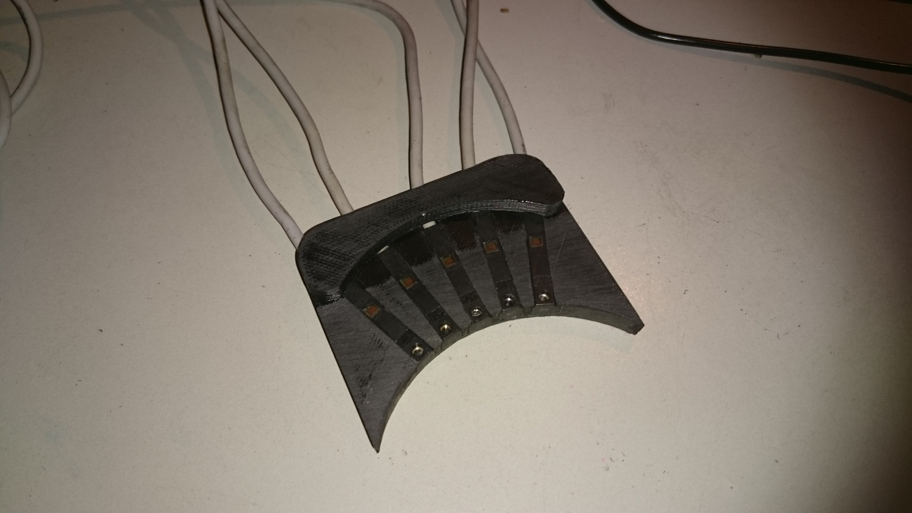

- tecno
- Posts: 1850
- Thank you received: 127
21 Dec 2017 12:57 #103440
by tecno
Replied by tecno on topic Help needed to get my 7i76E + 7i85S + 7i73 on my mill going.
- Posts: 12178
- Thank you received: 4155
21 Dec 2017 15:39 #103442
Replied by rodw on topic Help needed to get my 7i76E + 7i85S + 7i73 on my mill going.
Looks nice!
- tecno
- Posts: 1850
21 Dec 2017 15:44 #103443
by tecno
Gday Rod, thanks.
I hope it will serve me well.
- tecno
- Posts: 1850
22 Dec 2017 11:03 #103461
by tecno
- tecno
- Posts: 1850

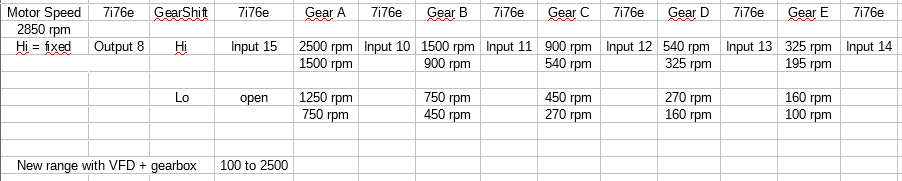

23 Dec 2017 10:40 #103487
by tecno
Cabling ready and tested so now it is time to tinker how to get this all working.
With above I get 100 to 2500 rpm, spindle motor fixed to high speed = 2850 rpm and Hi / Lo + Gears A to E.
So what would be the best way to get this working? Yes there are combinations of settings allowing two ranges.
Any pointers on what to read?
- Posts: 12178
23 Dec 2017 11:11 #103488
Have a look at lut5 as that gives you 5 bits of input. Its pretty cryptic but I am sure Andy will help you. He's the expert on it.
I think once you resolve lut 5 to a speed, you should be able to use a mux2 to multiply the result by 1 or 2 depending on the hi/lo gear selection.
