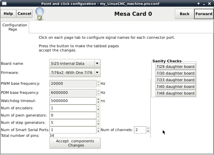

Hi
I bought a 6i25 + 7i76 plug and play kit from the Mesa store.
Card seems to be there in lspci -v and I can see at least some pins with halrun show pin.
Should I see more 7i76 pins in halrun? Do I need to add external power the 7i76 to see its pins in halrun, or are the 7i76 pins also named 5i25? Maybe this will be clearer to me as I get further in the setup.
Se attached txt files.

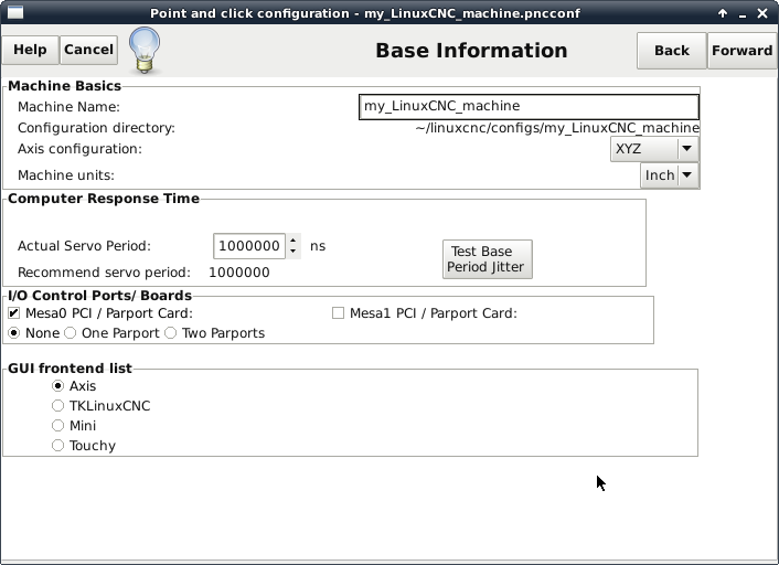

The major problem I am having is that the pncconf does not look like the documentation
linuxcnc.org/docs/2.7/html/config/pncconf.html
I have attached screenshots of how my pncconf looks.
I am using linuxcnc 2.7.8 and since I bought the plug and play version I have not used any mesa flashing.
What am I missing?
Would be thankful for some assistance in getting through the setup of these cards.
Patrik

16 Aug 2017 10:48 #97582
Replied by PCW on topic 6i25 + 7i76 plug and play, card not showing and no tabs in pncconf.
First to see the additional I/O tabs in pncconf, you must click the "accept component changes" button
(pncconf doesn't actually access any hardware here so this will work whether you have the hardware installed or not)
No 7I76 pins will show in hal up unless the 7I76 is fully powered (5V and field power)

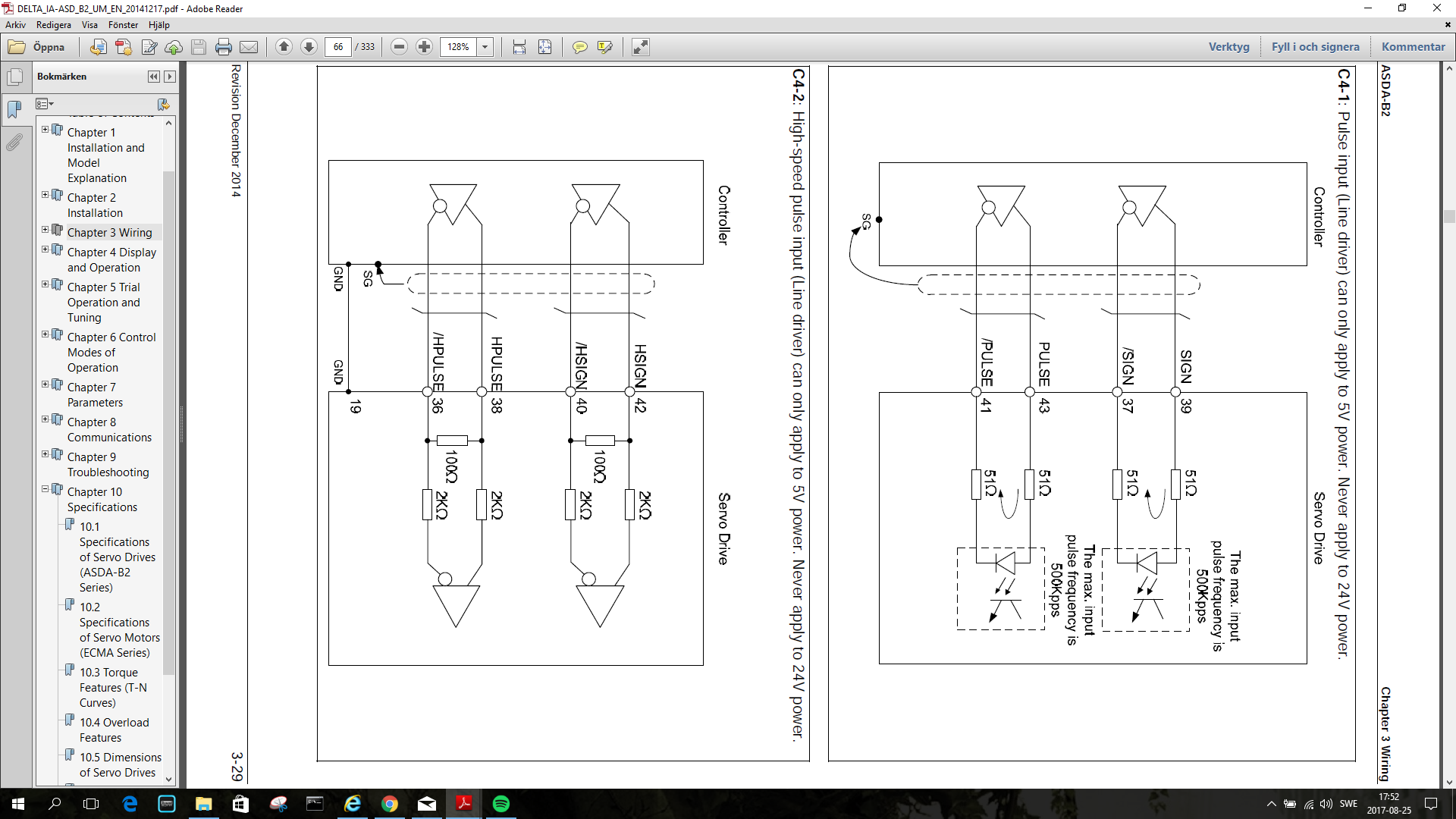

I am about to wire the 7i76 to the Delta ASDA-B2 servo drive.
I attach a wiring diagram from the servo drive manual.
I shows two possible wirings, I may use the high speed one.
Should I use both step+ and step- in either of the wirings?
Patrik

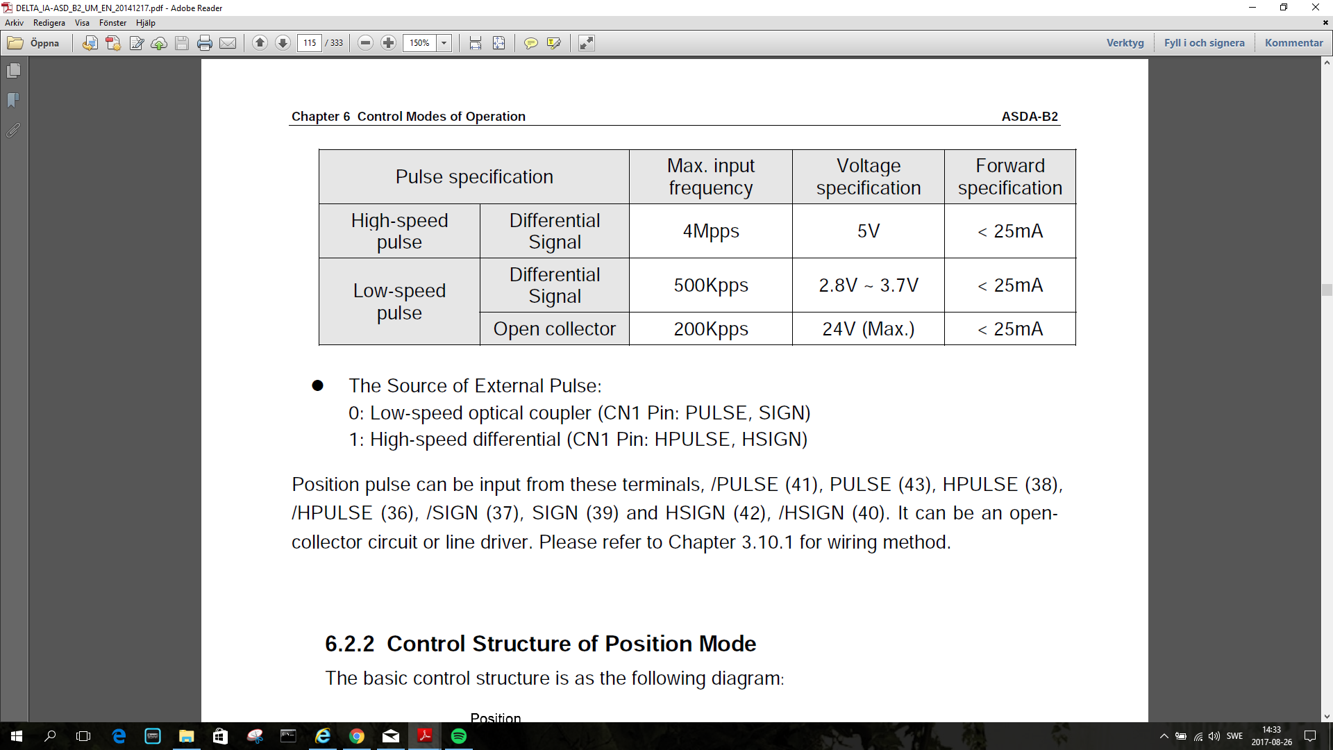

I guess the answer is that I should only use step+.
Looking at the high speed wiring in the previous diagram I see a 100 ohm short circuiting resistor I do not like.
5 Volt over 100 ohm is 50 mA. In the 7i76 manual I read that the 5 V step/dir signals can drive 24 mA.
Conclusion would be that I cannot use the high speed wiring.
But in the Delta servo manual there is also information saying that the high speed signal's forward specification is <25 mA, see attached picture.
What is "forward specification"?
I must ask Delta support to clarify this contradiction.
Can you say anything about what is the correct/safe way to proceed?
Best regards

26 Aug 2017 10:18 #98041
Differential mode is generally better, so:
You could use a Ohmmeter to see if the input termination is actually 100 ohms
Often high speed inputs use AC termination (100 ohms in series with a small capacitor)
The 7I76 outputs will drive AC terminated inputs without issue
If the inputs are actually 100 Ohm DC terminated, you could add a 50 Ohm series resistor
to one of the 7I76's outputs to limit the output current to <24 mA
(the 7i76 outputs already have ~75 Ohms differential output impedance)

26 Aug 2017 10:45 #98042
by Patrik T
Replied by Patrik T on topic 6i25 + 7i76 plug and play, card not showing and no tabs in pncconf.
I measured the input to 220 ohm. It seems it is not AC terminated since the ohmmeter shows a steady 220 ohm.
This means it will draw 23 mA when 5 V is applied.
In single sided mode it ill draw 23 mA only when the pulse is high. In differential mode it will draw 23 mA always, right?
Do you recommend I use differential mode (both step+ and step-)?
