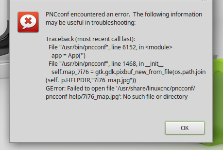

I'm getting this error after upgrading to 2.8.0-pre1-3687. Is there anything obvious I should try? I've searched the file system and can't find the "7i76_map.jpg" file.
Added: I went into the pncconf-help directory and copied a file named 7i77_map.png to a new file called 7i76_map.jpg and presto. It's working now.

Replied by cmorley on topic PNCConf Won't Start After Upgrade
I pushed a fix for this - thanks for reporting it.
