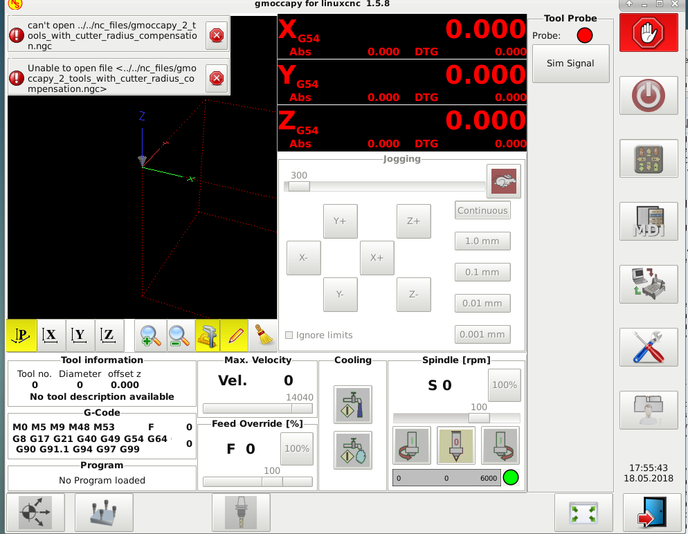

18 May 2018 17:02 #110859
by Lcvette
ok i had to install some new hardware components due to a latency issue but that is now resolved... so i started tinkering and i tried loading all of the sims and started getting error messages for some of them the same as with the config from my buddy, missing ngc files. I am guessing these sims should not be missing files as they should be inside the installed software. so this leads me to believe again that the issue is a compatibility problem. in fact i tried to open the sim and was unable to until i replaced the player.py file you attached previously. once i did that gmoccapy opened in the sims. i have not yet even brought in any of the files from my previous installation to this new system yet. it is just a clean installation of the debian stretch preempt rt. I am not certain if I am supposed to install additional software maybe? or where to get it from? the updates are saying everything is up to date. so im flying a bit blind at the moment.
here is a snap shot of one of the sims and its missing files errors similar to error messages i was getting with my buddies config files, missing ngc files.
thoughts?

18 May 2018 17:18 #110862
Replied by cmorley on topic odd error message popping up for missing GST file?
check in YOUR_HOME/linuxcnc/nc_files for a broken link.
(YOUR_HOME will be of course specific to your computer)
In theory that file gmoccapy references in the error code should be in that folder
or at least linked to that folder.
The player.py is a known problem and was expected.
Chris M
