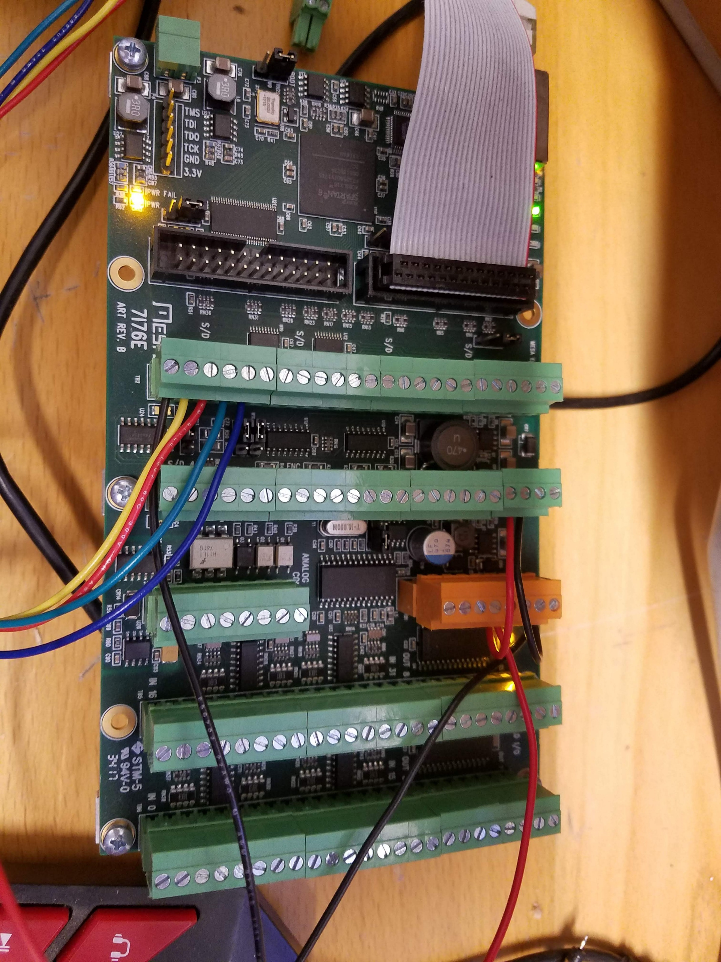

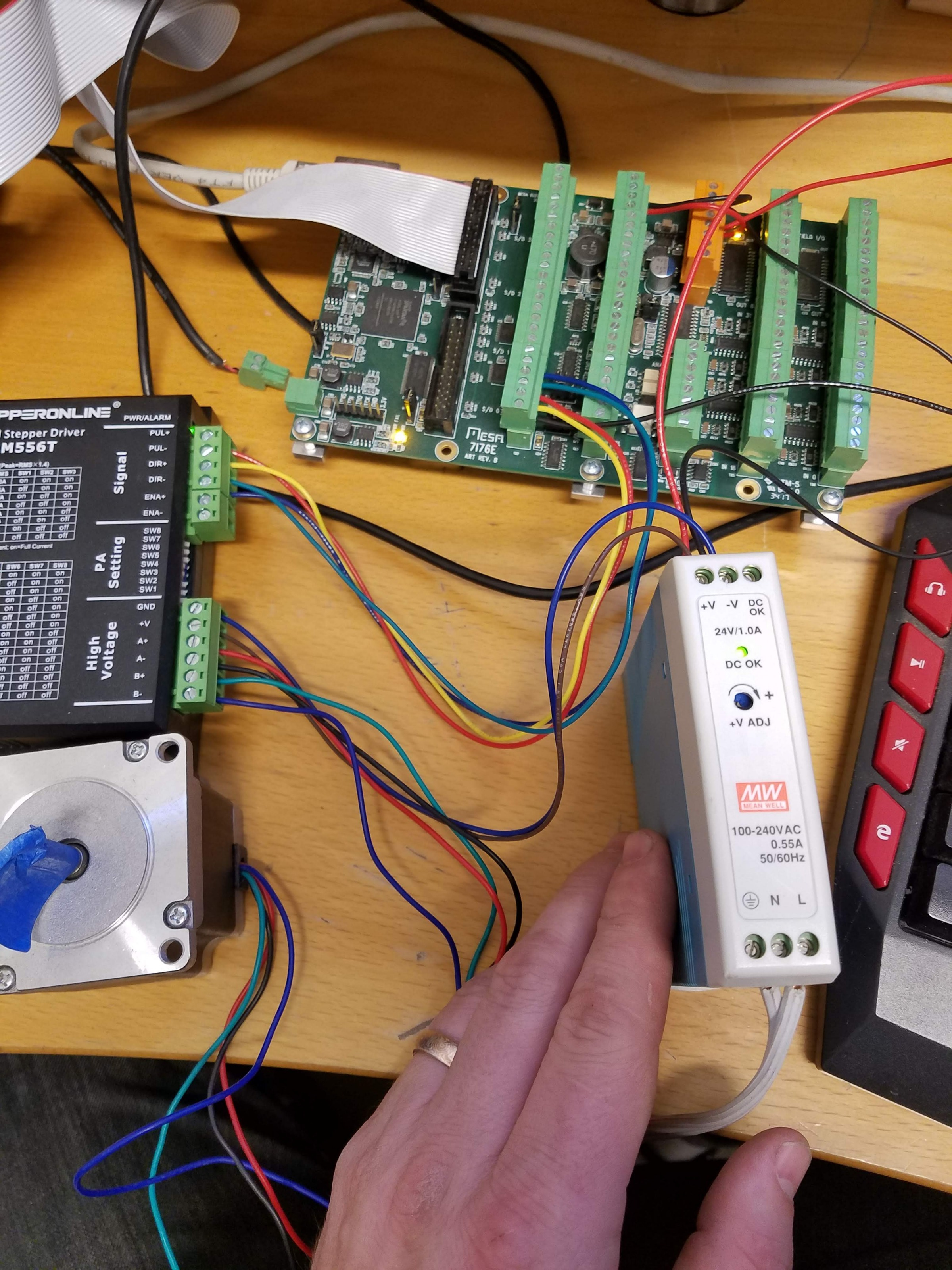

I just did another PncConf session with a simple configuration to see what I could learn. I didn't realize that the Mesa board should be plugged in for this...
Anyway, I still get:
I've got 24V to the pins 5 and 8 on TB1 and 24V to Pin 22 and 23 on TB3. Is there something else I'm missing?
Am I supposed to manually change the pins to hm2_7i76e.0.7i76.0.0.input-00 and such in the .hal file?

net home-z <= hm2_7i76e.0.gpio.019.inI've got 24V to the pins 5 and 8 on TB1 and 24V to Pin 22 and 23 on TB3. Is there something else I'm missing?
