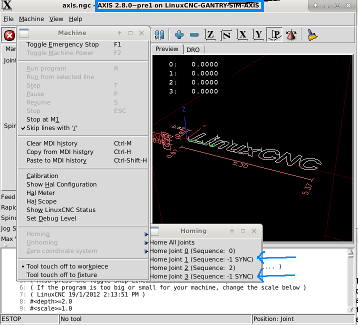

04 Nov 2018 19:39 - 04 Nov 2018 19:45 #119958 by dgarrett
Replied by dgarrett on topic Problem with MESA 7i76e and DQ542MA drivers
Until you home all, you are in joint mode and you don't
have a Y axis due to the dual motors (joints) and you can't
move them on their own
Use of the "Home All" button itself is not required as one can home
individual joints or synchronized joints as groups. Coordinated (axis)
movement is not available until ALL joints are homed whether you use
"Home All" or home joints (or joint groups) individually.
NOTE:
By default, the synchronization provisions disallow joint jogging prior
to homing in order to prevent joint jogs that could misalign the machine (gantry
racking for example).
Ref: linuxcnc.org/docs/master/html/config/ini...l#_inhibiting_homing
The above reference illustrates a method to move individual joints prior to homing
but it is not likely appropriate for a gantry with a racking liability.
Properly specified synchronized joints home together.
As an example, try the simulation config
configs/sim/axis/gantry.ini.
(No special hardware is required for sim configs)
This sim config uses joints 1 and 3 for the y coordinate:
[KINS]
JOINTS=4
KINEMATICS = trivkins coordinates=XYZY kinstype=BOTH
[TRAJ]
COORDINATES = XYZY
[JOINT_0]
HOME_SEQUENCE      = 0
[JOINT_1]
HOME_SEQUENCE      = -1
[JOINT_2]
HOME_SEQUENCE      = 2
[JOINT_3]
HOME_SEQUENCE      = -1
(kinstype=BOTH is useful and recommended as it clarifies the transition
from joint mode to cartesian mode once all joints are homed)
The axis gui provices dropdowns that allow homing of indivdual joints
or grouped joints when they are configured for synchronization.
Example:
For more info on homing, see:
Ref: linuxcnc.org/docs/master/html/config/ini-homing.html
