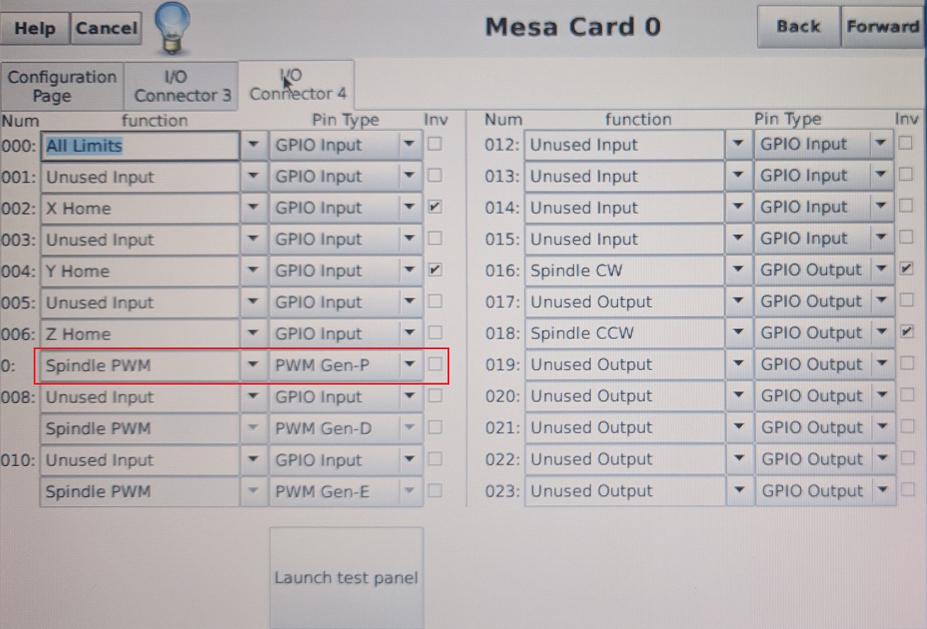

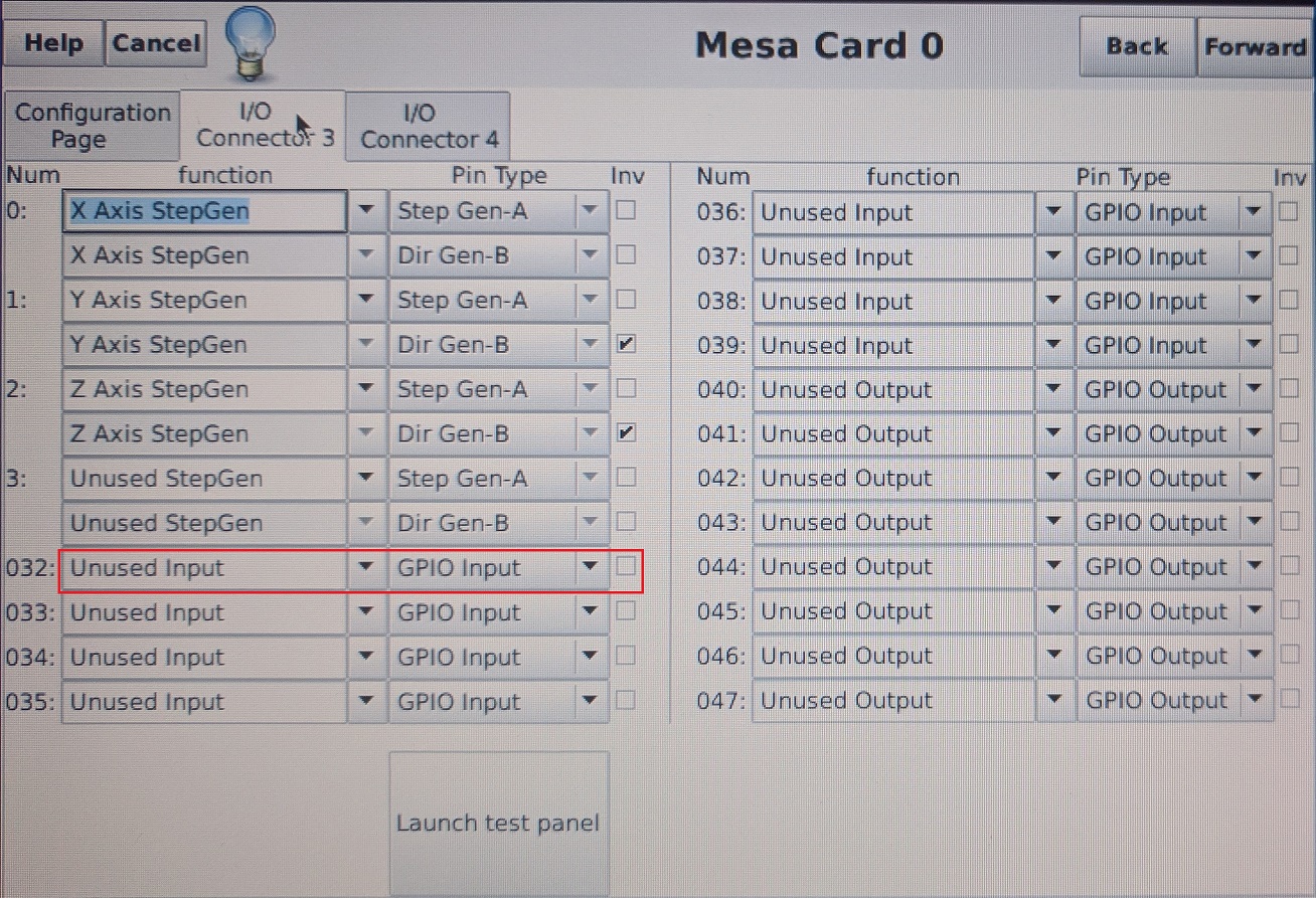

Would somebody be so kind and show me how to change spindle PWM pin 7 on connector 4 to connector 3 pin 32(-47). It is easy to do? Unfortunately, I’m not programmer so keep that in mind please. Thanks

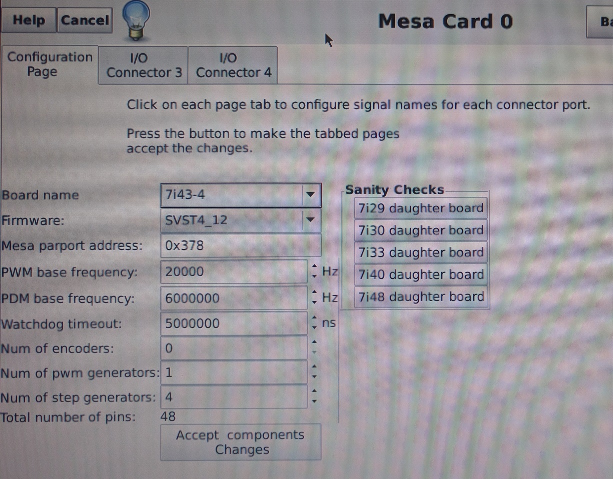

The FPGA pinout can only be changed by using different firmware (that is, the hardware PWM pin used is determined by the firmware loaded in the FPGA)
What is the PWM used for? If Low speed PWM is OK (say for spindle speed control) you have the option of using a GPIO pin and software PWM

Thanks for reaction. I guess easiest solution will be reroute cables between 7i43 and breakout cards.
