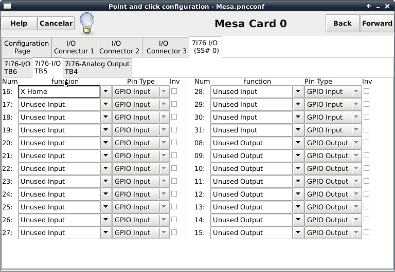

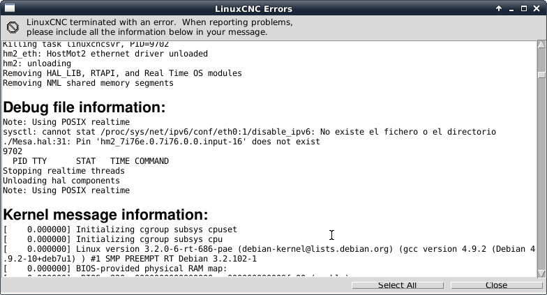

Hello all!
Mesa 7i76e TB5 / TB6 does not exist
I'm setting up my Mesa 7i76e with LinuxCNC and I am having problems setting the I/O on the TB5/TB6.
I can control the machine motors fine, the problem appears when I set something (an EndStop for example) to one of the I/O pins on the 7I76 I/O (SS#0) as I show in the attached picture.
The debug file is the one that I attach,
I am modifying the .hal file with the Pncconf, do I have to modify the .hal file by hand to make it work?
Could you help me?
Thanks!

Replied by tommylight on topic Mesa 7i76e 'hm2_7i76e.0.7i76.0.0.output-16' does not exist
There is no power connected to Vfield, read the manual there must be another power source wired to the TB1 field power connector, anything from 8 to 28V.
