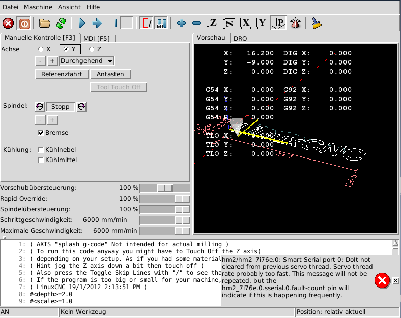

7i76e error was created by steos
i want to chance from windows to linux.
my first part is to make a try setup before i install in my machine.
Linuxcnc is running Mesa 7i76e is working stepper motor works but i get an error message.
i don`t know how i can fix it

Replied by cmorley on topic 7i76e error
I believe that is a smart serial communication error.
IIRC that can be cable problems, marginal power supply problems...

i tried another PSU and cable.
testing to change network to 10.10.10.10 with the same results.
also the 7i73 was working i can swithing the I/O`s
now i have to order a new 7i76e i killed by testing but it`s my fault.

Replied by PCW on topic 7i76e error
Almost always the "DoIt not cleared" error is cause by latency issues on the host PC
To verify this, run the command:
halcmd show param *.tmax
This will show the individual and total ( servo-thread.tmax ) times used by LinuxCNCs real time functions. These times are in CPU clocks, to get an idea of the total clocks time per servo thread period, look at motion.servo.last-period
Also what host PC hardware are you running? If you have a Intel or Qualcom MAC you must make some driver setting adjustments with the ethtool utility

Dell Optiplex 3010
Intel(R) Core(TM) i3-3220 CPU @ 3.30GHz
Realtek Semiconductor Co., Ltd. RTL8111/8168B PCI Express Gigabit Ethernet controller (rev 06)
halcmd show param *.tmax need some parameters
lg
Stefan
Dell Optiplex 3010

recently I updated my config at my 7i76E setup and switched from a J1900 Celeron with a wheezy installation to a Dell Optiplex System with an I3-2120 CPU and a stretch rt-preemt config.
This was nice until i get the same rt error messages like the author "steos"
Because you mentioned it before
Thank you for your help!
Greentings
Conny
EDIT:
I think I might have already found the solution here:
for Intel Chipsets you need to turn off IRQ coalescing by :
sudo ethtool -C ethN rx-usecs 0
Please feel free to correct me if I am wrong. But my avg ping times to the 7i76e already went down to ~0.1ms which is about 1/3 of the times without that setting.

Take a look at the hm2_eth manual page. Its has instructions
for editing the interfaces file to setup the static IP on the host
and turn off the irq coalescing option on the driver (this option will
add a lot of latency to Ethernet communications and needs to be disabled)
man hm2_eth
man hm2_eth
