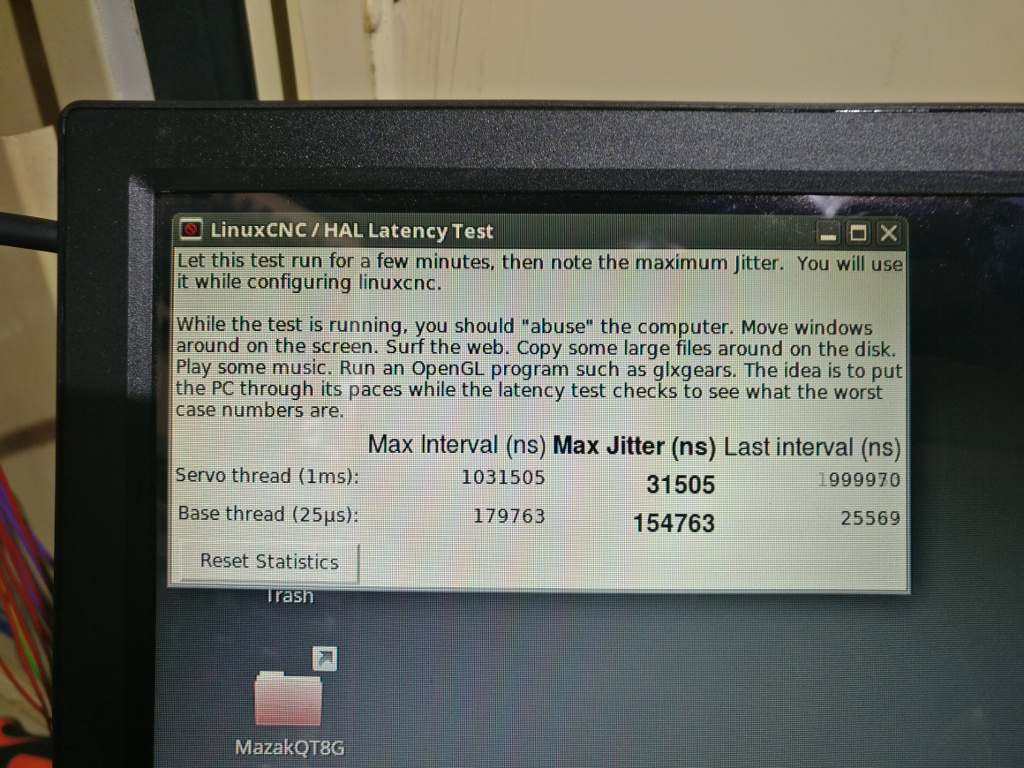

Hi
If this is placed incorrect, please tell me.
I got a Mesa 7i76e step/dir card, which I have setup on a old gaming pc, tried both debian stretch-uspace preemt from a iso, and a guide showing how to install Mint 18.1 with similar kernel setup. (the extend of my linux knowledge)
In hindsight both of these attempts had similar outcome...

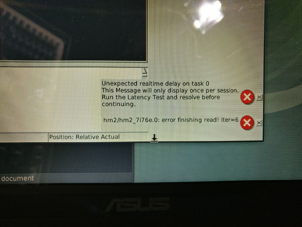

My issue is these two errors:
The first one is probably because of my insane latency...
Sounding like the noob I am: I have tried EVERYTHING!!!.....i can find googleing "Linuxcnc Latency problems".
Disabling power saving features and the like in BIOS, changed kernels and OS distro's, didn't seem to help much.
If latency is my issue, to me it seems the only solution is to get some new hardware. Is this really my only option?
"hm2/hm2_7i76e.0: error finished read! iter=6" I haven't had much luck on this error. Is it also latency? Or is it my Ethernet connection?
Before these errors, I get this popup:
I have no idea if these errors are connected to the previous.

That latency on the servo thread is actually OK.
You base thread isn't great. But you don't need a base thread. In fact you should probably turn it off.

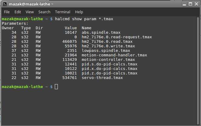

I've copy pasted this from another thread. it applies here also
if you have latency issues run linuxcnc and then run:
halcmd show param *.tmax
in a terminal window
This will show the individual and total ( servo-thread.tmax ) times used by LinuxCNCs real time functions. These times are in CPU clocks, to get an idea of the total clocks time per servo thread period, look at motion.servo.last-period
Also what host PC hardware are you running? If you have a Intel or Qualcom MAC you must make some driver setting adjustments with the ethtool utility
The "error finishing read" error suggests also be that the latency issue is possibly just because you have totally lost contact with the 7I76E, so I would check the Ethernet connection and 7I76E power supplies when running to make sure there is not an issue there.

I thought is was the base thread I was supposed to use... Saw on different post that 15000 to 30000 was the acceptable values, and got a little worried since I had 10x that amount! But is it really the Servo thread instead? well lucky me
How do I turn off the base thread? And if I may ask, what does it do/effect it has?
To PCW
Heres the result:

That looks fine (~133 usec max (534761/4000000000) assuming the CPU is running at 4 GHz)
Are all power management options disabled in the BIOS? (Cool&quiet etc)
You only need a servo thread
You can run the latency test with just a servo thread with
latency-test 1ms
or the latency histogram with
latency-histogram --nobase

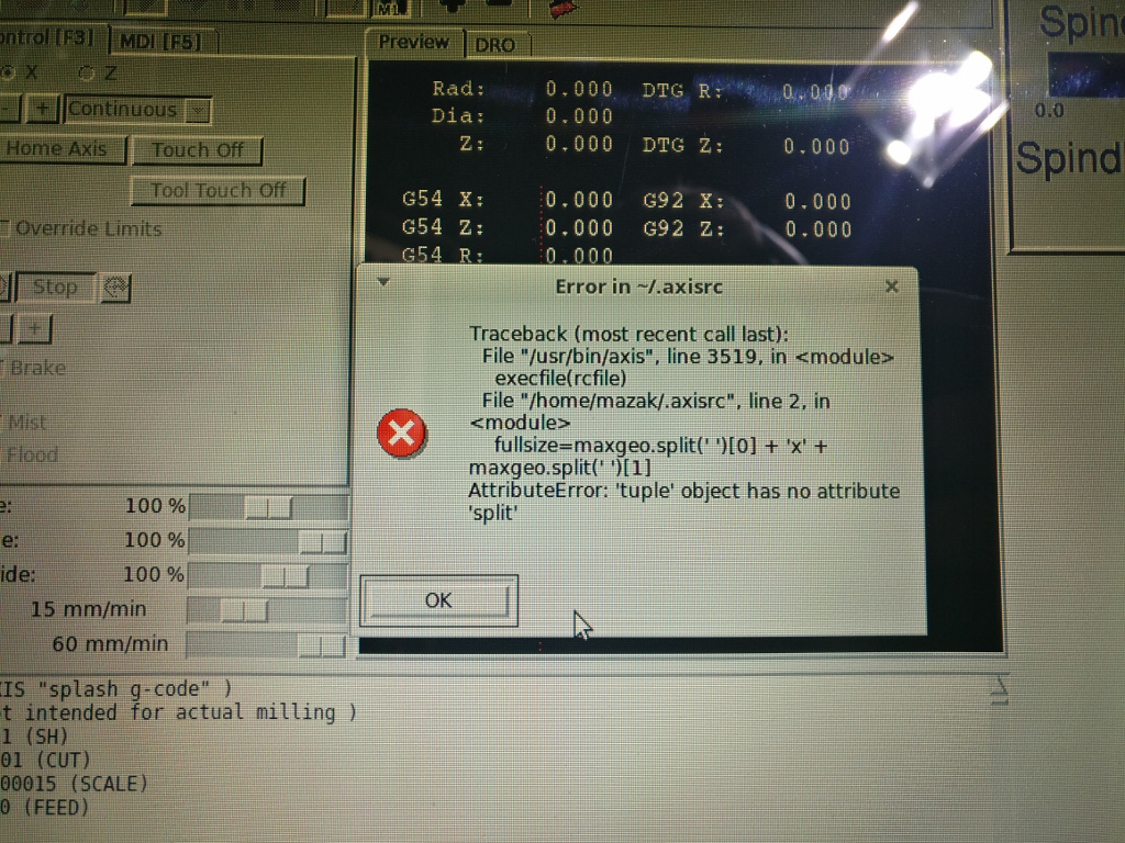

That "trace back error" you get when you use the stepconfig or pnccongfig and select the advanced option of making AXIS UI full screen at start up.

Unselecting the fullscreen option fixed the popup. Thanks!

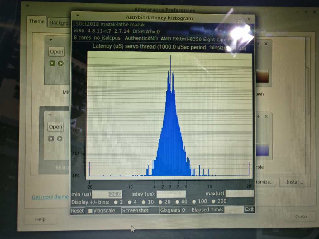

Running latency test with base thread off, shows 27739 ns in max jitter after stressing the computer.
Heres some pictures from bios and the histogram:
I don't know if there is a difference in "Disabled by CPU" or "Always disabled", but I just use the latter.
Sorry for the poor reflection, should have taken a screenshot instead. The "Theme" was messing with the font color.
min(us): -26.6
sdev(us): 0.6
max(us):27.1
And the elapsed time was: 766 sec
I reflashed the debian stretch uspace iso on a usb and booted to into it. The latency was significantly lower, and fairly stable(between 5000 and 10000 resetting after a couple of minutes) although when stressing the computer would spike into 350000+ values.
Does this confirm your suspicion on the harddrive? I guess the spikes are probably because its a simple usb2, and not being that great at handling load.
It would be cool if I could keep those values by just upgrading the harddrive, to something like a 60gb ssd?
Thank you guys for the great responses!

15 Oct 2018 02:17 #118823
Replied by tommylight on topic Errors caused by Latency or something else?
Those numbers look good, adding an ssd would get rid of much of the latency excursions. Avoid the non brand name ones.

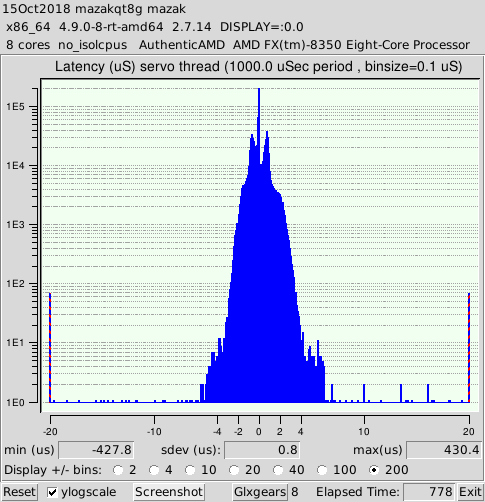

Here is a new screenshot of the histrogram on the new install:

15 Oct 2018 08:50 #118832
Replied by andypugh on topic Errors caused by Latency or something else?
The histogram seems to show latency of 430 uS, which is pretty terrible.
