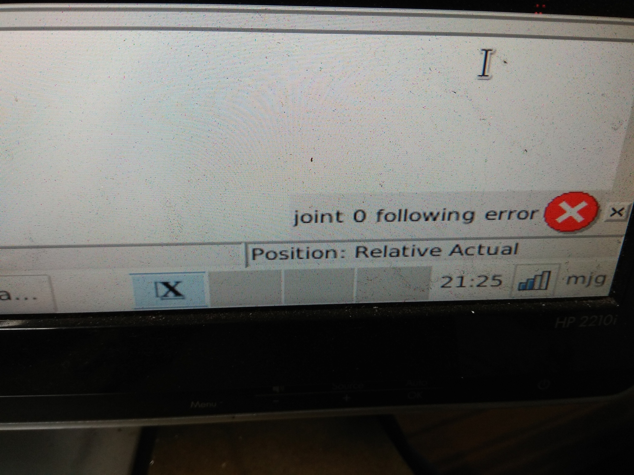

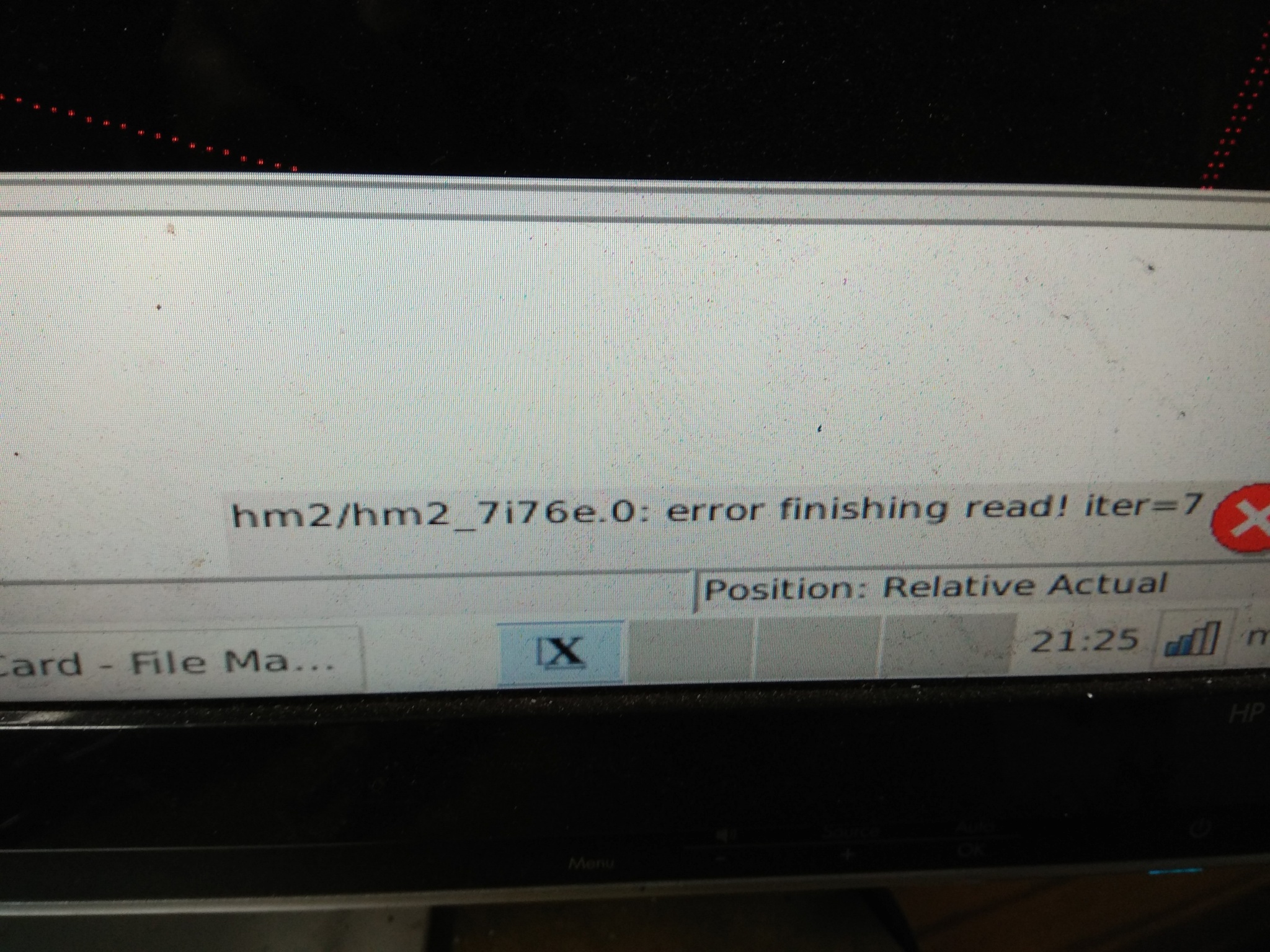

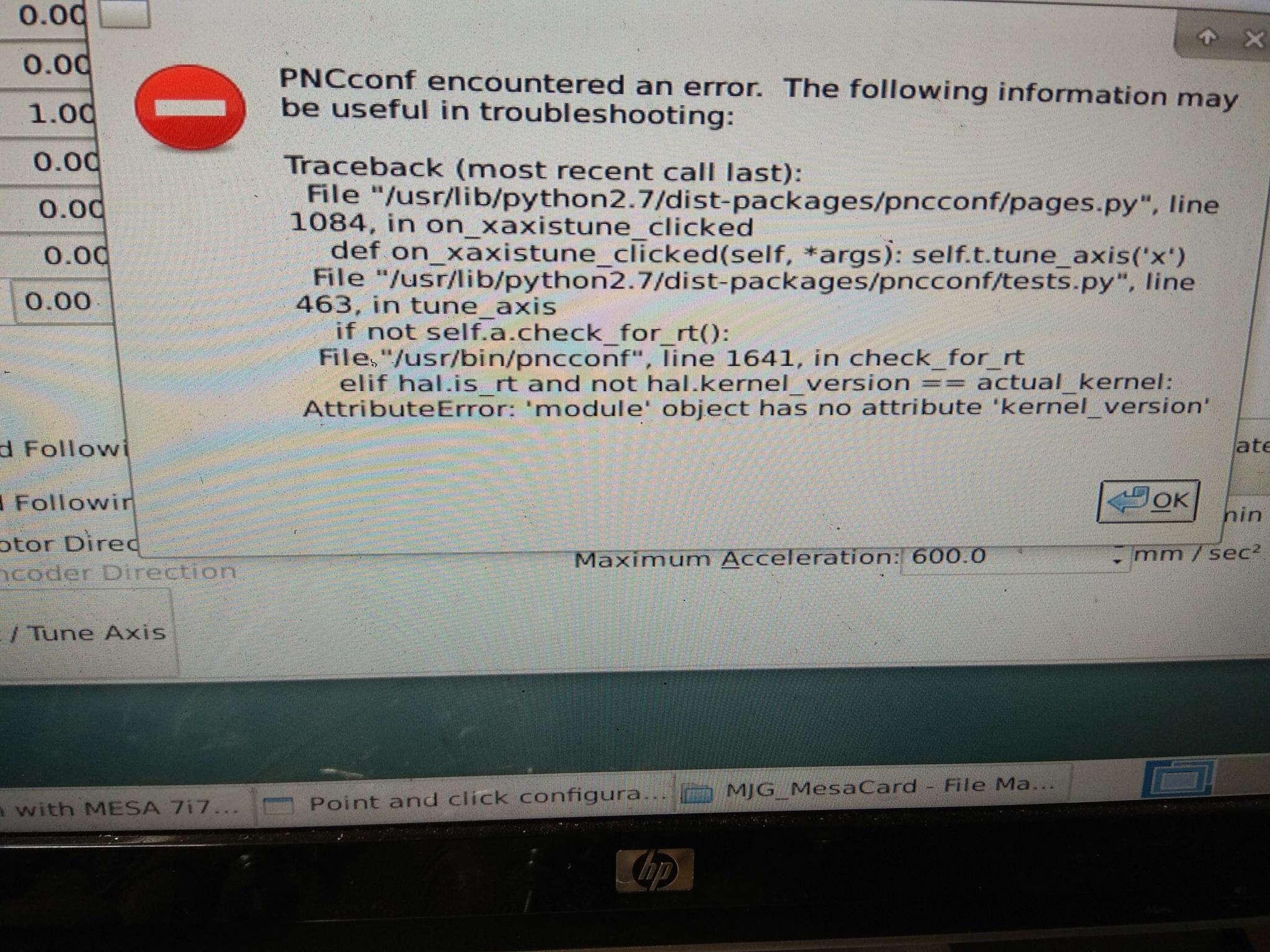

- Start PNCCONF and when i try to test axis i get error (IMG_20181103_212410.jpg)
Then when starting Axis i get (IMG_20181103_212510.jpg)
If i try to move the machine does nothing and give joint following error. (IMG_20181103_212528.jpg)
What is wrong or missing to do?

- Posts: 18122
- Thank you received: 5337
03 Nov 2018 17:21 #119886
Replied by PCW on topic 7i76E - Starting
The first image shows a lost connection from the host to the 7I76E
Also the ping times are quite bad which suggests a real time or network driver setup error.
Can you post:
1. Your current hal/ini files
2. What type of PC hardware you have (motherboard/CPU)
3. What Ethernet hardware you have on the host
( lspci | grep -i ethernet should show this)

03 Nov 2018 18:04 #119891
Change:
SERVO_PERIOD = 16000
to:
SERVO_PERIOD = 1000000
and you should be OK
