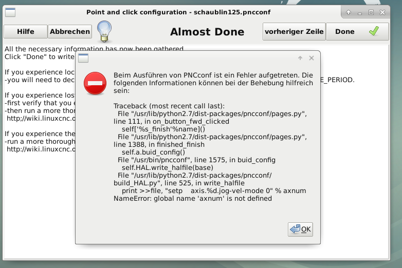

11 Jan 2019 21:17 - 11 Jan 2019 21:43 #123990
by trilobyte
Replied by trilobyte on topic 7i76e: MPG and Analog inputs with pncconf?
Last edit: 11 Jan 2019 21:43 by trilobyte. Reason: screenshot added

11 Jan 2019 22:47 #123997
I tried this in the latest version of pncconf in the 2.7 branch - what version of linuxcnc are you using?
it has to do with the selection of external MPG, on the external controls page. What option did you select and what di you select for the MPG encoder in the mesa page?
Chris M
Replied by cmorley on topic 7i76e: MPG and Analog inputs with pncconf?
>pncconf can configure 7i76e in mode 2 which allows two MPGs and analog inputs.
>Select mode 2 on the I/O connector 1.
if i select this mode 2 pncconf crashes when i try to safe and quit:
Chris M
