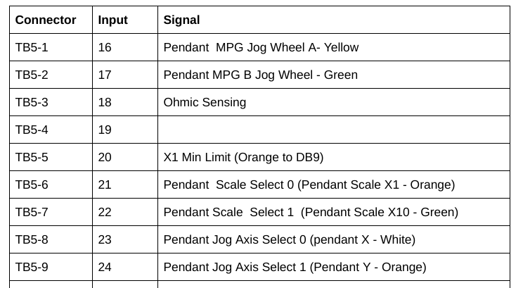

Replied by rodw on topic PNCConf Config (Think Im missing something)
I recommend you create a table similar to this and always update it before you add a wire This is for my 7i76e including the MPG input for my pendant
So if I am looking for a hardware connection on the 7i76e, I use the left hand column but If I'm looking in halshow, I'll use the second column.
If you search for spaceship plasma you should find my build and on about page 4 there is a complete breakdown on how to wire in a MPG and an axis selection using a binary coded switch. Just note you need to change the mode in your hal.
It is best to just get a basic moving config with pncconf and not even worry about velocities and acceleration as its much quicker to edit the settings by hand in a text editor. When I installed mine, I just used another example and did everything by hand

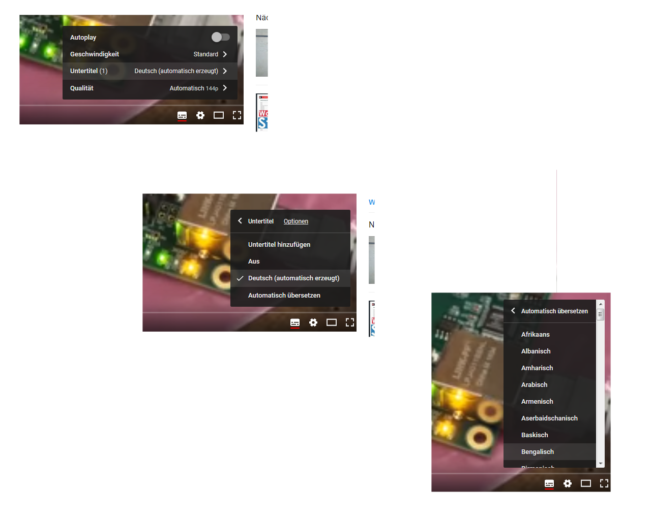

- Grotius
- Posts: 2419
- Thank you received: 2349
23 May 2019 21:16 #134771
by Grotius
Replied by Grotius on topic PNCConf Config (Think Im missing something)
This video is very nice, exact your setup.
I followed the german sprache in the video, But without sprache you can do it !!
In the comment's there is a link for translate : www.talla83.de/subtitle.png
