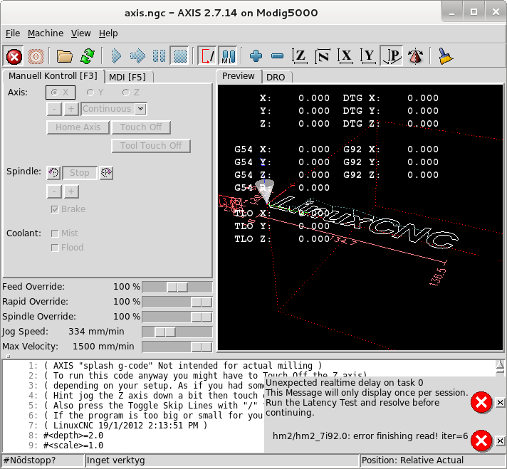

Hi when I try to start Linuxcnc I get the following error:
Have tried me out and got rid of various errors but now I do not see where it is "error" in the log file
The errors that I fixed.
wrong kernel
No Vfield feed :-)
Wrong firmware in 7I92.
Incorrect ip in the config.hal file. (I am using 10.10.10.10)
Print file information:

./Modig5000.hal:20: parameter or pin 'hm2_7i92.0.dpll.01.timer-us' not found

25 May 2019 12:05 #134904 by gambaf
Replied by gambaf on topic 7I92M/7I77 linuxcnc Startup Error?
this is your error:
post your HAL and INI file so we can see what's going on.
25 May 2019 12:09 #134905 by Clive S
Replied by Clive S on topic 7I92M/7I77 linuxcnc Startup Error?
It would help if you posted the hal and ini files.
But to me the fault lies at line 20 in the hal file ./Modig5000.hal:20: parameter or pin 'hm2_7i92.0.dpll.01.timer-us' not found
Try commenting that line out. with a #
25 May 2019 12:43 #134906 by PCW
Replied by PCW on topic 7I92M/7I77 linuxcnc Startup Error?
The config you are using doesn't have the DPLL feature
You can either comment out all the DPLL related lines as others have
suggested ( there are probably ~3 DPLL related lines in the hal file )
or program firmware that includes the DPLL:
7i92_7i77x2D.bit
25 May 2019 12:45 #134907 by CNCDoc
Replied by CNCDoc on topic 7I92M/7I77 linuxcnc Startup Error?
The cards are on the desk so I have not given so much thought to the settings yet.
When I comment away
#setp hm2_7i92.0.dpll.01.timer-us -50
#setp hm2_7i92.0.stepgen.timer-number 1
Then Lcnc starts up but with error:
25 May 2019 12:54 #134908 by CNCDoc
and CR16 lights up red on the 7i77
25 May 2019 13:07 - 25 May 2019 13:11 #134909 by PCW
Looks like real time issues
Did you run a latency test on your host PC?
What Ethernet hardware (MAC chip) does your PC have?
Last edit: 25 May 2019 13:11 by PCW.
25 May 2019 13:10 #134910 by gambaf
also, make sure you've booted into the realtime kernel (been bitten by this recently).
25 May 2019 13:19 - 25 May 2019 13:39 #134911 by CNCDoc
Yes ~50000
What Ethernet hardware (MAC chip) does you PC have?
Where can I see it?
The driver is "via-rhine"
stands on ic circuit on the network card
DL10030B
0327CD
23B4007300
Also noted that "INIT" turns red at 7i92 when Lcnc starts.
Edit.
my other network card gets the same problem
Last edit: 25 May 2019 13:39 by CNCDoc.
25 May 2019 13:44 - 25 May 2019 13:44 #134914 by PCW
No idea if the Via Rhine is suitable for real time so that might be an issue
(you can gain some idea with ping times)
Also, what is your servo thread period?
Last edit: 25 May 2019 13:44 by PCW.
