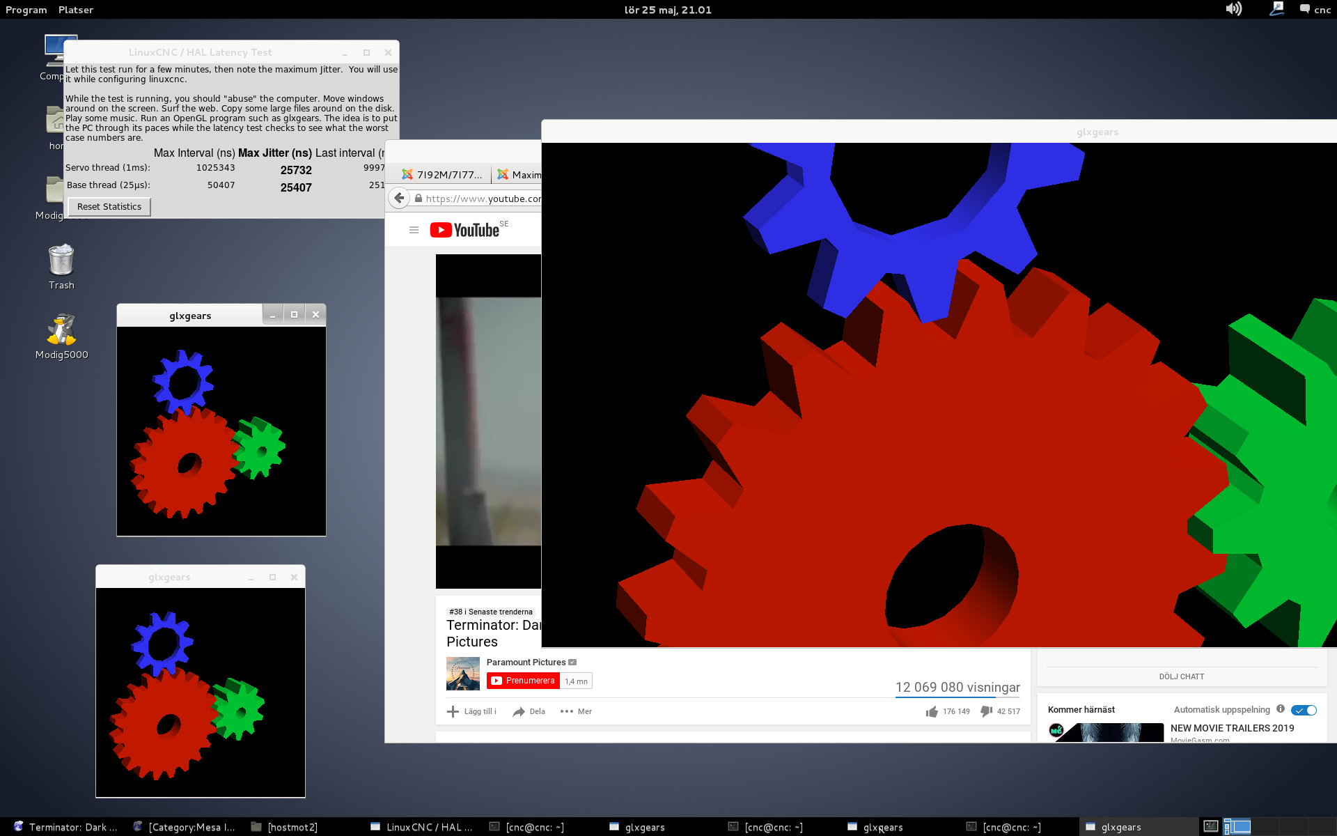

25 May 2019 14:13 #134916
Replied by PCW on topic 7I92M/7I77 linuxcnc Startup Error?
And servo thread period?

25 May 2019 14:19 #134917
by CNCDoc
Replied by CNCDoc on topic 7I92M/7I77 linuxcnc Startup Error?
50000
changes to 1000000
Now it works!
changes to 1000000
Now it works!

25 May 2019 14:53 #134923
Yeah, 50 us is not going to work for a servo thread on almost any hardware
The default servo thread period is 1 ms =1000000 ns
There's usually not much to gain with faster servo thread unless:
1. You have extremely quick acceleration (> 1G for laser plotter etc)
2. You have torque mode drives so the velocity loop must be implemented in
LinuxCNC
3. You have requirement of very high speed and combined high accuracy
LinuxCNC
