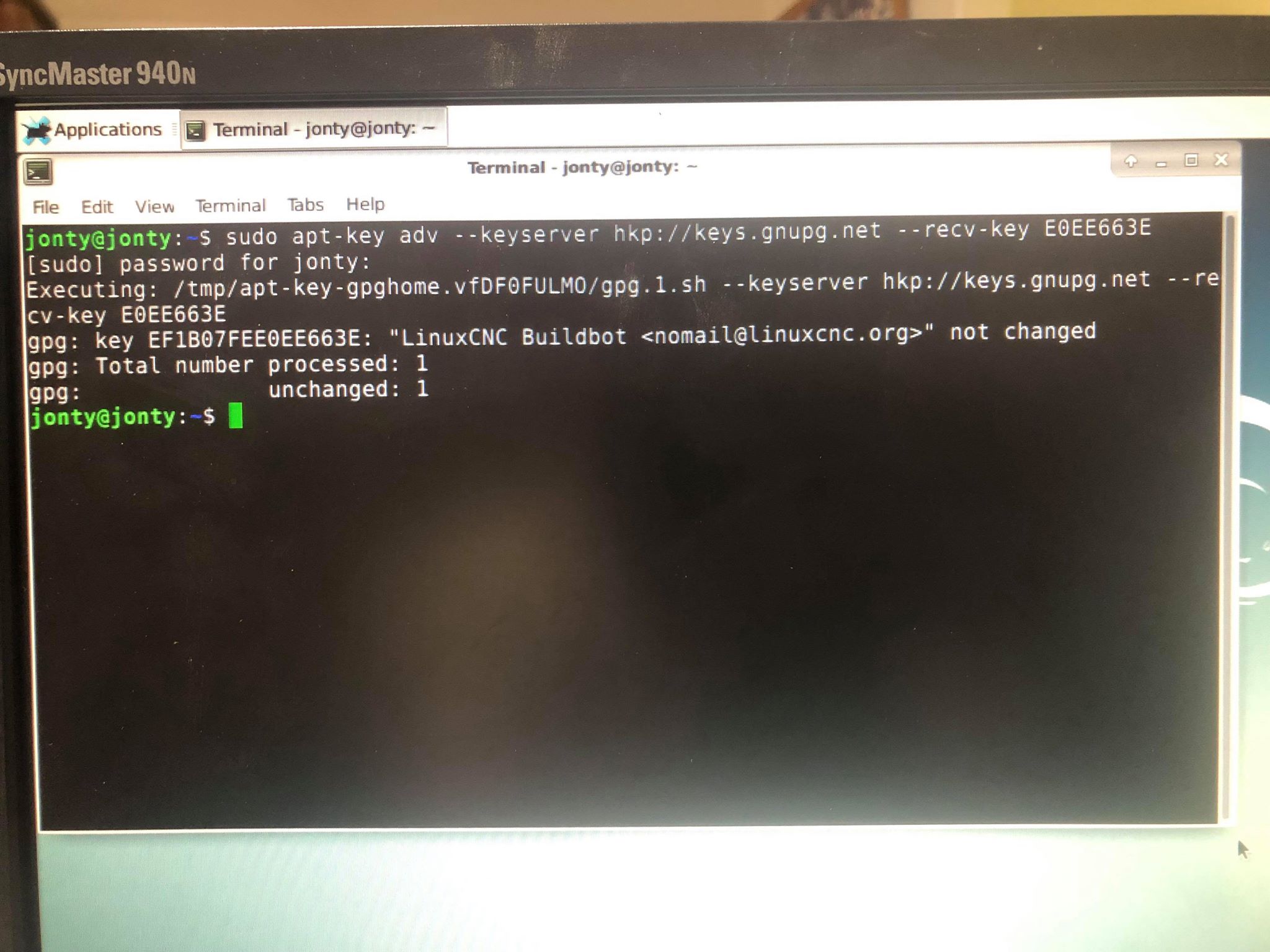

Now that I have, ive run into a problem when trying to run the LinuxCNC PlasmaC buildbot installation through a terminal.
When i enter "sudo apt-key adv --keyserver hkp://keys.gnup.net --recv-key E0EE663E" for the first time I got an error but then i installed "sudo apt-get install dirmngr" and got the following response when i re entered the first command.
now when I followed the next set of steps and got to searching the respositories for.
deb buildbot.linuxcnc.org/ stretch master-rtpreempt
deb-src buildbot.linuxcnc.org/ stretch master-rtpreempt
it only displayed the following.
any ideas?
thanks in advance
any ideas?
thanks in advance

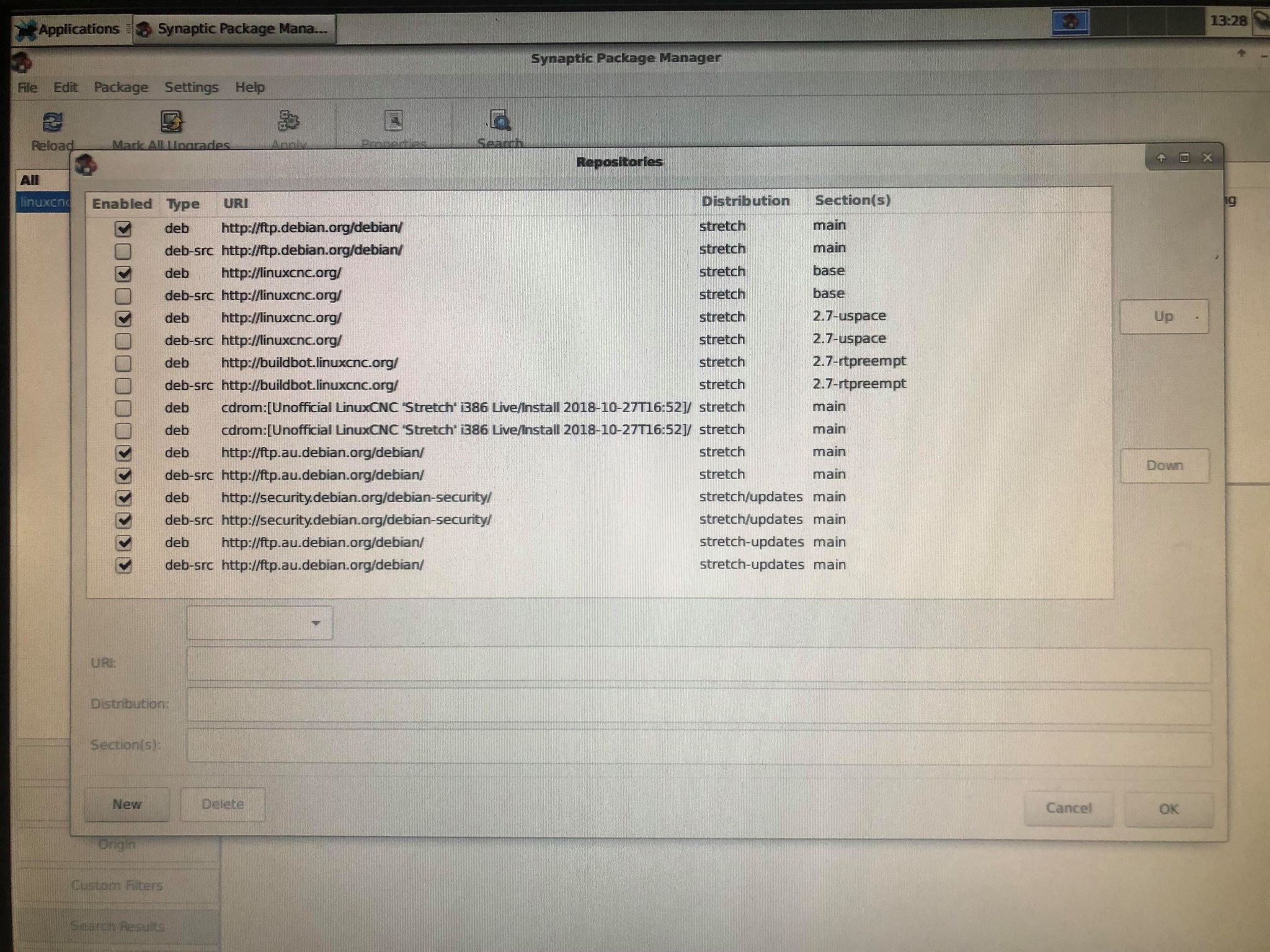

Are you talking about
>Synaptic Package Manager
>Settings
>Respositories?
And when you say get them in, do you mean click the tick nex to them or enter them manually by typing that address? Because they are not there, as you can see in the image in my previous post only 2.7 uspce and 2.7 rtpreempt are there.

That is all OK, except you added repos for the 2.7 version, you need to add the master version or 2.8 as i think PlasmaC is same on both.
After adding those repositories, you have to do an update by refreshing the synaptic or by typing:
sudo apt-get update
then you can:
sudo apt-get install linuxcnc
or might be
sudo apt-get install linuxcnc-userspace
sudo apt-get update
then you can:
or might be

My main problem is that 2.8 or master are not in the “>synaptic package manager >settings >repositories” tab. I thought that the
Would put the master or 2.8 into that repositories listbox for me to then check and add into package manager.
I’m extremely sorry for my ignorance but is this correct or am I missing something?

In the synaptics, where you are lookig at those repositories, select the 2.7 one, click edit, change to 2.8, save, close, reload and install.

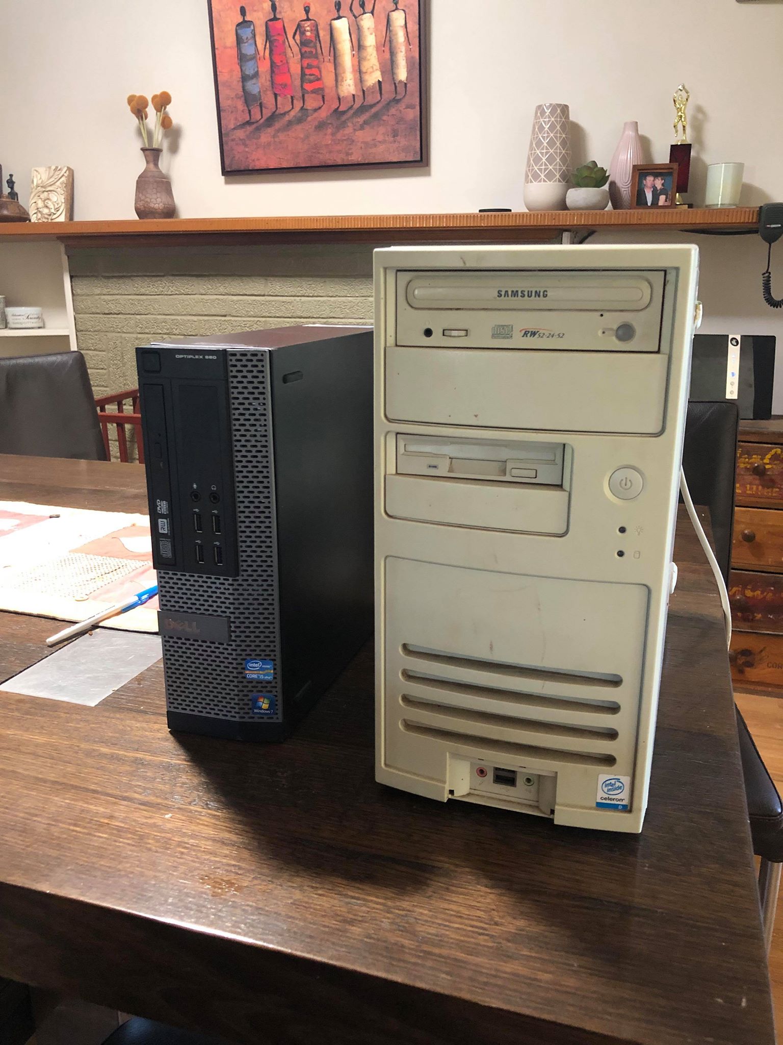

I thought it may have been my old 32 bit computer however I just purchased a new dell optiplex 990 but I am still getting the exact same errors. I really am not sure what I am doing wrong.
(Funny looking at the old vs new computer where the one with 8x better specs is half the size)
With this I was able to download v2.8

I don't know if this was ever made clear, and I may have missed something. But the kernel you showed was definitely an RTAI kernel and that definitely won't work with an Ethernet Mesa card.
