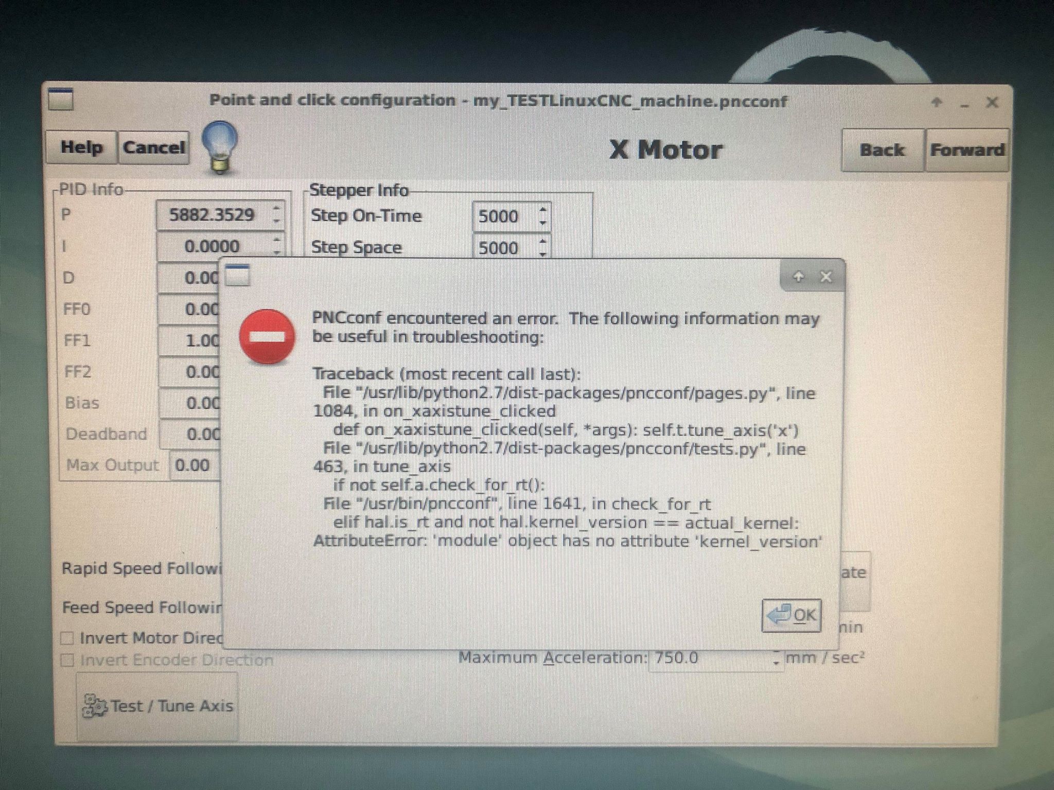

Hi All,
I tried to test my motors after a fresh install of linux cnc and recieved this message.
Does anyone know how to solve?
Thank you in advance!

What version of linuxcnc?
17 Nov 2019 23:05 #150558 by cmorley
Replied by cmorley on topic PNCconf encountered an error
I bet 2.7.14 - there is a fix for this but it hasn't been released yet.
It's a one line change if you want to try to fix it yourself.
change (aprox line 1641 in /usr/bin/pncconf:
        elif hal.is_rt and not hal.kernel_version == actual_kernel:
to
        elif hal.is_kernelspace and hal.kernel_version != actual_kernel:
See if that works. Not that many people use RTAI any more
Chris
17 Nov 2019 23:07 #150559 by little_sparky
Replied by little_sparky on topic PNCconf encountered an error
I downloaded the "linuxcnc-stretch-uspace-i386-r13.iso" image which gave me version 2.7.14.

17 Nov 2019 23:20 #150561 by cmorley
An educated guess based on the error. That is what the line of code is doing - figuring out what kind of realtime system is being used.
In a terminal:
uname -r
should let you know what kernel you are using in general:
RTAI will have rtai in the name
Preemptive will have _rt in the name
most others will have generic in the name
Chris

18 Nov 2019 00:05 #150564 by little_sparky
Chris, changing the line in the code worked and I no longer receive an error message.
However, now when I save the PNCconfig and open on the desktop it comes up with the following error.
I think it is because I have not downloaded hm2_eth or hostmot2 (if thats the same thing?). However I have been looking online and looked through the hm2_eth manual and still have no idea how to download or install it.
Error message:

18 Nov 2019 00:21 #150565 by cmorley
hm2_eth is included with linuxcnc - nothing to download.
hm2_eth: ERROR: 192.168.1.121: Could not retrieve mac address
Seems you have a network problem connecting to the board.
does your board use address 192.168.1.121?
In your other post you use 10.10.10.10
Chris
