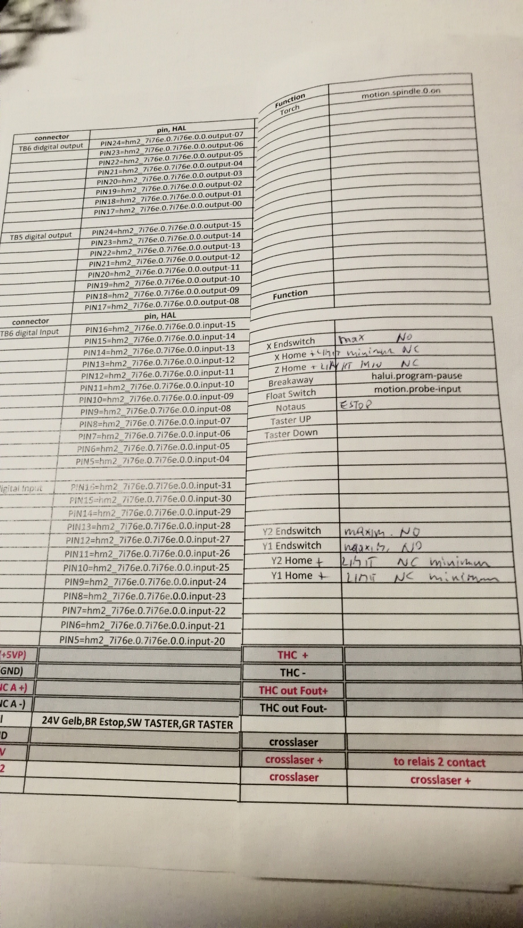

21 Feb 2020 14:27 - 21 Feb 2020 14:30 #158153
by CNCFred
7i76e breakaway switch configuration in wizzard possible? was created by CNCFred
Last edit: 21 Feb 2020 14:30 by CNCFred.
- Posts: 18122
- Thank you received: 5337
21 Feb 2020 17:03 #158163
Replied by PCW on topic 7i76e breakaway switch configuration in wizzard possible?
Yes NC switches will read true when off limit so must be inverted for use with 7I76 inputs

22 Feb 2020 01:47 #158175
by CNCFred
Replied by CNCFred on topic 7i76e breakaway switch configuration in wizzard possible?
I think breakaway switch is Plasmac configuration.

22 Feb 2020 02:52 #158181
Replied by tommylight on topic 7i76e breakaway switch configuration in wizzard possible?
Look at the " floating switch" LED in the GUI you are using, move the torch up by hand until it trips the switch, the LED should be ON when the torch triggers the switch.
If it is not, invert it in hal.

he asked on the breakaway for pausing the cut
