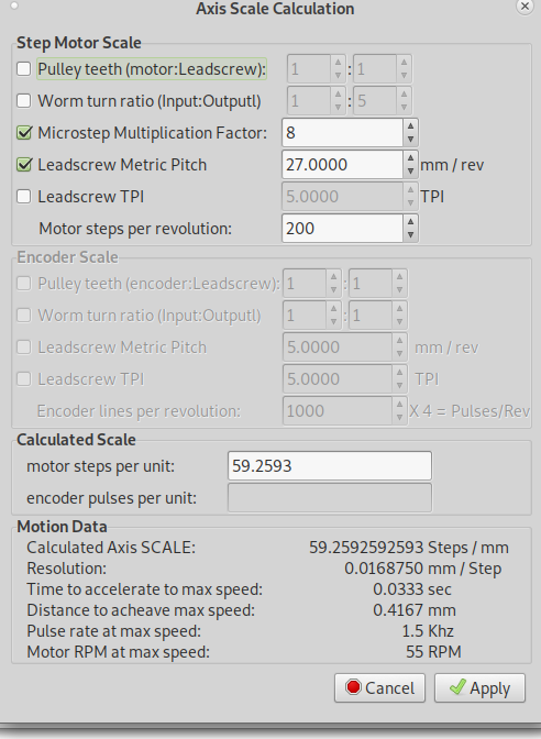

something I also do not understand is :
I have a precision gear on my nema 23 with 5:1 and rack and pinion . the pinion has 25teeth which gives it a travel of 25mm
I even tested and motor 5 revolutions the gear 1
so usually one rev should be 5mm , which is equal to pinion 25mm divided by 5 revolutions makes 1 revolution 5mm
but look which setting I had to do in order to get approx 1mm travel (I got 0.9) when requested 1mm
I tried 5mm but then it travels a big distance (not measured)
I think you are asking about direction of travel reference - it's tool movement.
In Pncconf when on the Axis page, press the help button - it should explain the direction designations.
thank you Chris, that is great!
Last edit: 08 Mar 2020 14:19 by CNCFred.
08 Mar 2020 14:32 #159497 by cmorley
typical motor has 200 basic steps per revolution
8 times microsteps (200 x 8) = 1600 steps per revolution
5:1 reduction gear box: 5 motor turns to one output turn (5 x 1600 = 8000 steps per revolution
1 revolution of 25 tooth pinion = 25mm travel of table
or .04 revolution = 1mm
So 8000 x .04 = 320 steps per mm
If your scale differed from that then it suggests that your assumptions of the mechanics are wrong. My guess would be microsteps setting.
Chris
