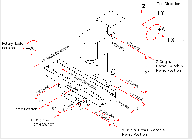

Well Well , thanks again !
on off on on
makes 4 x steps not 8 x Shame on me
www.omc-stepperonline.com/download/DM556T.pdf
I have to try tomorrow ,

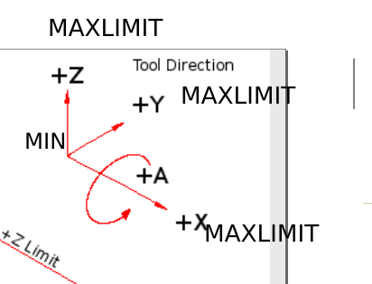

Also had this wrong xmax should be left and Xmin on the right side I used tool max min.
Thank you for PNCCONF!!!
on off on on

08 Mar 2020 14:54 #159501
Replied by cmorley on topic 2 Motors on Y , linuxcnc 2.9 not moving together
Glad it was helpful.
Maybe we should add a router/plasma diagram too
Chris
Chris
