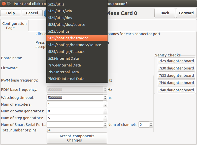

- prochj51
- Posts: 90
22 Mar 2020 05:38 #161082
by prochj51
Replied by prochj51 on topic Motor won't spin, MESA 5i25 + 7i76
Or can I check if linuxcnc actually connects to MESA 5i25?
I have multiple options of selection of 5i25 in PNCCONF, I dont know which one to choose.
I selected the highlighted (see attached pic)
Jiri
Jiri
