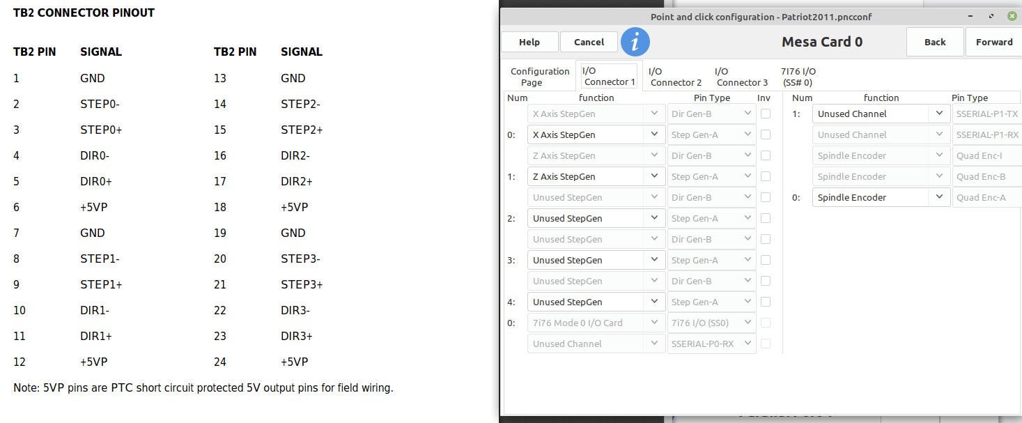

I am moving from a C10 parallel to a 7i76e control. The stepper drive being used is a G203v.
Using the pncconf wizard, I am not understanding the 7i76e TB2 connector pinout, to the (I assume) "I/O connector 1" in pncconf.
The TB2 is wired as follows.
Pin:
In the pncconf tool, what does the Num column represent?
Pin:
- GND -> Chained to the three G203v (XYZ axis) Common
- STEP0- -> G203v Step (X axis)
- Unused
- DIR0- -> G203v DIR (X axis)
- Unused
- Unused
- Unused
- STEP1- -> G203v Step (Y axis Mill/ Z axis Lathe)
- Unused
- DIR01- -> G203v DIR (Y axis Mill/ Z axis Lathe)
- Unused
- Unused
- Unused
- STEP2- -> G203v Step (Z axis)
- Unused
- DIR2- -> G203v DIR (Z axis)
- Unused

Replied by cmorley on topic C10 to 7i76e using pncconf
pncconf uses the component number so in your pic, X stepper in pncconf is number 0.
In the mesa docs you show step0 is pins 2 and 3
Chris
Chris
