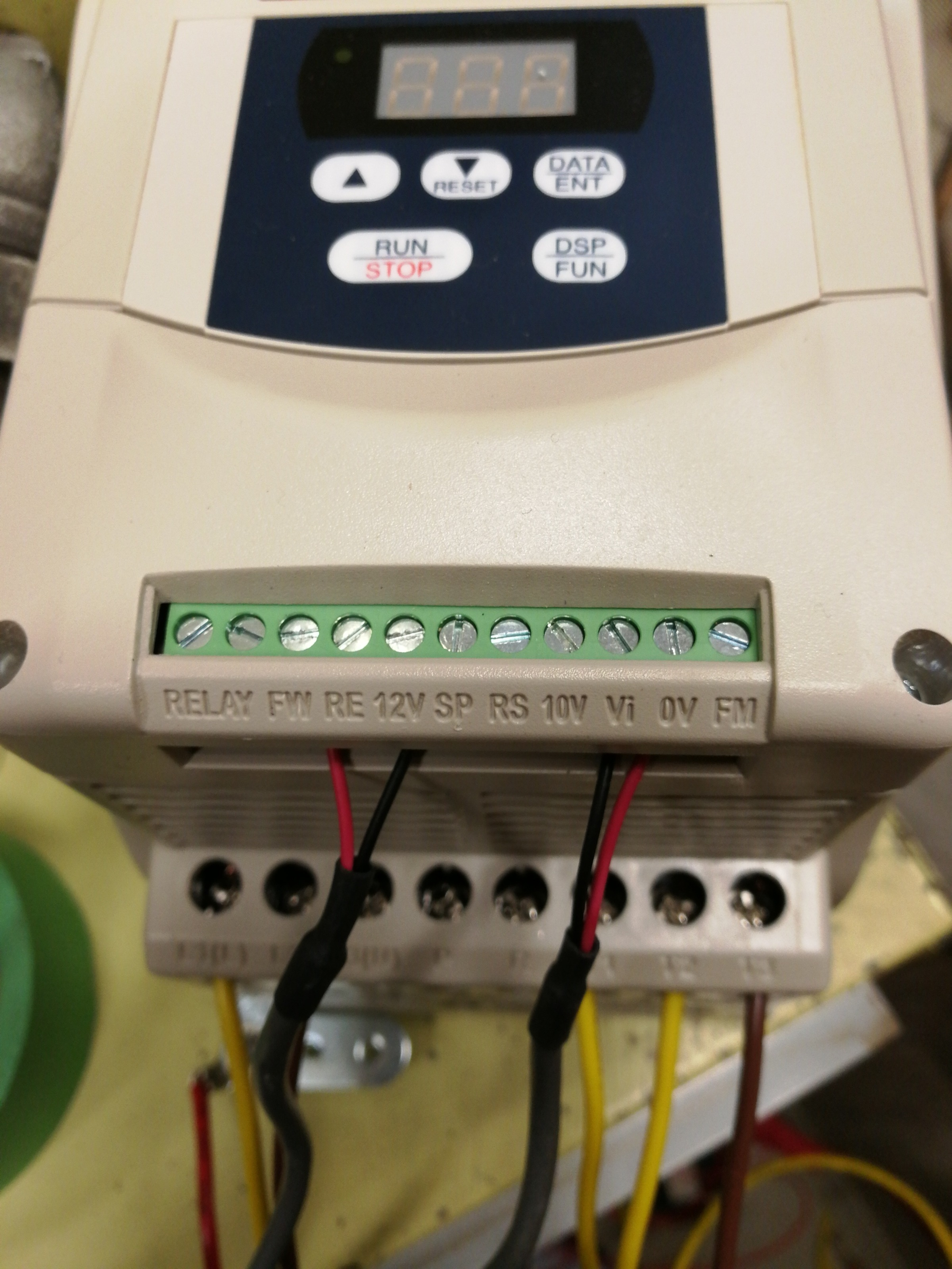

So I wired up my Teco VFD to 7i77
7i77 pin 21 ENA5- -> Inverter 3 (FWD)
7i77 pin 22 ENA5+ -> Inverter 6 (+12V)
7i77 pin 23 GND -> Inverter 10 ( 0V)
7i77 pin 24 AOUT5 -> Inverter 9 (MVI)
And I got the spindle to turn on in Linuxcnc but no reverse and I can't control the spindle speed up and down.
Any suggestions on what I'm doing wrong?
Thanks Mike

17 Apr 2020 18:10 - 17 Apr 2020 18:11 #164353
by Catch22
I'm not getting any volts at all.
Should there be another wire on the VFD? [attachment=25814]15871649155995057958970318230092.jpg
Replied by Catch22 on topic Teco FM50 and Mesa 7i77
1. set spindle on and speed 1/2 of full speed
2. (assuming 10V is full speed) check that you have 5V on AOUT
Last edit: 17 Apr 2020 18:11 by Catch22.
- Posts: 18122
- Thank you received: 5337
17 Apr 2020 18:47 #164357
Replied by PCW on topic Teco FM50 and Mesa 7i77
Is red AOUT5? if so you are shorting the analog out to ground

- Catch22
- Posts: 222
- Thank you received: 17
17 Apr 2020 18:50 #164358
by Catch22
No it's black and goes to vi on the VFD.

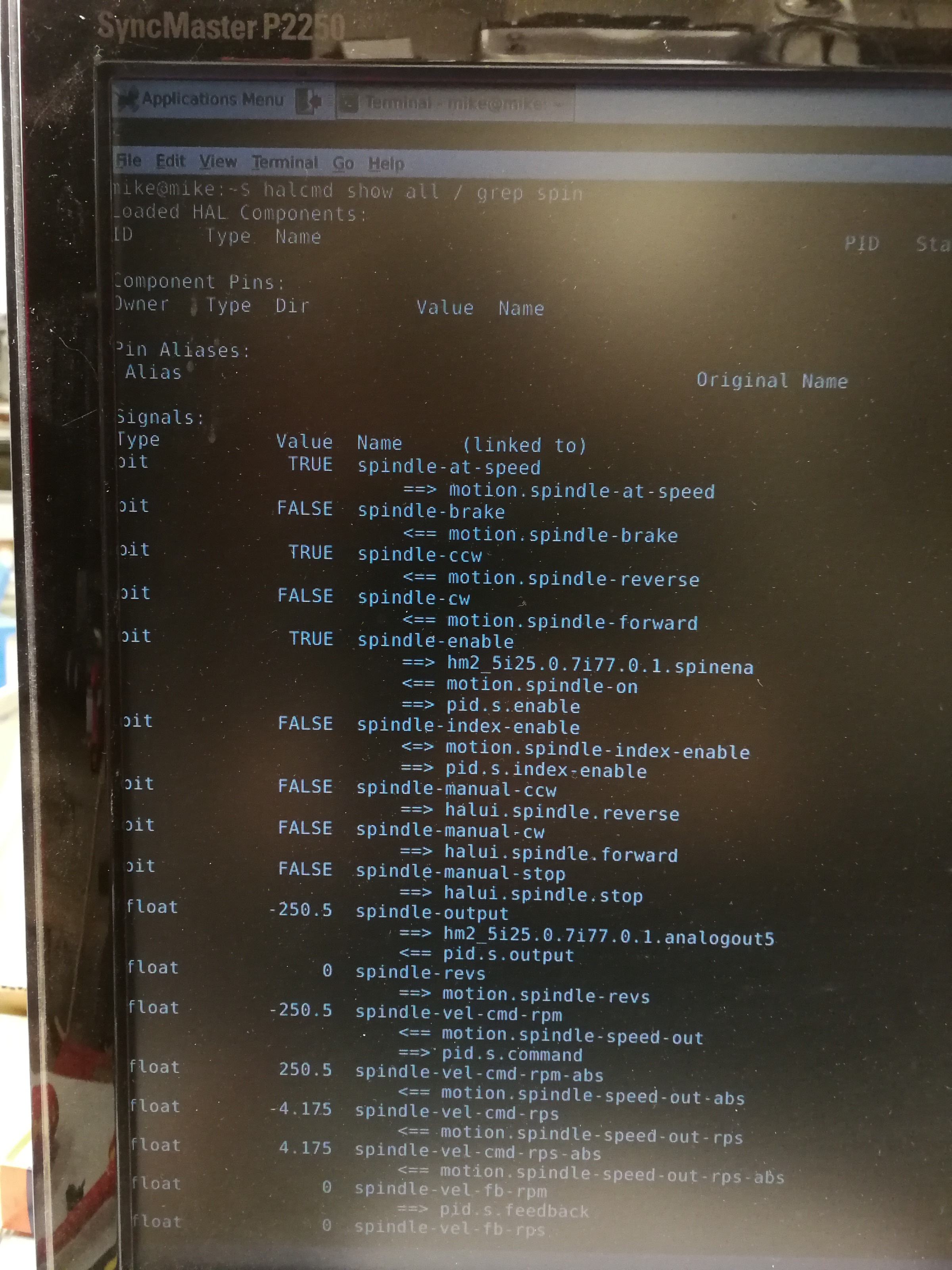

- Posts: 18122
17 Apr 2020 18:59 #164359
Was the spindle enabled?
What was the spindle speed?
When you have LinuxCNC running and the spindle
enabled and set to 1/2 speed can you post the results of
halcmd show all | grep spin
(typed in a terminal window)

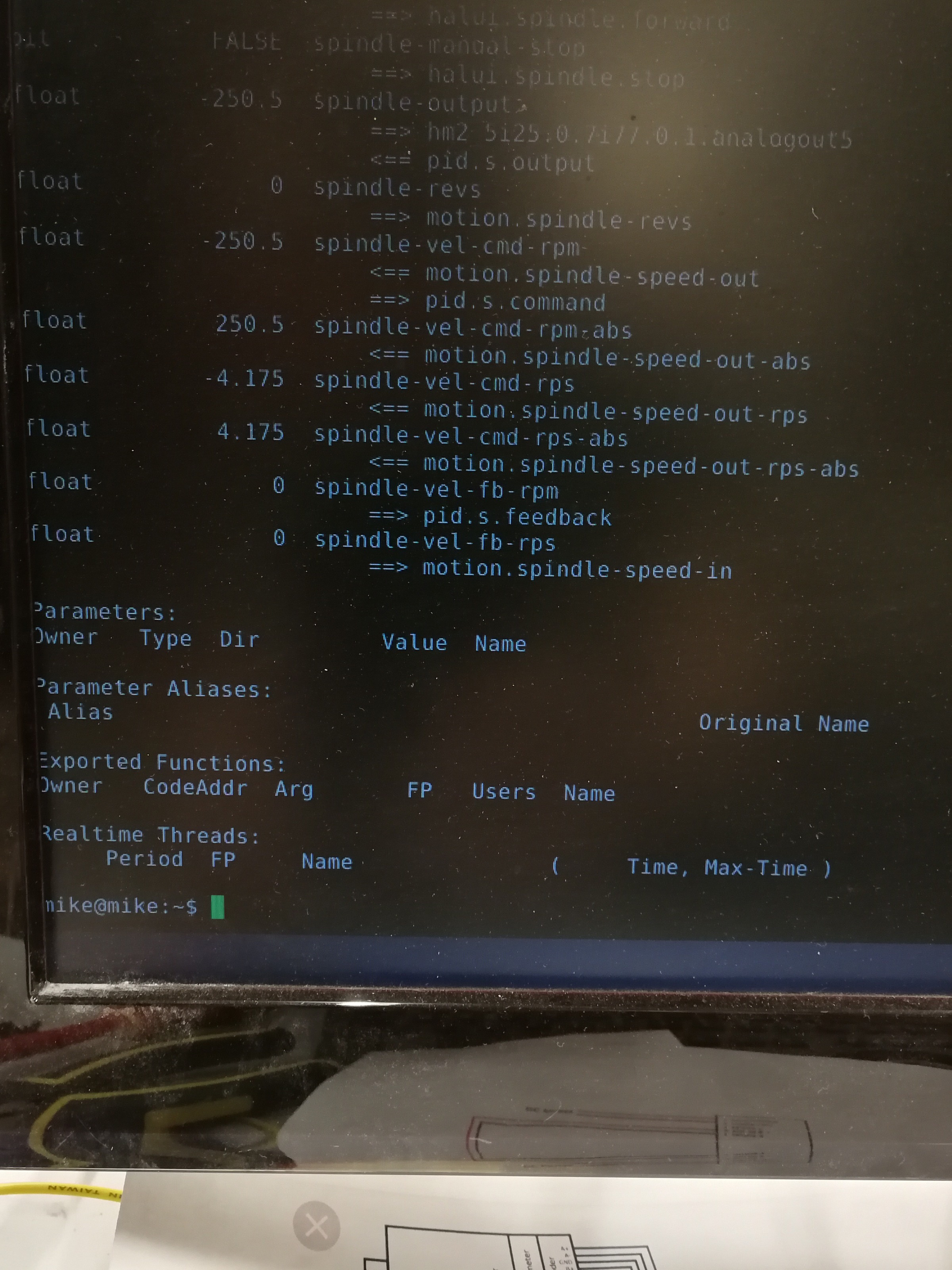

- Catch22
- Posts: 222
17 Apr 2020 19:27 #164362
by Catch22
Ok I started up the spindle and the speed doesn't change until you hit 0% it stops.
I had to take pictures of the Hal file, my internet isn't working in the garage.

- Posts: 18122
17 Apr 2020 19:50 - 17 Apr 2020 19:51 #164372
Notice that you are commanding a negative spindle speed?
This will likely not work with the TECO as it probably expects 0 to 10V
_not_ -10 to +10
So to test further, select a positive spindle speed
If the TECO VFD is 0 to 10V you will need to connect the spindle
to the absolute RPM pin in hal rather than the signed RPM pin
_not_ -10 to +10
