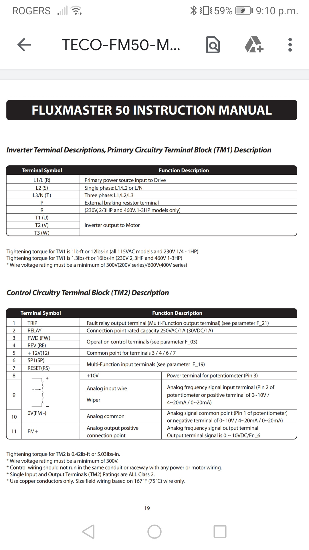

Yes it looks like it's 0-10v so do I select a positive spindle speed in the Pncconfig?
Replied by Catch22 on topic Teco FM50 and Mesa 7i77
Notice that you are commanding a negative spindle speed?
This will likely not work with the TECO as it probably expects 0 to 10V
_not_ -10 to +10
So to test further, select a positive spindle speed
If the TECO VFD is 0 to 10V you will need to connect the spindle
to the absolute RPM pin in hal rather than the signed RPM pin
- Posts: 18122
- Thank you received: 5337
17 Apr 2020 20:23 #164378
Replied by PCW on topic Teco FM50 and Mesa 7i77
For testing just select a clockwise spindle direction:
m3 s1000
in pncconf, uncheck the "Use +- voltage for direction" check box
_BUT_ you may want to make the changes in the hal file so you dont lose any tuning values you have adjusted
m3 s1000
m3 s1000
I tried to add to the HAL file as I found something that it said to do but now i just get an error.
addf scale.0 servo-thread
setp scale.0.gain 0.0027
net spindle-speed-scale motion.spindle-speed-out => scale.0.in

- Posts: 18122
18 Apr 2020 14:26 #164489
You do not need a scale component to scale the spindle output
This is done in pncconf when you setup the spindle or can be done by
editing the spindle section of the INI file
Can you post the spindle section of your INI file here?
The following user(s) said Thank You: Catch22
- Catch22
- Posts: 222
- Thank you received: 17
18 Apr 2020 15:37 #164510
by Catch22
here it is.
Spindle
[SPINDLE_9]
P = 0.0
I = 0.0
D = 0.0
FF0 = 1.0
FF1 = 0.0
FF2 = 0.0
BIAS = 0.0
DEADBAND = 0.0
MAX_OUTPUT = 3600.0
OUTPUT_SCALE = 3600
OUTPUT_MIN_LIMIT = 0
OUTPUT_MAX_LIMIT = 3600

- Posts: 18122
18 Apr 2020 18:16 #164538
Right so that is setup for 3600 RPM at 10V
so is you do a M3 S1800 you should get 5V out of AOUT5
- Catch22
- Posts: 222
18 Apr 2020 18:44 - 18 Apr 2020 18:58 #164542
by Catch22
Ok so I did what you said and got 4v at 1800 and 1v at 900 but the spindle speed doesn't change, it was running at full rpm.
The multimeter I'm using isn't really good and I think the batteries might be getting low so that could factor in on the volts being a bit off.

- Posts: 18122
18 Apr 2020 20:23 #164558
It sounds like the drive is not listening to the analog input.
That's likely a drive a setup issue
- Catch22
- Posts: 222
18 Apr 2020 20:52 #164563
by Catch22
Ok thanks, I will go through the parameters again and see if I missed something.

18 Apr 2020 21:17 #164567
by Catch22
That's what it was, had to change one parameter and it's working.
But reverse still don't work, is this something that has to be added to the HAL file or possibly the INI file?
