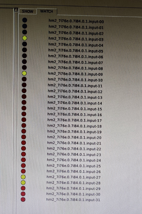

10 Jun 2020 06:55 #170952
by simonmn
Replied by simonmn on topic Help with 7i84 power connections
Done some more testing, but are not really getting anywhere.
Tried to disconnect everything but the ethernet = red, then keep only ethernet and TB1 = red.
Pulled up the hal configuration, and with TB2 and TB3 rows disconnected, I still get some active signals:
Even if I connect everything again, input 3, 27 and 28 are not connected to anything. Could I have fried my board, or do I have a noise issue?
