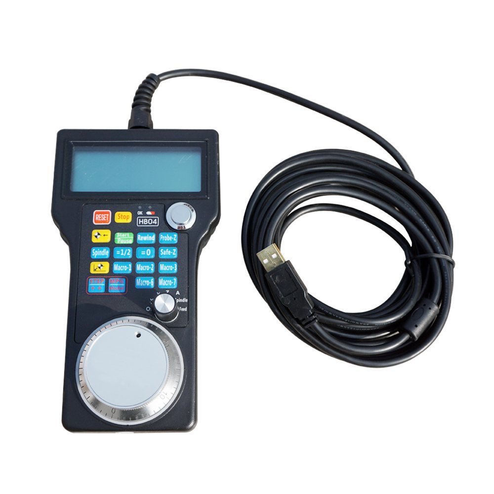

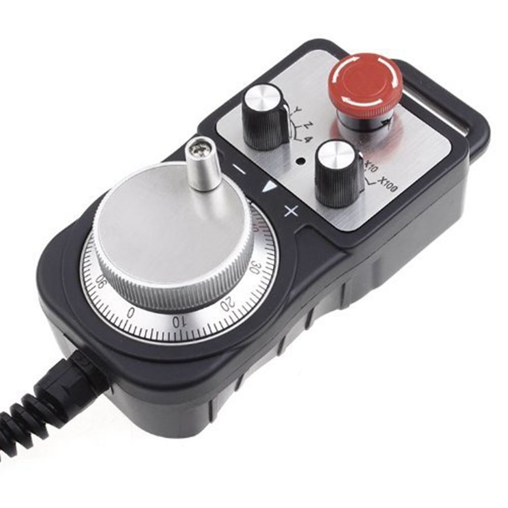

I use a non USB wireless pendant that has a hard wired receiver that uses one of the 7i76e mpg

Sounds interesting. Could you provide some more information on that?I use a non USB wireless pendant that has a hard wired receiver that uses one of the 7i76e mpg

One of these cdxhctech.com/html/eProduct/view_386.html
there are a few options but they do have 7i76e compatible one..
There is some more info about this in my Spaceship plasma build thread.

Replied by rodw on topic Not sure where to ask so, so I'll ask here
You can try this
linuxcnc.org/docs/2.8/html/man/man1/xhc-hb04.1.html

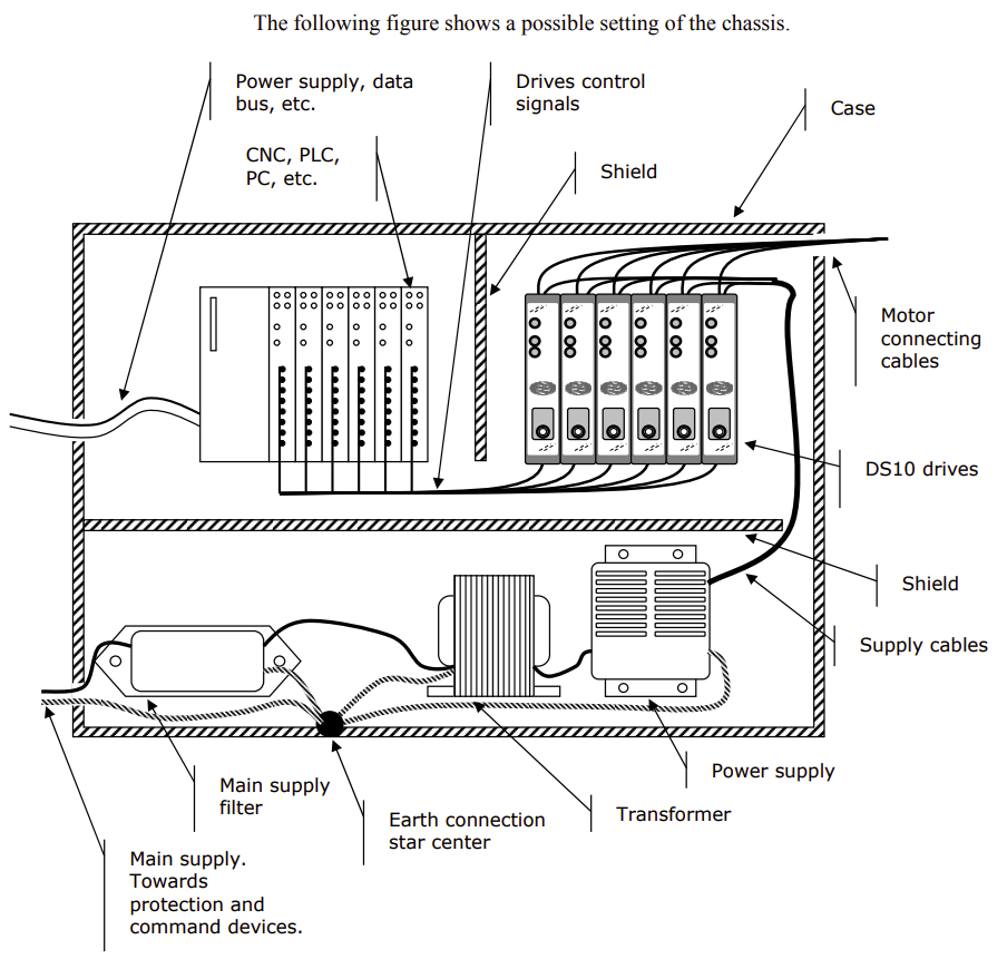

My Mesa 7i76 should be with me tomorrow finally.
Can I fit it in the same enclosure as the stepper drivers and PSU (Toroidal transformer build)?
I'm trying minimize interference, will be driven by a 5i25 via a shielded PP cable and I will ground the PC case chassis and my vfd is going into a grounded PC case all my wiring is CY cable shielding is already grounded.

02 Jul 2020 06:05 #173398
You should be OK. but if you wanted to be sure you could add some metal screen as as per this diagram from the Lam Technologies DS1076 stepper driver manual (but it also was suggesting the wiring based on a 3 phase system so I suspect its overkill
