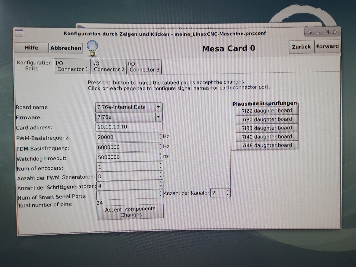

i am very new in the LinuxCNC world so maybe i am missing something here but when i use pncconf wizard to create my config
i can't see the SS I/O tab on the configuration page.
W1 is left and w8 is left aswell.
i have 24v connected to VIN/GND and to tb3 22 , 23
What am i doing wrong ?

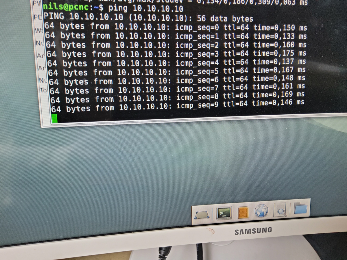

i can sucessfully ping my card.

Pncconf does not depend on accessing the 7I76e, (unless you run the test panels)
so the tabs are there even if the 7I76E is not connected.
The SS channel setup is in the "I/O connector 1" tab

could you try running pncconf with english language - I wonder if that is the problem.
Also what version of linuxcnc are you using?

I am using LinuxCNC 2.8
i think i might have figured it out.
As PCW mentioned i was able to choose the SS channel setup in the connector 1 tab and now the ss tab is visible.

I had the same issue with German locale. Switching to English (via LANG=C pncconf in the terminal) made the tab to appear.
