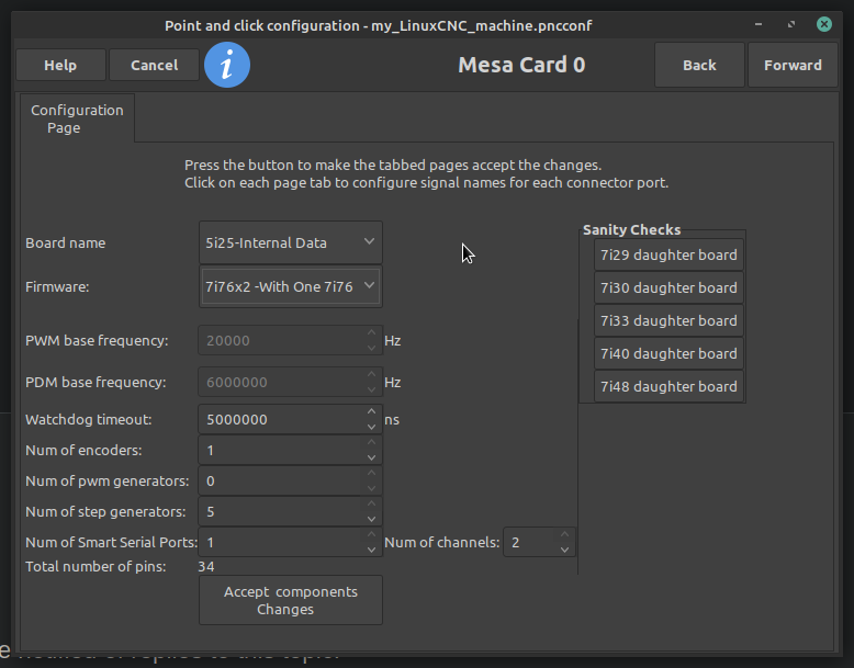

06 Jul 2020 07:30 - 06 Jul 2020 07:36 #173753
by Fasteagle102
Replied by Fasteagle102 on topic 5i25/7i76 beginner issues
Thanks again for all the help Tommylight, BTW is there any particular supplied configuration choice I should choose in the wizard ?
There are so many choices and no one in particular stands out to me.

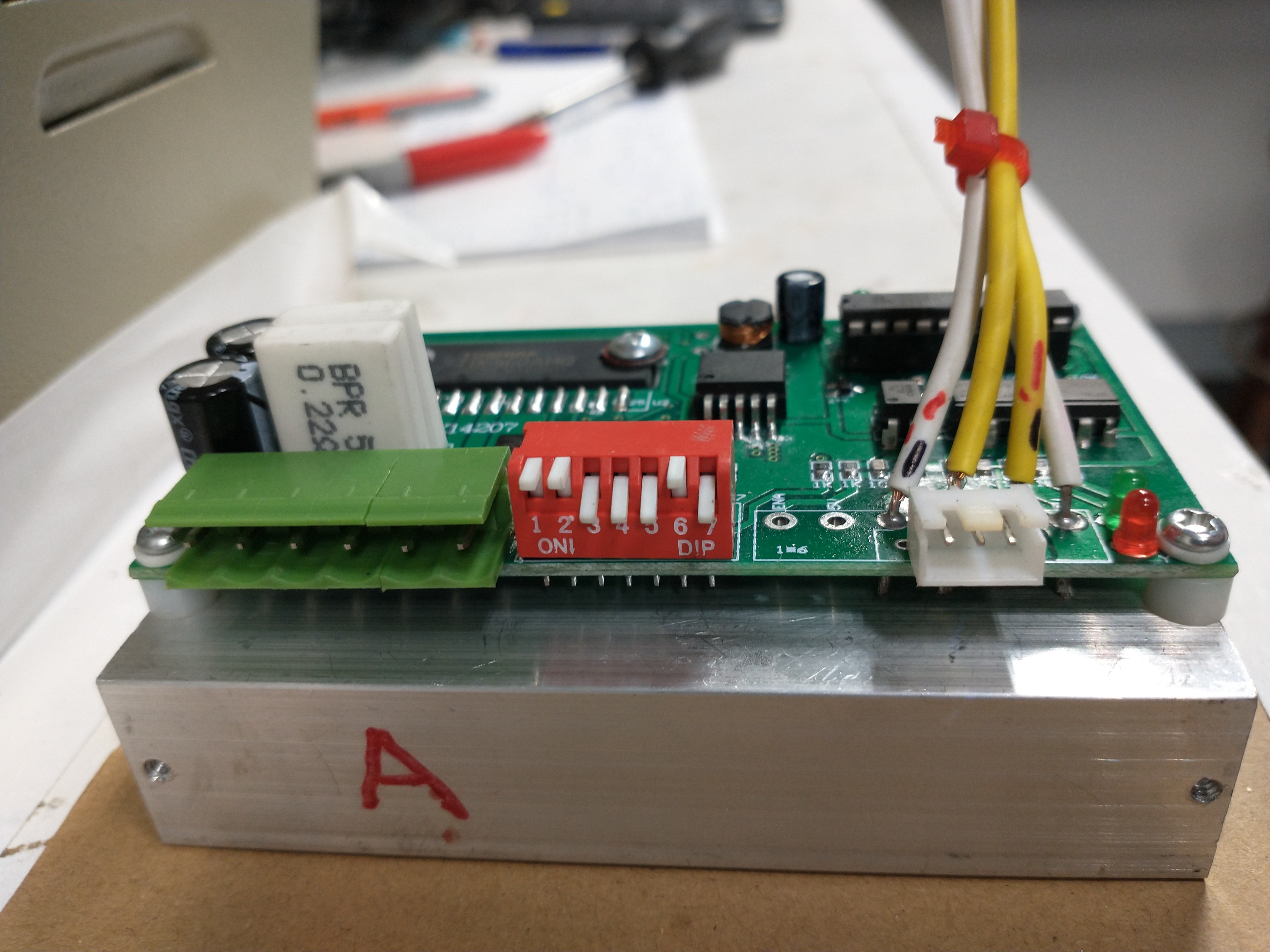

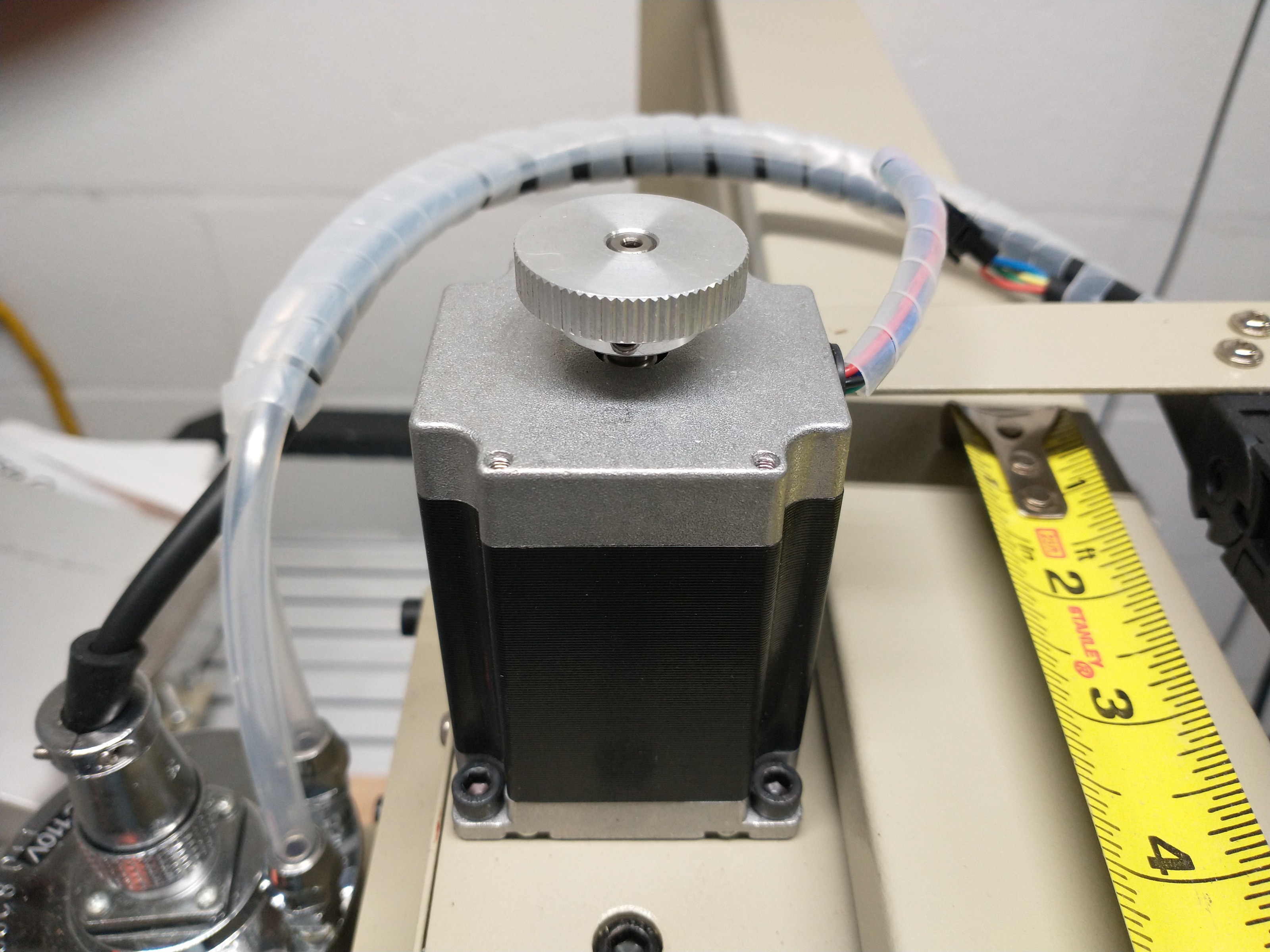

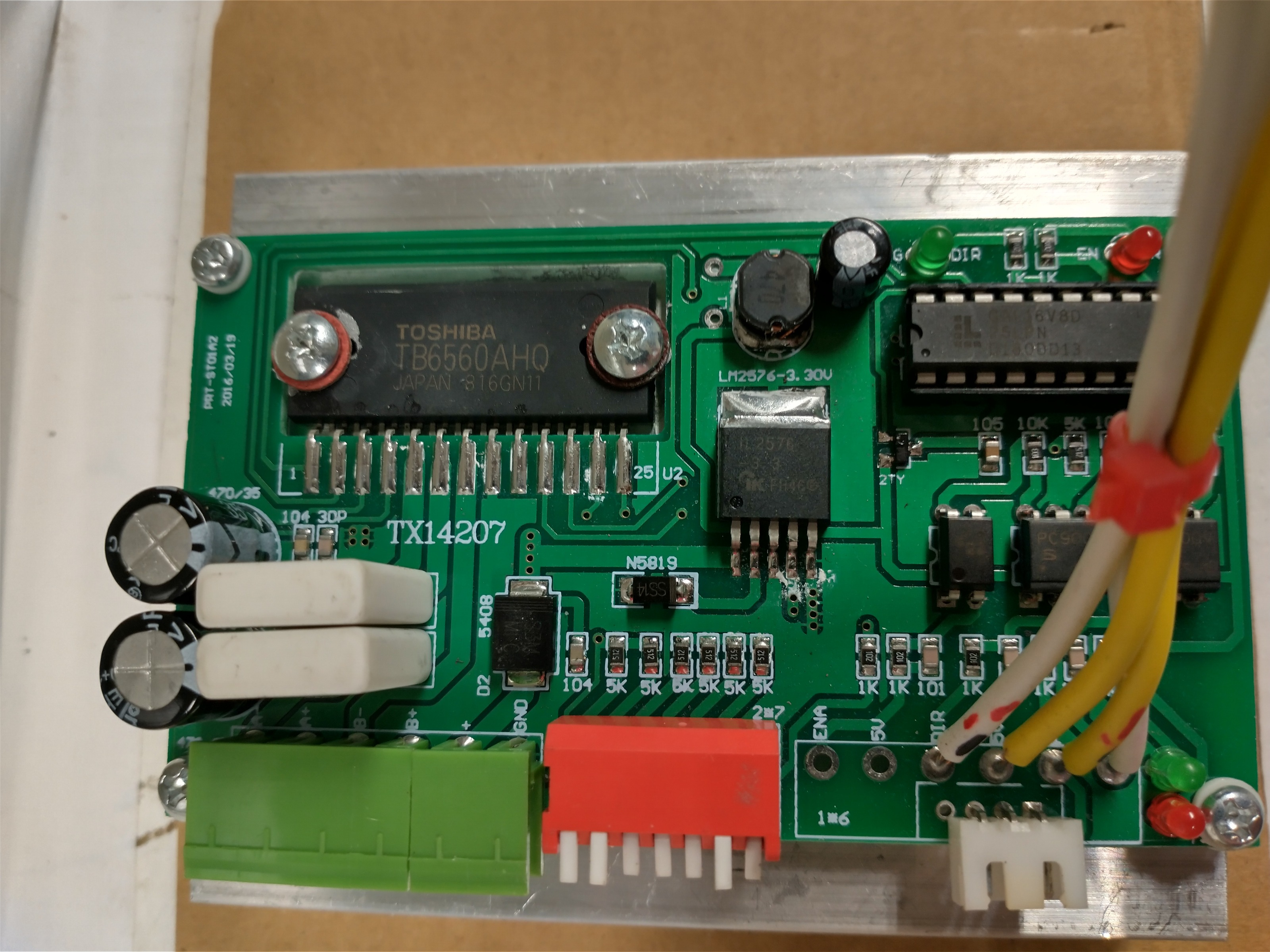

- Fasteagle102
- Posts: 9
09 Jul 2020 11:14 #174104
by Fasteagle102
Sorry for the delay, here are the pics of the driver and motor. Please let me know if you need more detail.
It appears the x motor is working back and forth, but just needs calibration, the y and z motor only in one direction and A motor gets an error message. I'm thinking the dip switch positions need to match the rest. Do you agree ?
Also, the changes on the step time and space and direction didn't have any change to the sound or speed of the x motor or any other ones as well. Is it supposed to ?
BTW, the wiring as you can see in the pic are two whites and two yellows, I have them terminating on the 7i76 card to the relative 5v signals and step and direction signal. I will double check them again. Each driver has a 5 volt signal for both the step and direction, can they be crossed and still work ok ? It's just hard to get a picture of that detail.
Thanks again !
Thanks again !

09 Jul 2020 11:36 #174108
Replied by tommylight on topic 5i25/7i76 beginner issues
No pictures.
