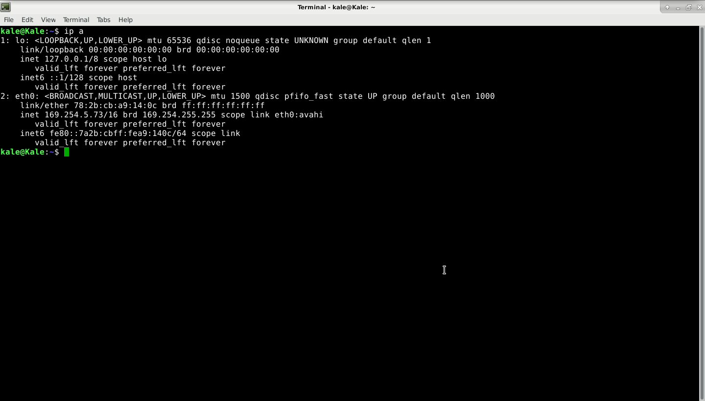

I'm in linuxcnc 2.8 setting up a 7i96. I followed this tutorial: forum.linuxcnc.org/27-driver-boards/3559...ethernet-mesa-boards
when I try to launch my PlasmaC config I get an error reading:
ERROR: Failed to execute '/sbin/sysctl -q net.ipv6.conf.eth0:avahi.disable_ipv6=1
in the debug info it states:
sysctl: cannot stat /proc/sys/net/ipv6/conf/eth0:avahi/disable_ipv6: No such file or directory
I can ping 10.10.10.10 successfully and my base machine opens fine.
I've been trying for a while to narrow down the problem. Any help would be greatly appreciated.

What does
ip a
print?
ip a
print?

09 Jul 2020 21:13 #174172
by KaleD
Replied by KaleD on topic Mesa connection issue
- Posts: 18122
- Thank you received: 5337
09 Jul 2020 21:18 - 09 Jul 2020 21:19 #174173
Replied by PCW on topic Mesa connection issue
Right, so you have not setup a static IP address for the host.
Take a look an the hm2_eth manual page for how to do this in the interfaces file

Yes, you can also use the GUI to set up a static IP address on the host
(10.10.10.100 suggested)

09 Jul 2020 21:29 #174177
by KaleD
I can't save the interfaces file with the changes. I'm using mousepad.

you need to be root to edit most system files
so
sudo mousepad

09 Jul 2020 22:08 - 09 Jul 2020 22:09 #174180
by KaleD
Ok, thanks. I'm only a few months old as a linux user. I made the interfaces file changes.
I now get an error stating that the network is unreachable.
