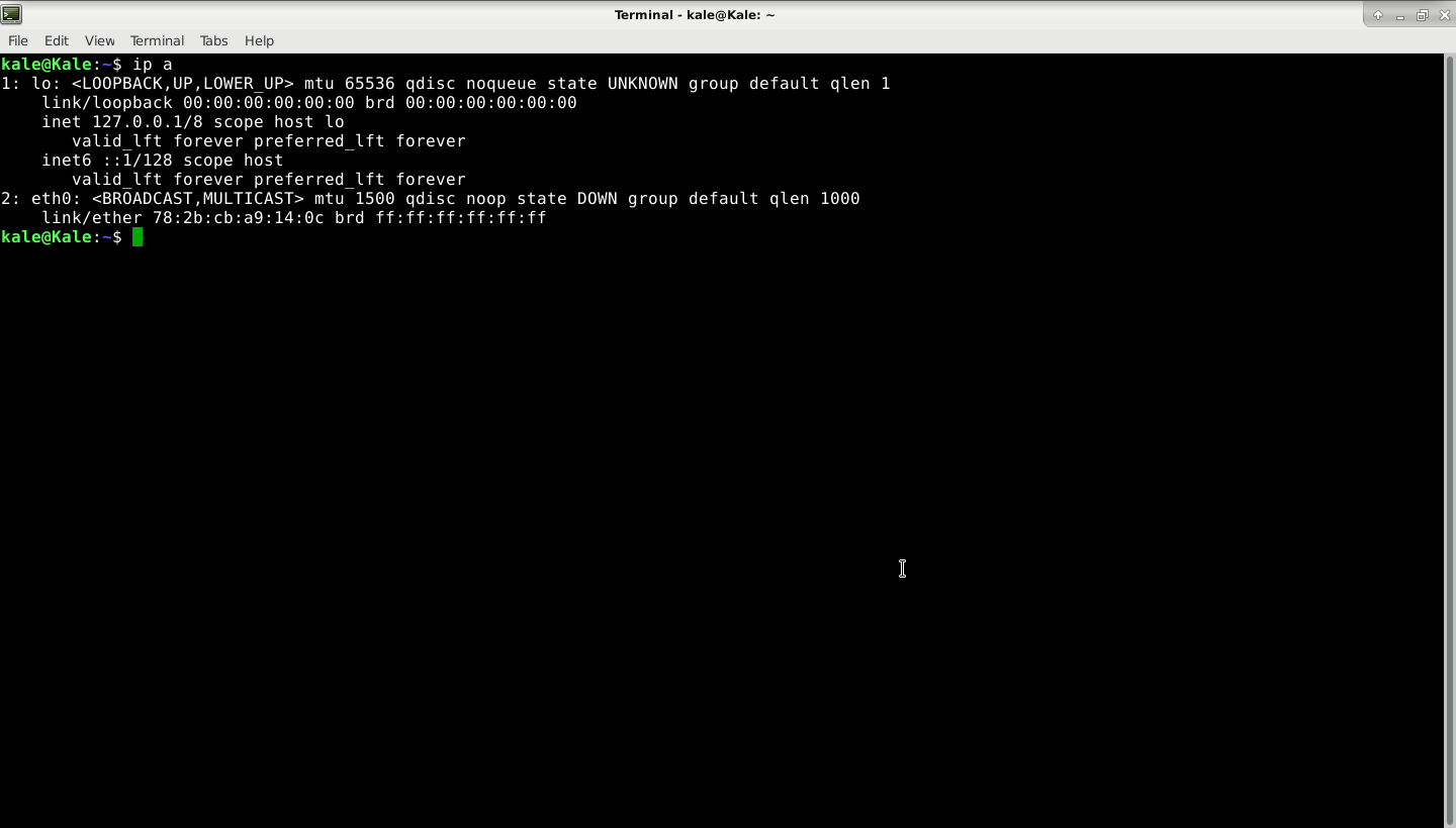

10 Jul 2020 10:09 #174217
Replied by PCW on topic Mesa connection issue
OK that looks right
Can you reboot and run the ip a command?

10 Jul 2020 10:29 #174220
The link shows as DOWN, is it connected?

10 Jul 2020 10:31 #174221
by KaleD
I'm not sure what you mean.
Replied by KaleD on topic Mesa connection issue

10 Jul 2020 10:32 #174222
No link

10 Jul 2020 10:33 #174223
by KaleD
The 7i96 is physically connected to the ethernet port of the computer
- Posts: 18122
- Thank you received: 5337
10 Jul 2020 10:36 #174224
And powered?
Does if have link lights?

10 Jul 2020 10:39 #174225
by KaleD
cr2, cr3 are lit up
pwr is lit
I'm powering from a usb on the computer.
pwr is lit

10 Jul 2020 10:43 #174226
The link lights are on the 7I96's Ethernet connector
If the interface is DOWN the settings in the interfaces file will not be applied
Why its down, I do not know, you might make sure you backed out any changes
you made to the setup file
