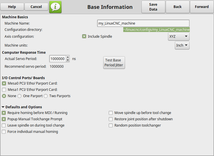

12 Jul 2020 03:07 - 12 Jul 2020 03:11 #174361 by Reinhard
Replied by Reinhard on topic Errors on mesa-card selection
Hi Chris,
thank you for your fast reaction!
I refreshed repository, but I don't get a save button.
... and my window looks quite different than yours.
What desktop are you using?
Axis was translated in the INI or just on the pncconf page?
In pncconf - page "Screen" in the "GUI Screen list"-combobox.
May be, you could add the save option to the window-closing dialog, when hitting the cross icon from titlebar to close application. That's the only way out, so may be good place?
cheers Reinhard

12 Jul 2020 03:22 #174362 by cmorley
Replied by cmorley on topic Errors on mesa-card selection
Yes looks like the buildbot is stuck..so no new updates till fixed.
I use Mint 13
I couldn't figure out how to get it to not translate.
Yes that could be handy to save before quit too.

13 Jul 2020 00:42 #174458 by cmorley
Ahh I assumed you were using a installed version... yes some python needs 'compiled', which I think actually just moves them.
mint 13 with cinnamon; probably cinnamon is possible in other distributions.
Thanks I fixed the translation problem with your instructions.
I changed the save data button to the quit dialog and improved the quit dialog's messages
Chris
