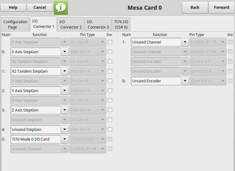

Replied by Aldenflorio on topic 2 motors on one axis
How do I configure two motors to work together on one axis? I’m using Linuxcnc 2.9

-If you used pncconf to create the config, use it again to edit an existing config, choose that config then at the stepgen page select one drive/motor as the main axis and the other as the tandem axis.
That will set everything for you, the only thing left to check is if the two motors are working together by going in the same direction. If not, open the calibration from the machine menu in AXIS GUI and add - to scale of the motor that is going in the wrong direction.

When I do that the other motor just doesn’t move at all. I know it works bc if I press 2 then i can control it with the - and + button

Sounds like you are jogging in joint mode.
Do you see numbers or letter on (I assume you are using) AXIS's display?
Did you set up homing?

Also please post you config files

You need to home that machine first, then jog.
Do you have home switches on the machine?
