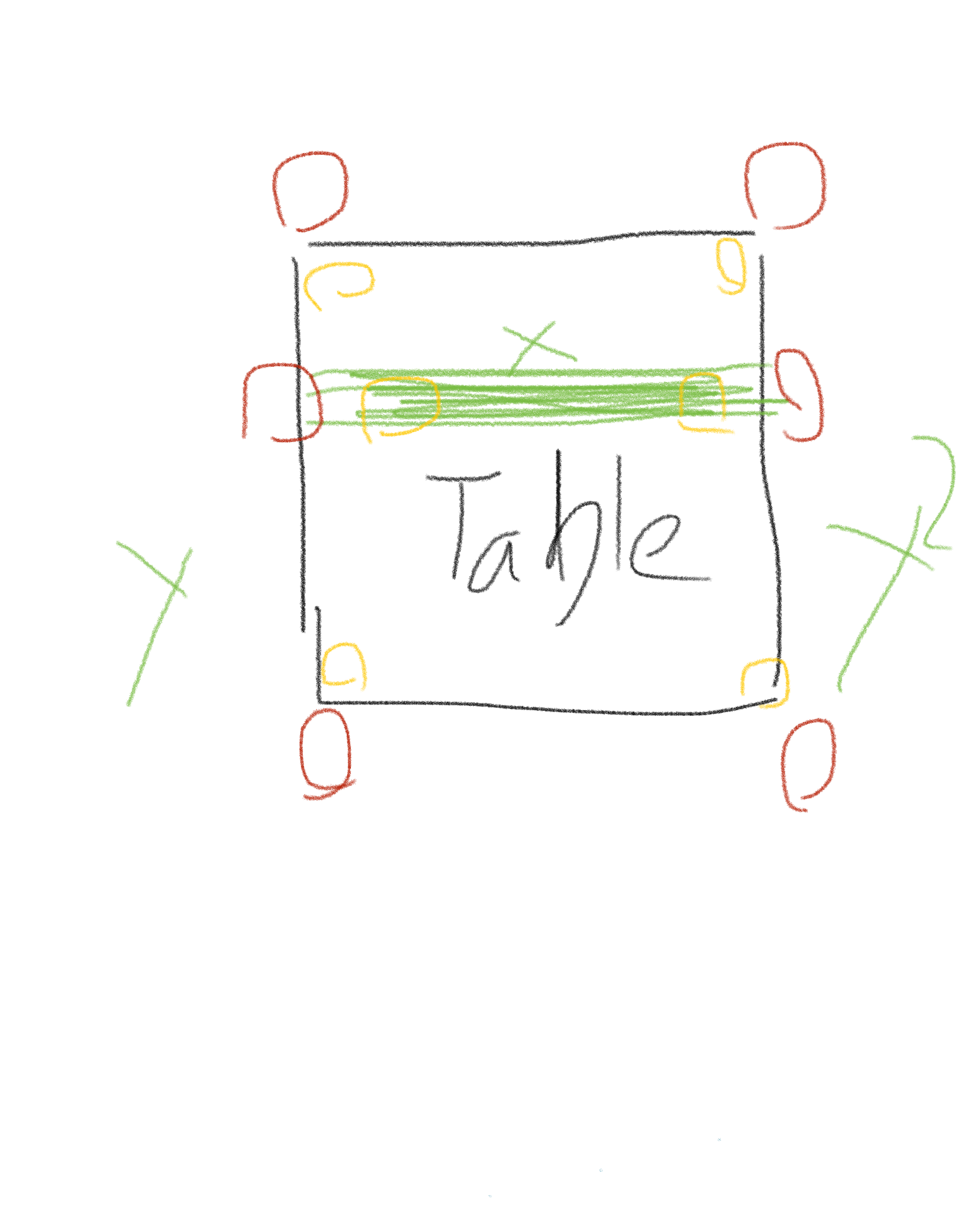

15 Aug 2020 02:13 - 15 Aug 2020 02:13 #178239 by Aldenflorio
Replied by Aldenflorio on topic 2 motors on one axis
Sorry I wrote this kinda weird. I started from the bottom so it might make more sense to read from the bottom up.
Home search velocity: ok, thank you
Home latch velocity: ok so this sounds like what I though offset was. If I read it right then this tells it the direction and speed that it travels once it hits the switch
Home final velocity: understood, thank you
Home ignore limits: So does that mean that it won’t stop if it trips the switches? I guess this one still confuses me
Home offset: ok I’m moving from the bottom up so I addressed this farther down. I thought I was using my switches to home the machine and then this would tell it to move a bit away once it trips the switches. But from what you wrote it sounds like this is only to square an out of square gantry.
Home: ok, thank you
Home is shared: I’m not sure if I’m properly addressing what you said but hopefully I am. I have 7 limit switches total (or whatever they are called, they’re linked below) four for the y axis, two for the x axis, and one for the floating head on the z axis. I thought I was going to have it home based one when it tripped those switches bc in my mind that’s more accurate. I think this pertains to that.
Home sequence: ok so I want z first, then x, then y. Y is two motors so I would have z=0, x=1, y=2, yt=-2 (or is that 2 again?)
Immediate home: ok I have what I believe are switches linked bellow.
usa.banggood.com/5pcs-AC-250V-5A-Adjusta...der&cur_warehouse=CN
www.amazon.com/gp/product/B07BL33XXT/ref...07_s01?ie=UTF8&psc=1
Thank you very much for the much needed clarifications. Also I apologize for my ignorance in this subject.
Last edit: 15 Aug 2020 02:13 by Aldenflorio.

15 Aug 2020 02:58 - 15 Aug 2020 03:14 #178245 by Clive S
Replied by Clive S on topic 2 motors on one axis
Ok
Ok Home and limit switches are two different things. The above means that when it is in the homing state the switches will be treated as a home switch but when IT IS homed then it becomes a limit switch. The idea is that you don't need a limit switch at this end.
If you want to have a separate limit switch then you would not set the home switch as shared.
thHome is shared: I’m not sure if I’m properly addressing what you said but hopefully I am. I have 7 limit switches total (or whatever they are called, they’re linked below) four for the y axis, two for the x axis, and one for the floating head on the z axis. I thought I was going to have it home based one when it tripped those switches bc in my mind that’s more accurate. I think this pertains toat.
The ONLY switches that are used when homing are the home switches ie. one at the top of Z . One of the X and two on the Y .The floating head etc are not use for this purpose
The Y tandem axis HAS TO HAVE the same -ve number ie Y1=-2 Y2=-2
Last edit: 15 Aug 2020 03:14 by Clive S.
