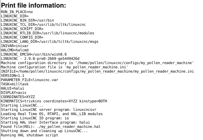

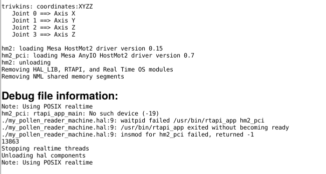

As I don't have the mesa card with me, I would like to create a virtual machine to just see how it works with the 4 XYZZ axis and the whb04 pendant. I would like to know how to do it. I did the pncconfig and I am attaching the ''hal'' and ''ini'' file to this message. And when I launch the file after the pnc configuration, I get the following error message put in attachment.
