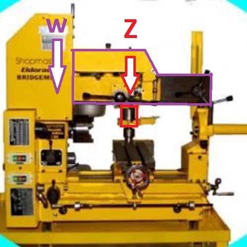

Hello all,
I am trying to set up my first CNC machine. I don't have a background in linux/software/computers but this forum has been quite helpful! I feel I have gotten very close to finishing, but I've hit a wall and need a little help getting to the finish line. I have gotten to the point of creating a set of files using pncconf, but am experiencing errors and would like some help. There's a chance my error's may not be with pncconf specifically, but I think this is the best fitting subforum to ask my current questions.
Software: I am running - linuxcnc-stretch-uspace-amd64-r13.iso - ( www.linuxcnc.org/testing-stretch-rtpreempt/ ).
PC Hardware : Dell Optiplex 760, not connected to the internet
Machine: Eldorado bridgemill + lathe
Driver: Mesa 7i76e
Axes:
X-axis: Closed loop Nema 34 - belt drive - ball screw
Y-axis: Closed loop Nema 34 - belt drive - ball screw
Z-axis (quill): Closed loop Nema 34 - belt drive - quill
W-axis (bridge): Closed loop Nema 34 - belt drive - ball screw
The W-axis is in series with the Z-axis, but (currently) requires a manual unlocking/locking step before/after each movement. The manual lock provides a little extra rigidity, which this machine could very much use. I would like to automate the lock/unlock at some point in the future.
Spindles:
Lathe: Belt driven - 1hp 3ph 240VAC motor - VFD (lathe)
Mill: Belt driven - 1hp 3ph 240VAC motor - VFD (mill)
[planned addition] Router: 6 discrete speeds - quill mounted.
Progress at the time of this post:
I have installed the above flavor of linux, I can ping the MESA 7i76 (thanks to tommylight's mesa ethernet sticky!),and I completed the pncconf.
Problems at the time of this post:
[Resolved: Requires at least version 2.8
1. I could not figure out how to program a 4th axis that is series colinear with the Z axis. There is an "A" axis option, and I have found some posts about gantry-type machines using parallel colinear axes, but I don't think either of those are what I am trying to accomplish.
Resolved: While possible, I have opted for a change in workflow resulting in seperate configuration files.
2. I could not figure out how to program this as a mill and a lathe. I only foresee running the machine as a mill or as a lathe for any one set-up. Should I create a separate lathe configuration and mill configuration and launch the correct configuration given the planned set-up?
Resolved: I will control the second VFD from a USB-to-RS485 as it is a cleaner solution.
2b. I have two VFD's (one for the mill and one for the lathe). The MESA 7i76e card handles one spindle very well using the pins of TB4. I would like guidance on the best way to expand this. My current approach is to wire each Spindle - pin to both VFD's with the exception of the enable pin. I would then wire the TB4 Spindle enable - to go to one VFD (mill for example) and then use a GPIO output to enable/disable the other VFD (lathe). I believe the VFD is expecting 0-10VDC and needs to be pulled low to turn on (It does not turn on as a floating/NC output). Could an output pin be set to either low/float instead of low/high? I worry that 24VDC may damage my VFD. Is there a better way to accomplish this goal?]
3. (I apologise if I'm stating the obvious, but I'm just not familiar with what is available.) My closed loop stepper motor drivers do not report actual position to the MESA board, only a PEND signal if the motor is in the correct location within some negligible tolerance (I think?) and an alarm if position syncing is lost or there is a power-related problem. I do not have nor do I currently plan on installing glass slides (or the equivalent). I think I want linuxcnc to know if one of the stepper drivers alarms out, but I don't think I need the PEND signal. I wired the ALARM + of each axis (joint?) to an input in TB5, but I couldn't find an option for axis specific alarm in pncconf. Should I put them all to E-STOP?
4. I would like to be able to enable/disable the drivers. I wired each axis' EN + to an output in TB6, but I couldn't find an option for axis specific enable. Is it "enable [axis] amplifier"?
[Resolved: The solution was to adjust the generated .hal file's ip address to match the non-default jumper settings on my MESA 7i76e. I had set W3 to "up" which results in a static IP address of 10.10.10.10 . The as-generated .hal file indicated 192.168.1.121 .
5. I tried to test my stepper motors while configuring, but I received an error (attached). How do I resolve this?

Replied by PCW on topic Requesting Help Setting Up First Machine - Mesa 7i76e
hm2_eth: ERROR: 192.168.1.121: Could not retrieve mac address
Means there is no communication with the 7I76e
What does
ip a
report?
And is the 7I76E jumpered for 192.168.1.121 or 10.10.10.10?
For gantry support, you would need to upgrade to LinuxCNC 2.8
What does
ip a
report?

Replied by tommylight on topic Requesting Help Setting Up First Machine - Mesa 7i76e
1 set the A axis in pncconf, then edit the hal and ini files to W axis.
2 the easiest way is the one you describe, make two separate configs. The harder way would be to have a single config that controls everything and capable of switching as needed during work. Doable, requires some editing of config files, not easy.
2b wiring two VFD analogue inputs is not wise, they might be at different potentials and cause damage to one or both. Use the 7i76E spindle control for one VFD and use a USB to RS485 dongle for the second one, if any of them have an RS485 connection. Wiring digital start signals is easy just use different outputs for them ( again separate for each VFD), but this would not be required for RS485 control.
3 you can use the X-enable or joint-x-enable (can not recall exactly) for the alarms for each axis and also use the message component to show what axis faulted. A bit fuzzy on this, sorry.
4 you can have them all wired to axis-x-enable in hal and that outputed to hm2-7i76e-pin number where the drive enable is physically connected.
5 never mind that, you can use "calibration" from the machine menu in Axis GUI.
6 already replied by PCW
7 no idea, never used them.
