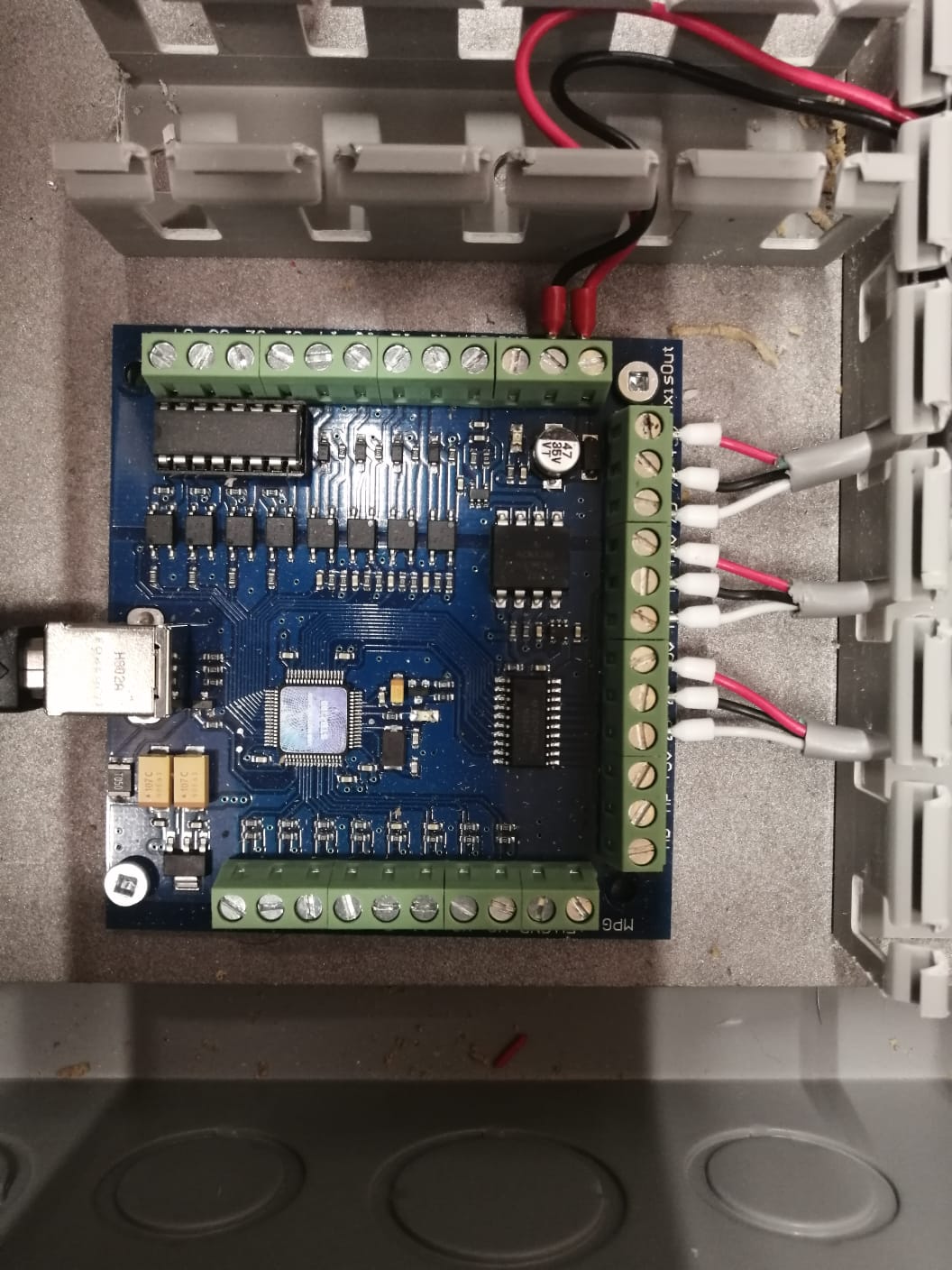

I am confused, that is a Mach3 control board so chances are it will not work with LinuxCNC.
LinuxCNC compatible boards with ethernet are made by Mesa, there are several types of them, like 7i92 (similar to what you have), 7i96, 7i76E, etc.
Maybe there are other boards that do work with LinuxCNC through ethernet, but i am not aware of them.
Did you test that setup with Mach3?

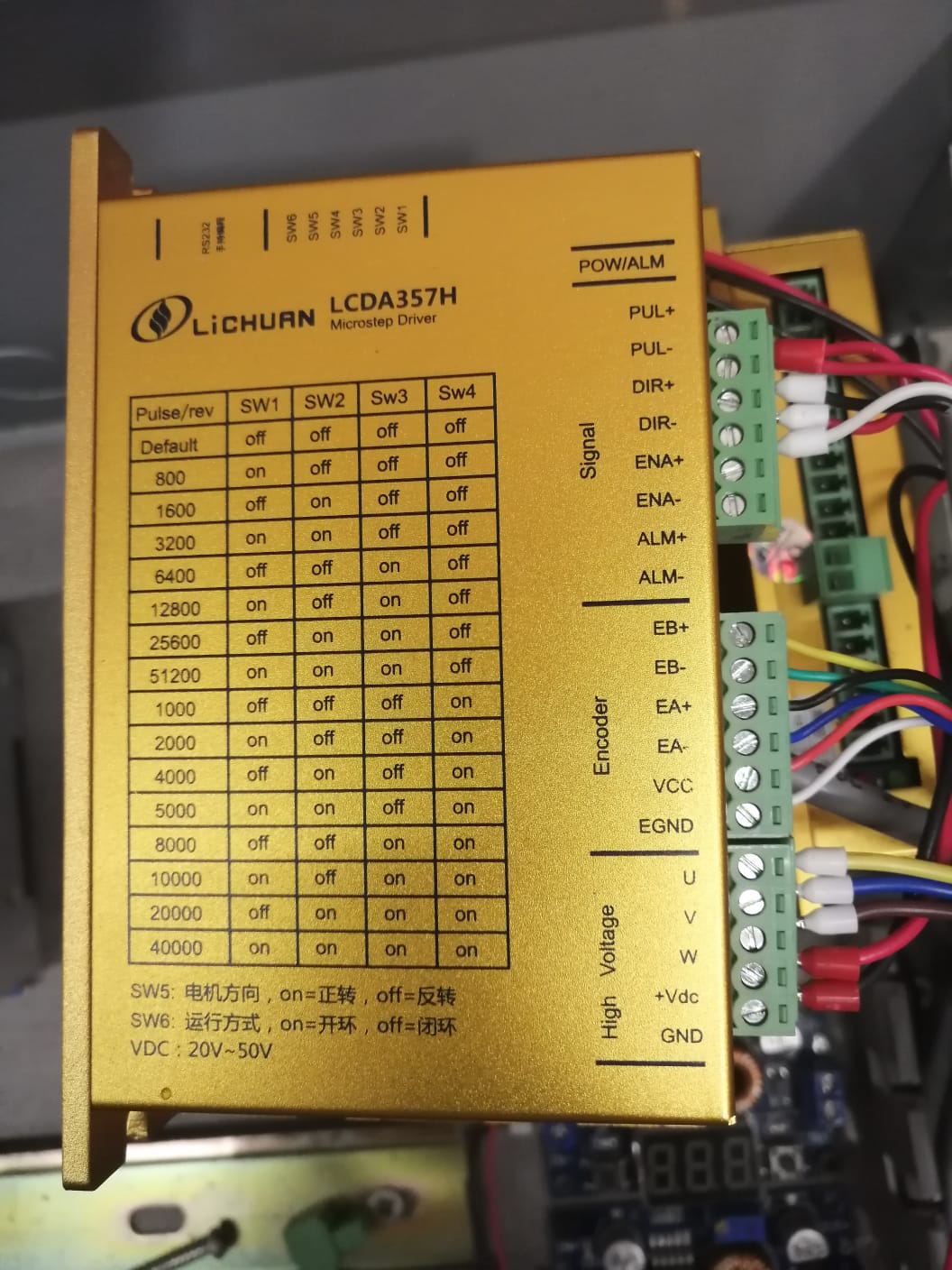

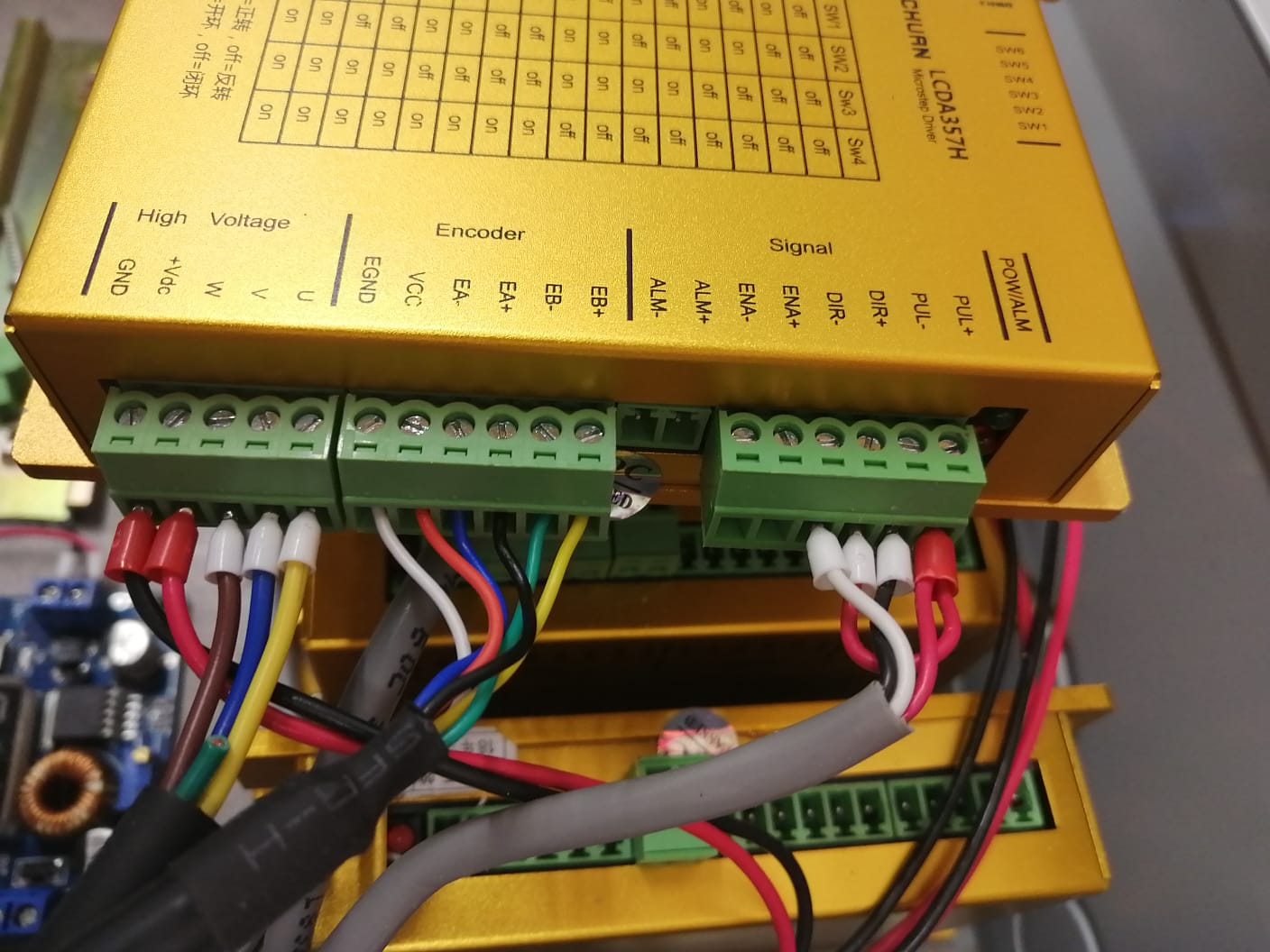

my problem is the same of the other guys.
when i tray to move the stepper in close loop the driver send a alarm (3 flash)
i know this is a Linux forum.
But here is the only forum who have the answer i am looking for.
i don't know if the problem is the encoder wiring????or something more.
i really appreciate if you can help my to solve the problem.

That sounds like incorrect wiring of the encoder or motor wires are set for reverse spinning, so try swapping just 2 of the motor wires.when i tray to move the stepper in close loop the driver send a alarm (3 flash)

You are right tommylight.
That was the problem..............Now everything is OK.
Thank for your Help..... I didn't realize the direction was the problem...... Now i can continue with my project

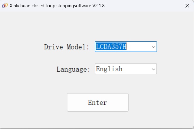

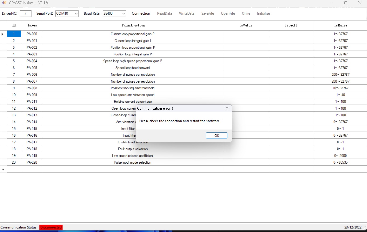

Anyone has a successfull connection with PC to setup encoder and maximum current? I can run this driver in open loop mode, but my servo take 2.1A @ 24V in holding mode and is inredible hot. I played with all bound rate and DriverNO without success. The same rs232 cabel I use with Ledshine controller and all work fine. I use LA052-040E 24V servo.
