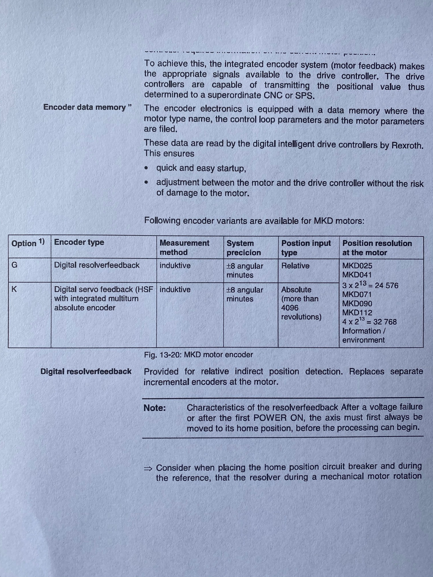

I'm in the process of configuring the servos on my 3 axis router but I need to control them before progressing to Tommylight's servo tuning tutorial.
The machine has Indramat motors:
MKD 071 on the X (resolver feedback, not absolute)
MKD 041 on the Y and Z (resolver feedback, not absolute)
I've been able to scale them so when I move each axis by hand the distance corresponds with the DRO. The trouble is I'm unsure what to use for the encoder scaling in PncConf. Encoder lines per revolution and encoder pulses per unit.
They jog around ok in the open loop test.
The attached image is an extract from the link below (page 130).
www.magnaproducts.com/wp-content/uploads...anual_compressed.pdf
Thanks as always
Peter

27 Oct 2020 23:23 #187495
Replied by cmorley on topic Motor encoder scaling
What did you use for scale setting to get the DRO to read right?
If you have figured out scaling even by hand you can enter that number in pncconf.
You don't need to 'calculate scale' - that's just for convenience.
The scaling should be in pules per unit.

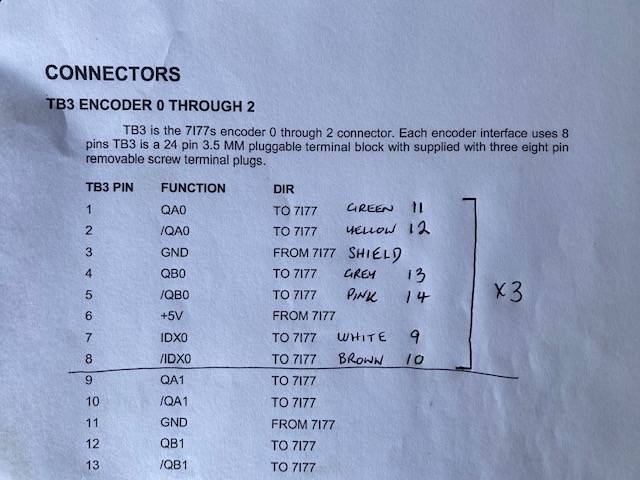

I have the analogue enables for x and y pulled from the 7I77 board.
Using only the z motor which is uncoupled from the axis, I enabled the servos and the motor drifts at about 2rpm then toggled F2. There is a quick jerk of the motor then a 'joint following error" on the screen.

So I've been playing around with encoder scale in the INI file for the 'Z' axis and am get some better result The motor is still drifting (slower) and now there is a delay (3s) before I get the following error when I start Linuxcnc,
From the attached document in my original post is there a correct figure I should be using in the encoder scale.
The last number I tried was 24576 for MKD041 motor
Peter
Peter
