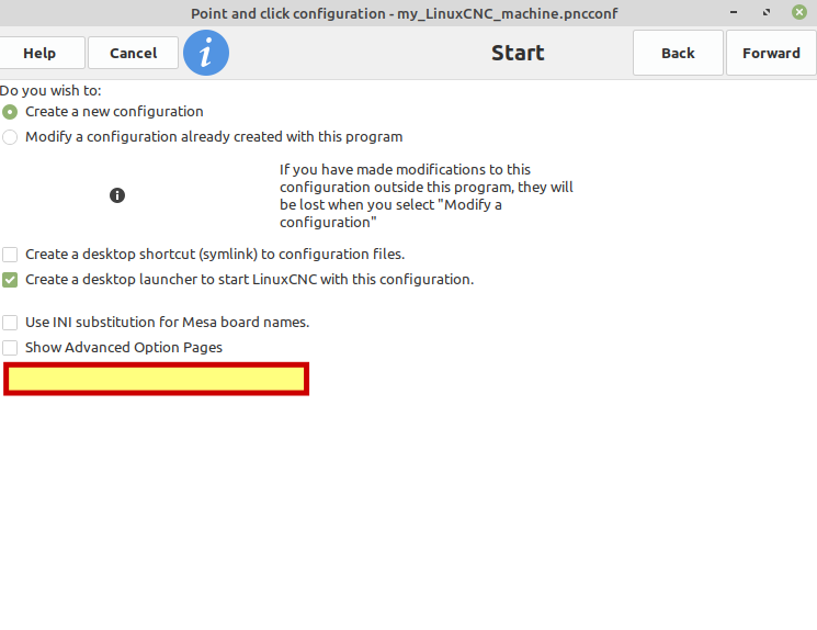

ppnconf - "Create simulated hw conf" missing was created by Fiury
Last edit: 5 years 9 months ago by Fiury.
5 years 9 months ago #194611
Replied by tommylight on topic ppnconf - "Create simulated hw conf" missing
Is that Mint 19.3 ?
Most probably something with the theme used by Mint, so go to preferences>appearance> and choose a different theme.
Had the same issue with sheetcam, i could not see over half of settings.
In your case can also be due to the use of different language, is Linux Mint in English?

5 years 9 months ago #194620
Oops, there is no simulated in pncconf, sorry for that.
Turns out you are using a non real time kernel so LinuxCNC can run only in simulation mode.
Did you install the RT kernel?
If yes, reboot, hold down the shift key till the grub menu shows up, choose advanced opions and there choose a name with RT in it, press enter.
To check the kernel in use, in a terminal:
uname -a
uname -a

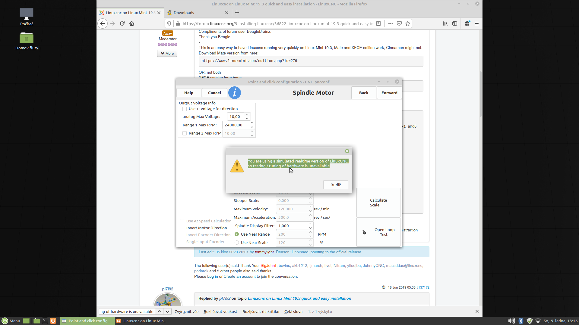

- Fiury
- Topic Author
- Posts: 17
5 years 9 months ago #194621
by Fiury
Replied by Fiury on topic ppnconf - "Create simulated hw conf" missing
Linux CNC 5.4.0-60-generic #67~18.04.1-Ubuntu SMP Tue Jan 5 22:01:05 UTC 2021 x86_64 x86_64 x86_64 GNU/Linux
5 years 9 months ago #194625
Nope, that is the normal generic kernel, reboot and check if you have anything with preempt-rt or RT in the name.

5 years 9 months ago - 5 years 9 months ago #194640
by Fiury
Afrter 3 hours of instaling RT Kernell ....... same problem with RT Kernall
Edited
Then reinstaled linuxcnc-uspace after kernell and WORKING !!!
THANKS !
Edited
THANKS !
