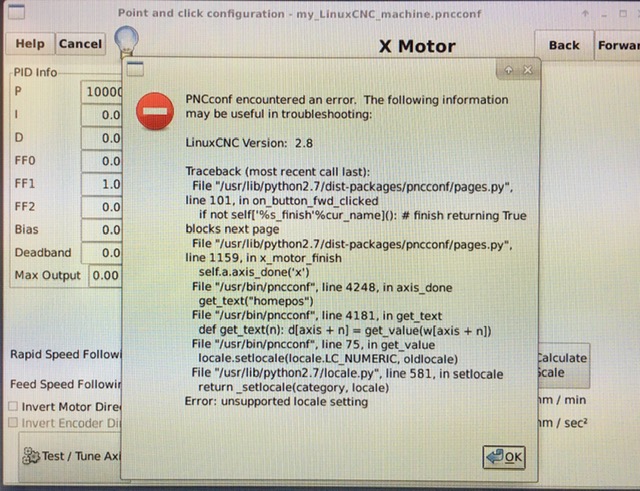

Hello, when I try to execute PnCConf I fill everything up to the axes page and when I want to turn the page I get the error of the image that I attach.
What I can do?
Thank you
What I can do?
Thank you

What language are you using on the system?

I installed it in Spanish and then changed it to English because the TB4-TB5-TB6 outputs did not appear.

how did you change the language please?

This link shows how to change the language: miguelmenendez.pro/es/blog/cambiar-idiom...stema-basado-debian/how did you change the language please?

What locale did you use.
Please be as specific and detailed as possible.

I reinstalled linuxcnc again and the language was set to American English
