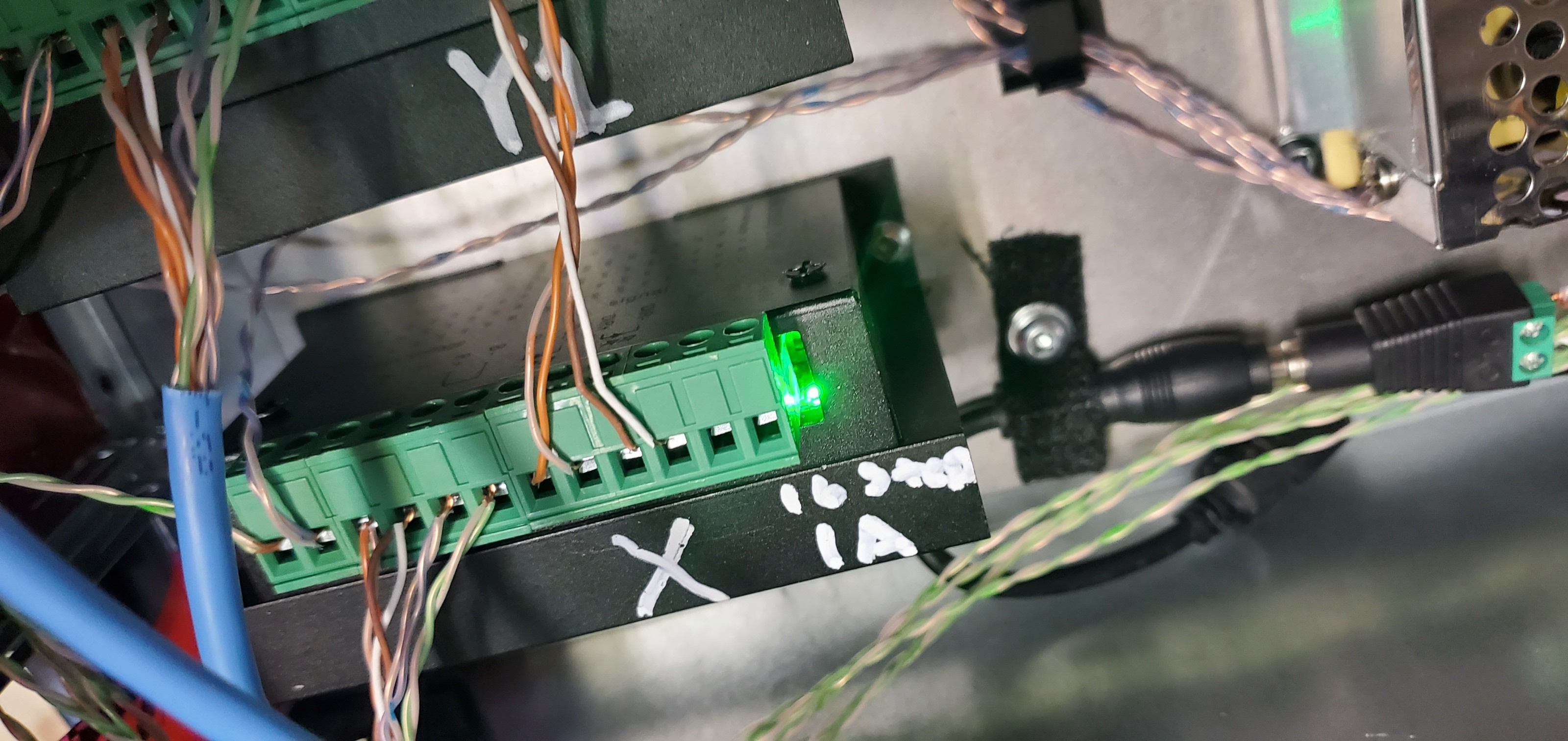

On the TB6600's I see a green LED on the X which works and then green + blue on the other 4. There's no documentation that identifies a blue light as far as I can tell.

09 Feb 2021 14:47 #198198
by Bearfood
Replied by Bearfood on topic 7i96 pncconf issue?
Tried that and no change.
I switched the wires from the7i96 to y1 driver over to the x driver and I can control the y motor off the x driver. I also can switch the wires from the motors to the x driver and can control the motors. I'm really starting to think that 4 out of 5 of my brand new drivers are the problem and that darn blue light means something bad.

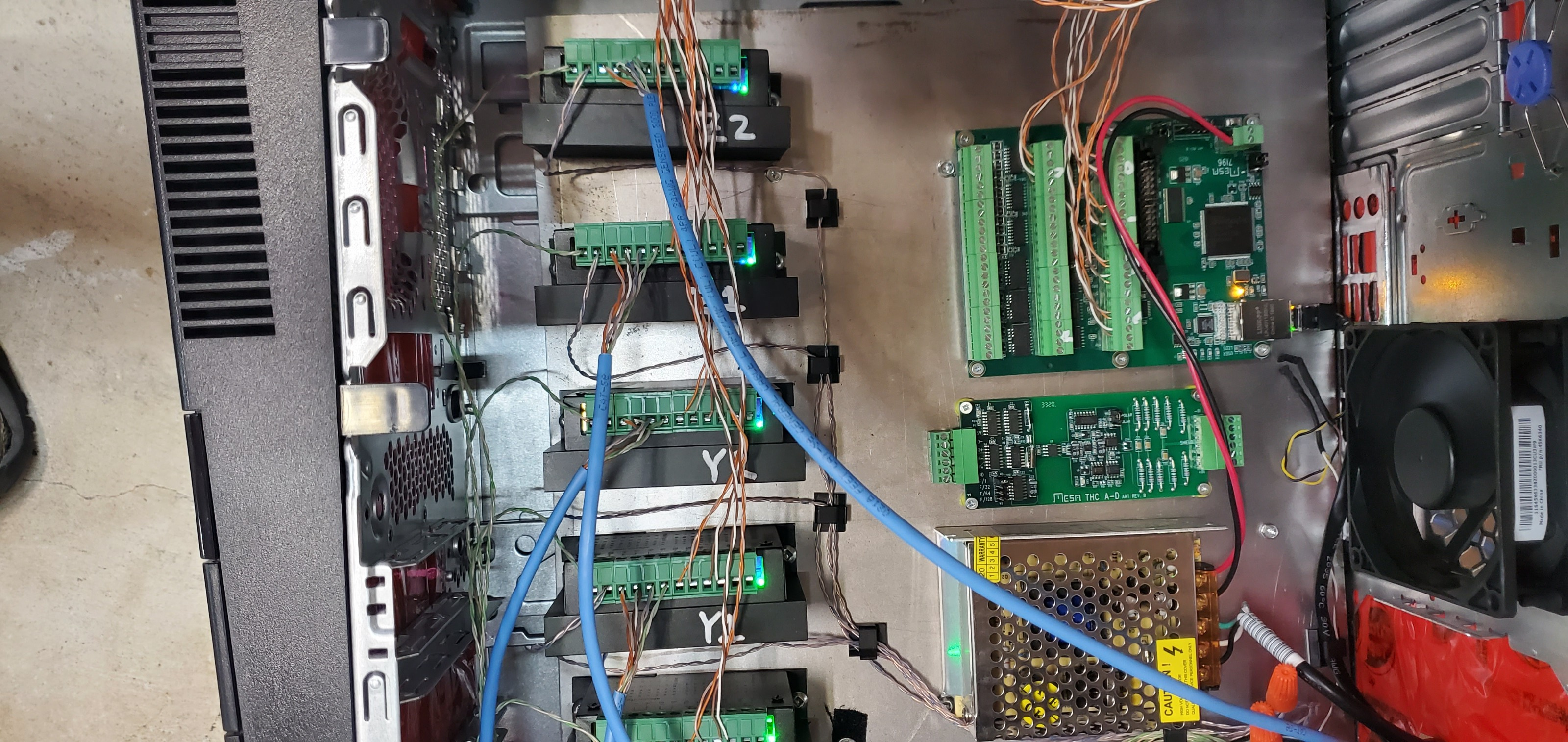

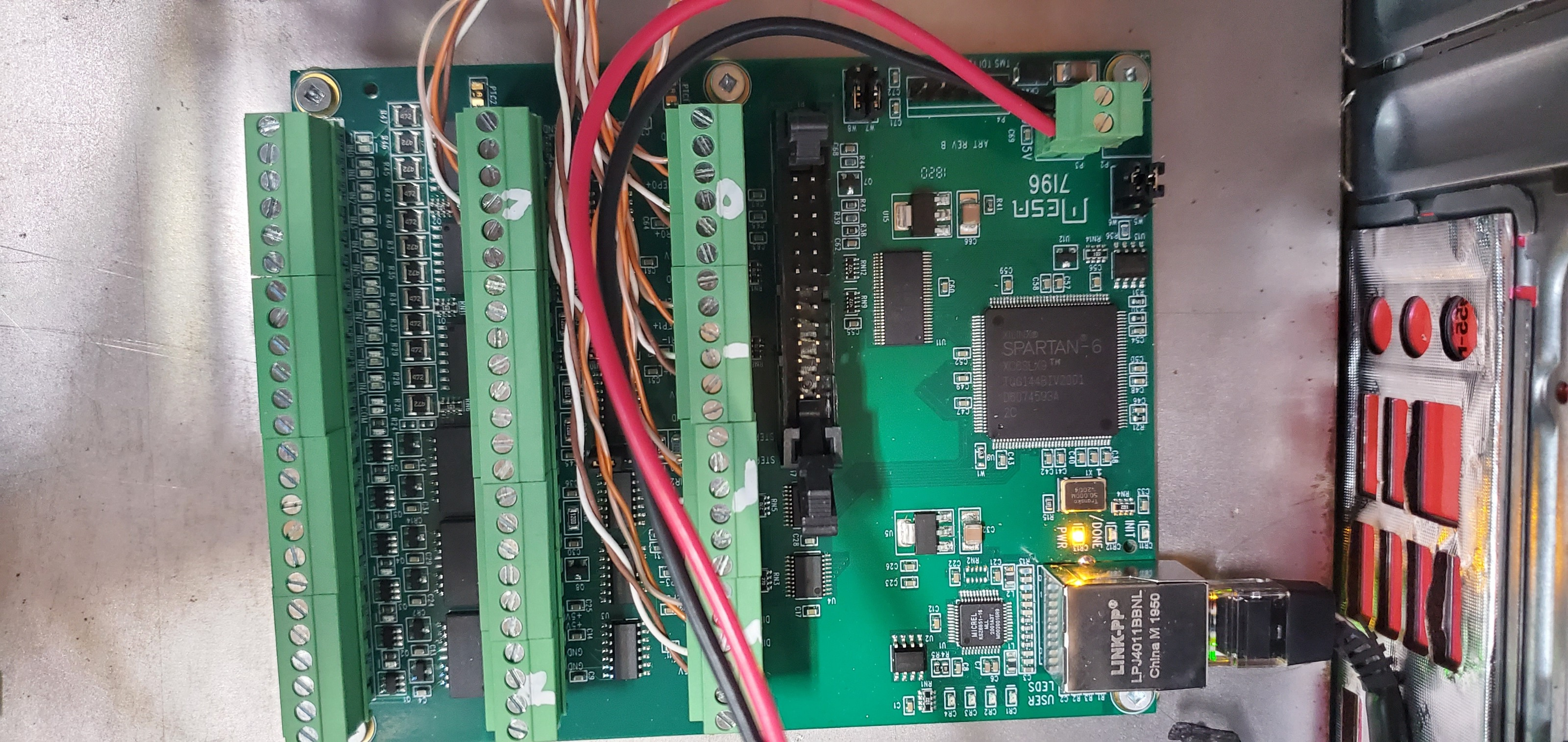

14 Feb 2021 16:02 #198855
by Bearfood
I didn't actually request an RMA. I just asked them what the blue light was and if it was the reason 4 out of 5 weren't working. Now that I have the 4 new ones I swapped them in and have the exact same issue. AARRUGH!
I took the 1 good driver I had and moved it to another motor and found it doesn't work. I took 1 of the "dead" drivers and put in on the X axis and it works. Son of a gun.
I swapped the wires between the a non working axis driver and the 7i96 to the working driver and the motor DOES NOT work. I could have sworn that I tested this before and it did work but I've tried so many combinations perhaps not.
Given that I've never done this before what can you guys suggest? I may have missed something major in my setup that leads to this.
Linux Mint running linuxCNC 4.9.0-13-rt-amd64
7i96 Mesa ethernet connected back to PC
default IP
Changed no settings on the 7i96
5v to Mesa
12v to drivers
wiring is using Cat5 ethernet cable.
drivers are 16 microsteps @1amp
I'll post a couple of pictures in a minute
I have not swapped the ethernet cable between the PC and controller.
Not seeing any errors anywhere
default IP
5v to Mesa
12v to drivers
- Bearfood
- Posts: 58
14 Feb 2021 16:05 #198859
by Bearfood
Pictures.
