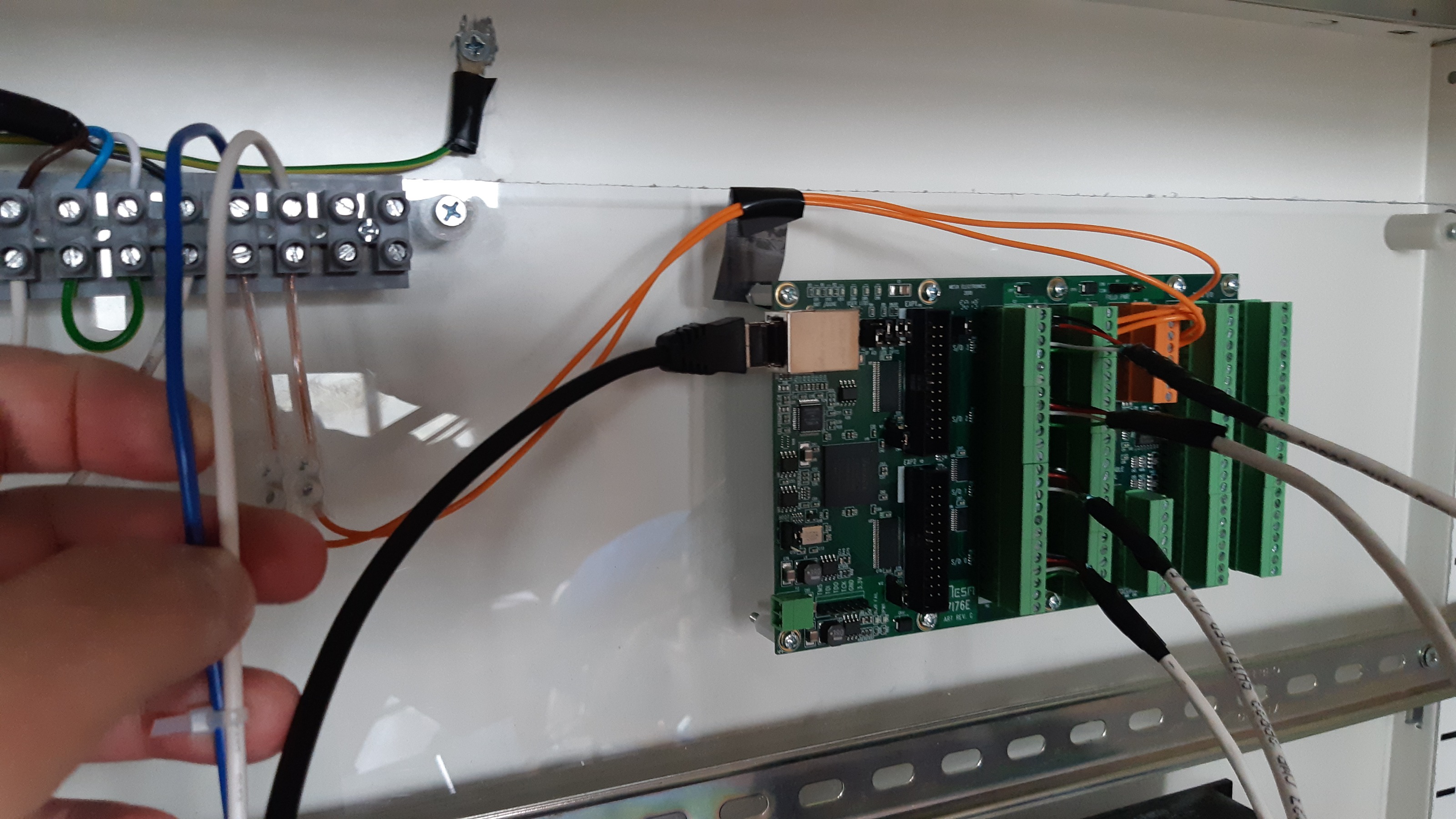

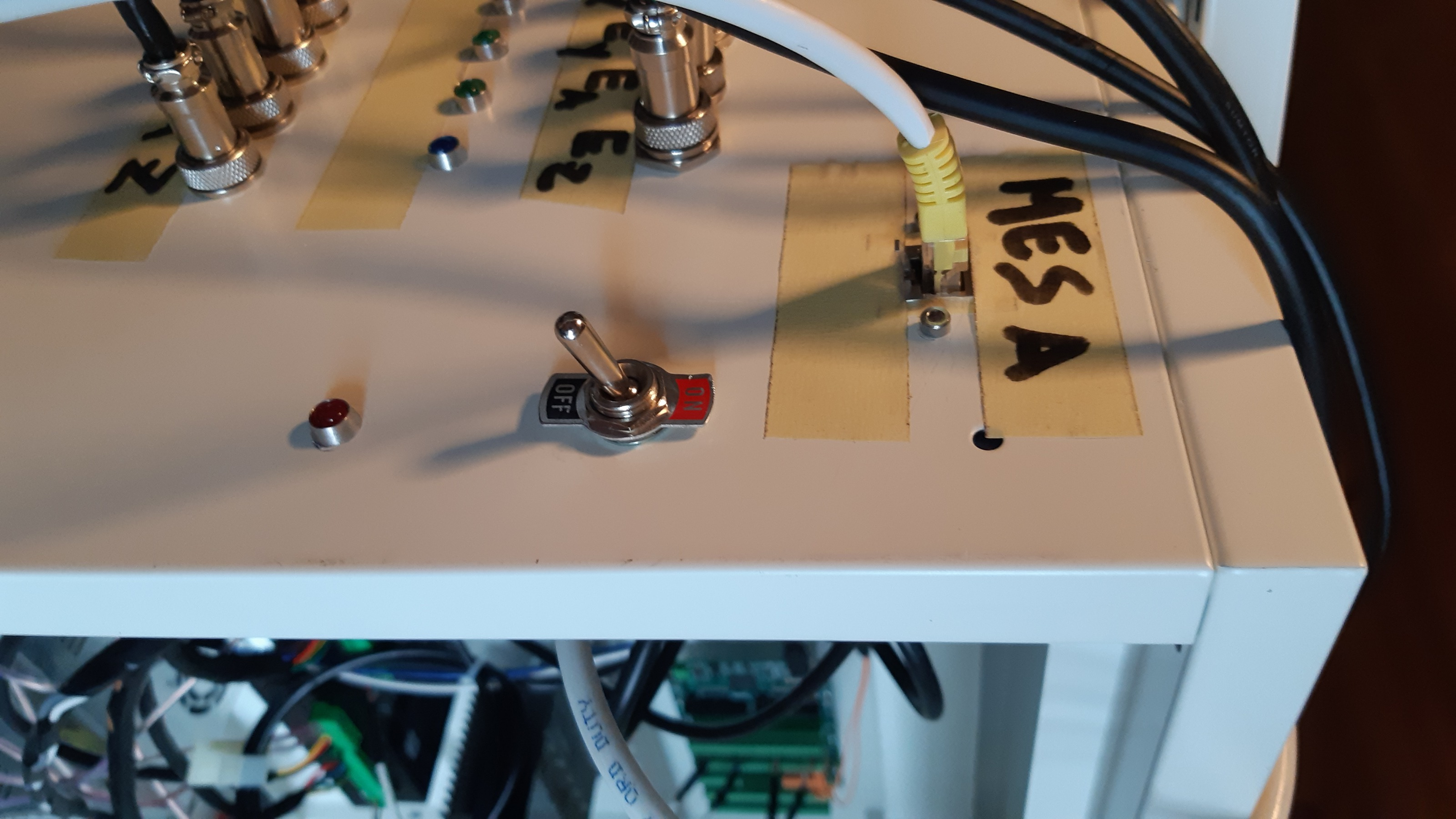

As you can see from my pics, I have a switch that turns on an ATX power supply (belongs to an old pc).
The ATX as an output of 12V that trigs a 12V coil relay.
When the 12 v coil inside the relay (that I pointed with my finger, just under the ATX) is energized, the two normally open contact, close and the 240V can flow to the power strip and from the power strip goes into the 24v power supply.
The 24V power supply goes into the same power strip and to the mesa card.
No switch between the 24V and the mesa card; only a power strip among them.
What I am trying to say is that my launcher give this error when the machine is off and the Ethernet cable not connected.
I was expecting that I can start my linuxcnc launcher without the machine on and the Ethernet cable connected but in this case my linuxcnc launcher is not starting and this error comes on.
If machine is on and Ethernet cable in the result is no error and my linuxcnc launcher start with no problem.

- Posts: 18122
- Thank you received: 5337
12 Feb 2021 20:26 #198637
Replied by PCW on topic A bit of fog in the brain on Pncconf Wizard
You would need the7I76E to be powered to start LinuxCNC without error
The following user(s) said Thank You: sibelius
