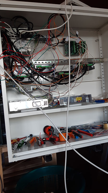

Good evening
I manage to wire all my machine and linuxcnc does not give any error.
At this point I started to home X and everything went well; than after that I have tried to home the Y and Y2 (synchronized) and I can see from the HAL SHOW that they copy moving but physically the two motors don't make any movement.
When I power on the machine all the motor are engaged (I mean you cannot freely turning the shaft).
I m going to post my ini and hal file.
If anyone has some idea would be great.
Thanks in advance
V.
Thanks in advance
V.

-remove the connector from 7i76 X axis and insert the one from Y or Y2 or Z to test.

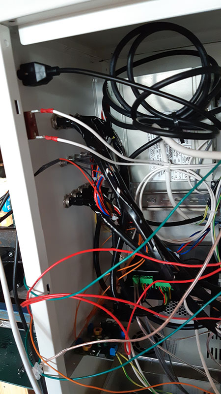

Good evening to everyone
Thanks Tommy, that's exactly what i did but did not solve the problem.
So what I did in the end was to check all the connection from the avion jack, I have two of these connector for each axis, one for pulse and direction and the other to broadcast the signals from the encoder.
What i found out was that two connection that i soldered were bridged, in other words they were touching each other.
So patiently I checked all the others avion jack and now is ok.
i did not home the machine yet because i have to solve another problem with my hal file at this link
forum.linuxcnc.org/24-hal-components/414...up-on-stepper-driver
Thanks again for all your help.
V.
V.
