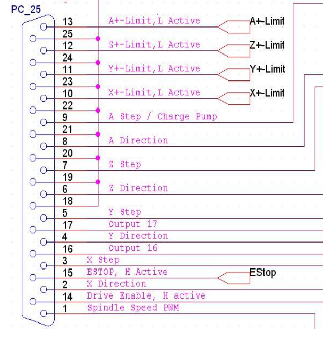

I am trying to use PNC conf to get to a working configuration for the Mesa 7C81. My machine uses a breakout board from DMM, the DMB4250-8B BreakOut Board. This is sort of similar to the chinese BOB that seem to be widely used, but does not, as far as I can tell, use the same pinout. When I read the configuration currently loaded on the 7C81:
I have been consulting the thread here , which has a lot of useful information, but I am not sure how to make that last step of mapping the pins i need to their respective outputs to connect to my breakout board. I have attached a screenshot of the pinout of the breakout board. Since this is "non-standard" pinout for the DB25, is it required that I create a custom bitstream for the 7c81? It would surprise me if all pin functionalities were multiplexed to all pins on the FPGA. I presume only the "primary" pin function and GPIO uses are multiplexed. As you can see, my pinout is not compatible with what is currently configured on the 7c81.
I could also imagine using some sort of interposing board that crosses all the required pins from one location to another, but I don't particularly relish the thought of doing that.
I had the machine working with a simple parallel port, but it was too slow and I need to add an additional independent motor and homing switch, as the machine has a gantry, and I could never get proper alignment with the two gantry motors when they run from the same step/dir source.
Could someone give me some guidance? I am a beginner with Linux CNC, but I have some experience with FPGA's.
Thanks,
Brian

The DMM BOB is pretty standard but I had not made a 7C81 config for it yet, but here it is:

Ahh, yes, I see. I was not looking carefully. Indeed the output is different, with just the direction and step swapped after loading the new firmware. But is that really the only difference between the 5ABOB and the DMM breakout?
For instance, in the new pinout:
I note that there are also unused pins between the step and direction pins. Is that really the case? In my read of the DMM schematics, the step and direction pins are on neighboring pins? Maybe I am missing something...
E.G. it should look something like this:
Thats my read of the schematic, operating on the assumption that P1-xx refers to the pins of the db25 connector? I may be misunderstanding something though...
Best,
Brian

P1 refers to the header pinout, the driver probably should have the DB25 pinout also
(the latest mesaflash will show DB 25 pins with --readhmid )
and yes, I think the step/dir order is the only real difference between DMM BOB and 5ABOB
(The latest driver/firmware allows swapping step/dir on a per channel basis so with
that the 5ABOB and DMM bob would be interchangeable)

Thanks PCW! I think that I am overthinking this a bit. I will trust that the correct pins map to their correct locations. I guess the final question is with regards to the usage of PNCconf. I have basically no idea what I should fill in here:
or here:
I don't understand how these map to actual db25 pins...
or here:

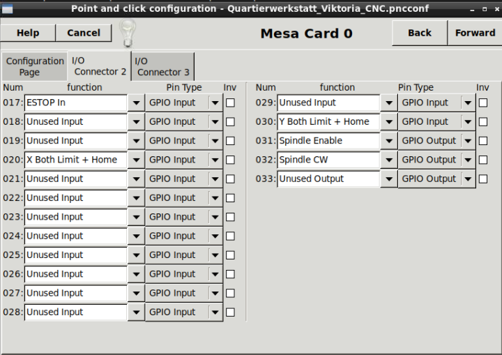

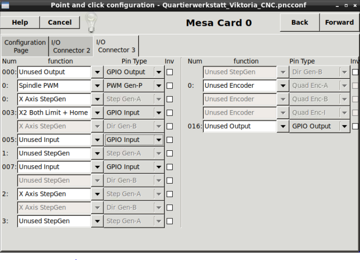

Replied by PCW on topic RPI4 + 7C81 + DMB4250-8B BreakOut Board
The mapping of GPIO to DB25 pins is listed the the --readhmid output
The P3 (= 7C81 P1) mapping is correct but PNCCONF GPIO mapping on P2
(= 7C81 P2) will not line up so you probably need to do these by hand
connecting in the hal file
