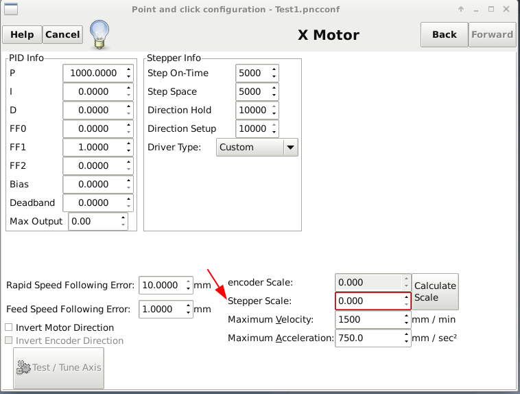

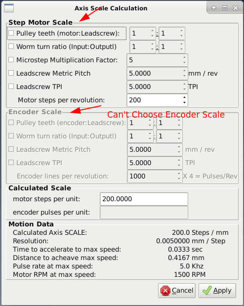

Hi All
I have a problem setting the encoder scale/stepper scale.
My thought is that when using a servo motor we have to enter the input in the Encoder Scale,
and when using a stepper motor we have to enter the input on the Step Motor Scale? (CMIIW)
i am using a servo motor with a 2500P/r encoder and i am using a ballscrew with a pitch of 10mm ..
for electronic I use mesa 7i76e. I have tested the ping to 10.10.10.10 and have received feedback
My question are :
1. Why can't the encoder scale on the Axis Scale Calculation tab be edited? (gray)
2. Is there any other way to enter the encoder scale / stepper scale apart from using the Axis Scale Calculation?
Thank You,Thank You, Thank You in Advance

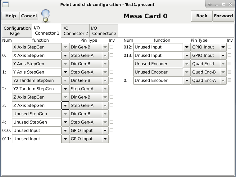

Replied by Aciera on topic Help! Configuring Encoder Scale/Stepper Scale
Wouldn't you need to configure the Encoder on the bottom right of the "I/O Connector 1" page? Where it says "Unused Encoder" you would choose "Axis Encoder" and then the axis.

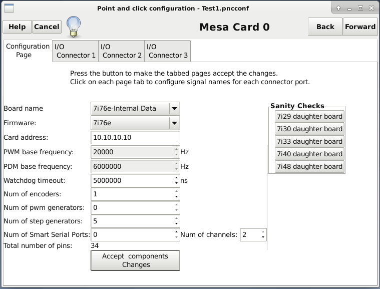

- Sadmeatball
- Posts: 13
06 Mar 2021 13:11 #201184
by Sadmeatball
Replied by Sadmeatball on topic Help! Configuring Encoder Scale/Stepper Scale
now the problem is i can only set the encoder for 1 axis only.
whereas I have a total of 4 servo motors. X-Y-Y2-Z
I use a panasonic ac servo motor minas A4.
can you tell me, what i did wrong or forgot?
Many, many, many thanks in advance

- Posts: 18087
- Thank you received: 5321
06 Mar 2021 14:45 #201189
Replied by PCW on topic Help! Configuring Encoder Scale/Stepper Scale
For step/dir interfaced servos, you only need to set the step scale
the single encoder on a 7I76e is for the spindle
The following user(s) said Thank You: Sadmeatball
