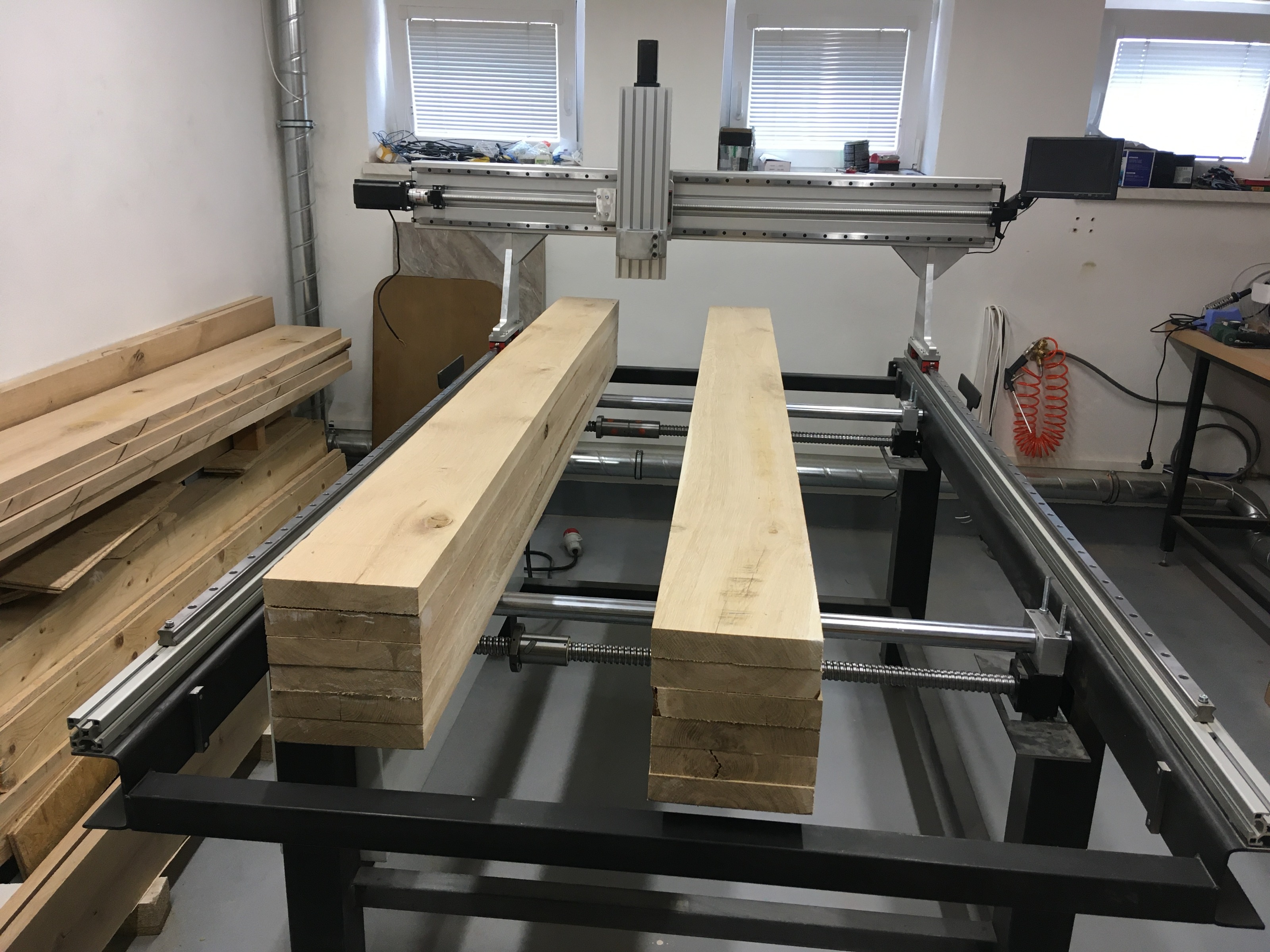

by Fiury
4 is set default of VDS. This parametr i did not changed :´-(
Taday i ant to start mill oak glued beams, for this machine .... and nothing....
Replied by Fiury on topic Spindle - 7i76e
Has this ever run with the parameters before.
Have you check the number of poles some of these vfd's come with them set at 2 or 4 if I am not mistaken I think they should be set for 2 PD143
Last edit: 04 Apr 2021 10:59 by Fiury.

Can someone post setup VDF for :
2,2 kW HY inverter and 2,2 kW watter spindle:
Then Configure the VFD
PD001 = 1 (external terminal)
PD002 = 3 (which was not in manual)
PD044 = 1 (for RUN)
PD045 = 5 (DIR.......FOR /REW)
other PD* ?
I don´t want to burn next spindle.. :/
Thank you very much
PD044 = 1 (for RUN)
other PD* ?
Thank you very much

Replied by andypugh on topic Spindle - 7i76e
I would look a PD11 (min frequency)
Check PD141 to PD146, especially PD142 and PD146
You may need to pay attention to the V/F curve, PD04-PD10.
