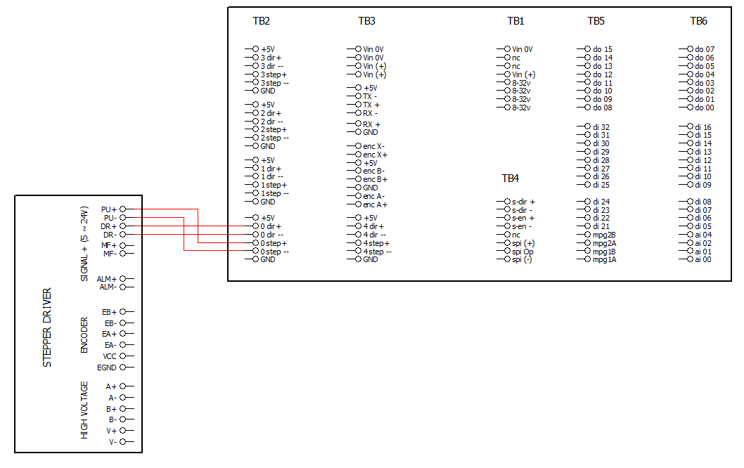

I notice you only changed the Z axis, is this the axis you are testing?
What kind of drives do you have?
How are they wired to the 7I76E?

Sorry for the confusion. In the attachment you will find the correct .ini file. I am testing the X axis motor.
See the picture for the wiring.
Here you can find the driver I am using: Driver
I find it very strange that the motor is not running correctly. It can't be the motor or the driver because I have already made the motor run without using LinuxCNC and the MESA card.

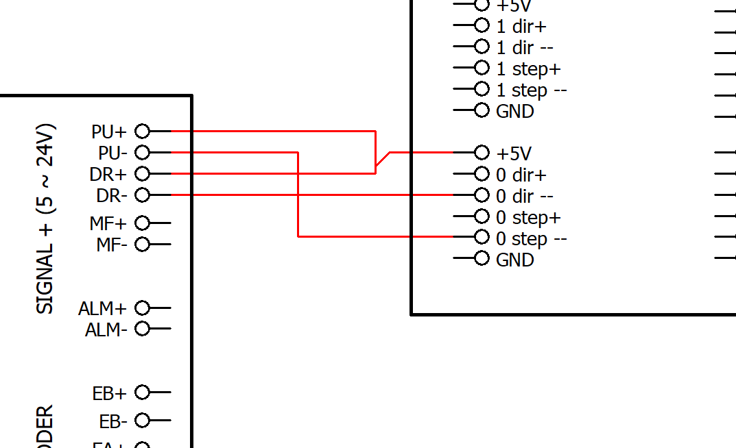

I would try single ended wiring as sometimes drives need more
current than the 7I76E can deliver in differential mode so:
PU+,DR+ to 5V
PU- to Step-
DR- to Dir-
PU+,DR+ to 5V
PU- to Step-
DR- to Dir-

Do you mean like this? So that the dir+ and step+ of the MESA card are not connected?
- Posts: 18111
- Thank you received: 5330
17 May 2021 18:48 #209259
Replied by PCW on topic Error in PnCConf with 7I76E
Yes

It works! Thanks for helping me through this. I really appreciate it!
