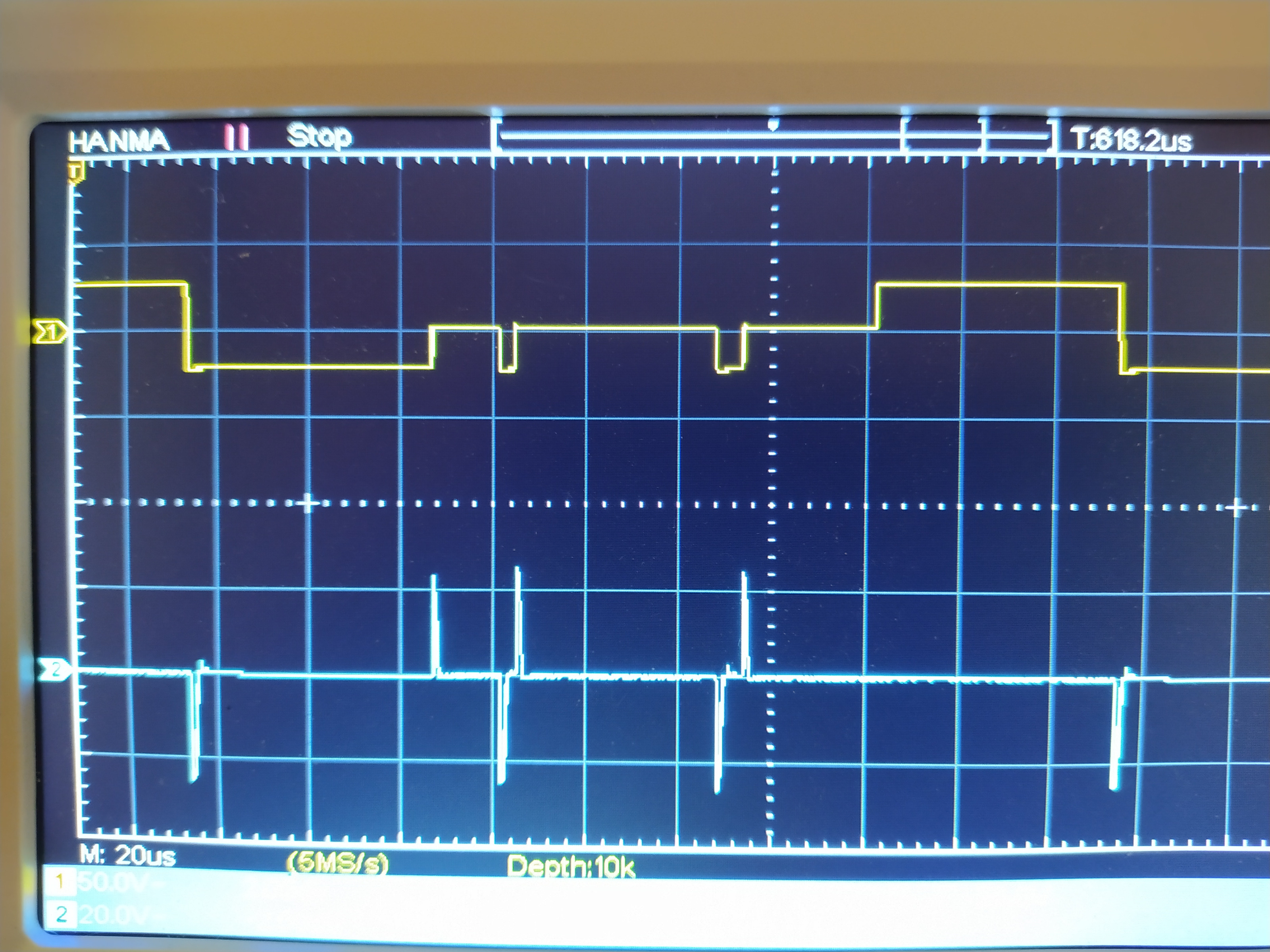

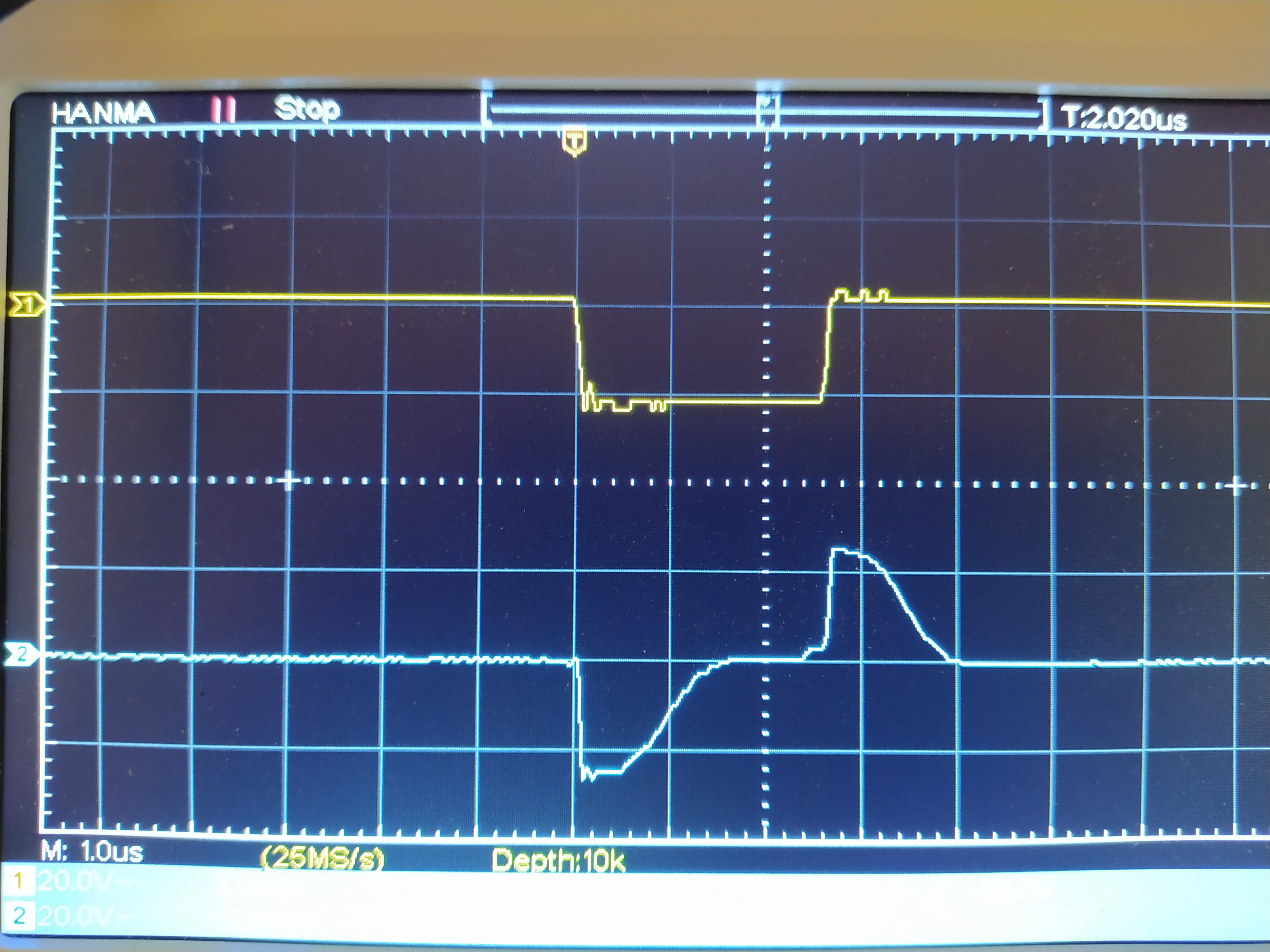

Hello,
I am trying to setup a driver (M545D) with a stepper motor (23-205-DS8) and I am unable to get the motor to work. When I run the pncconf calibration test, the motor stuck (I think it's Ok). But when I try to move him forward, I only hear some sounds... When I compare the signals A1 ~ A2 and B1 ~ B2 with an oscilloscope, they are not symmetrical. Is it normal? I tried a lot of settings, but without any success...
Here is what I have when the motor is stuck:
And what I have when I tried to move it:

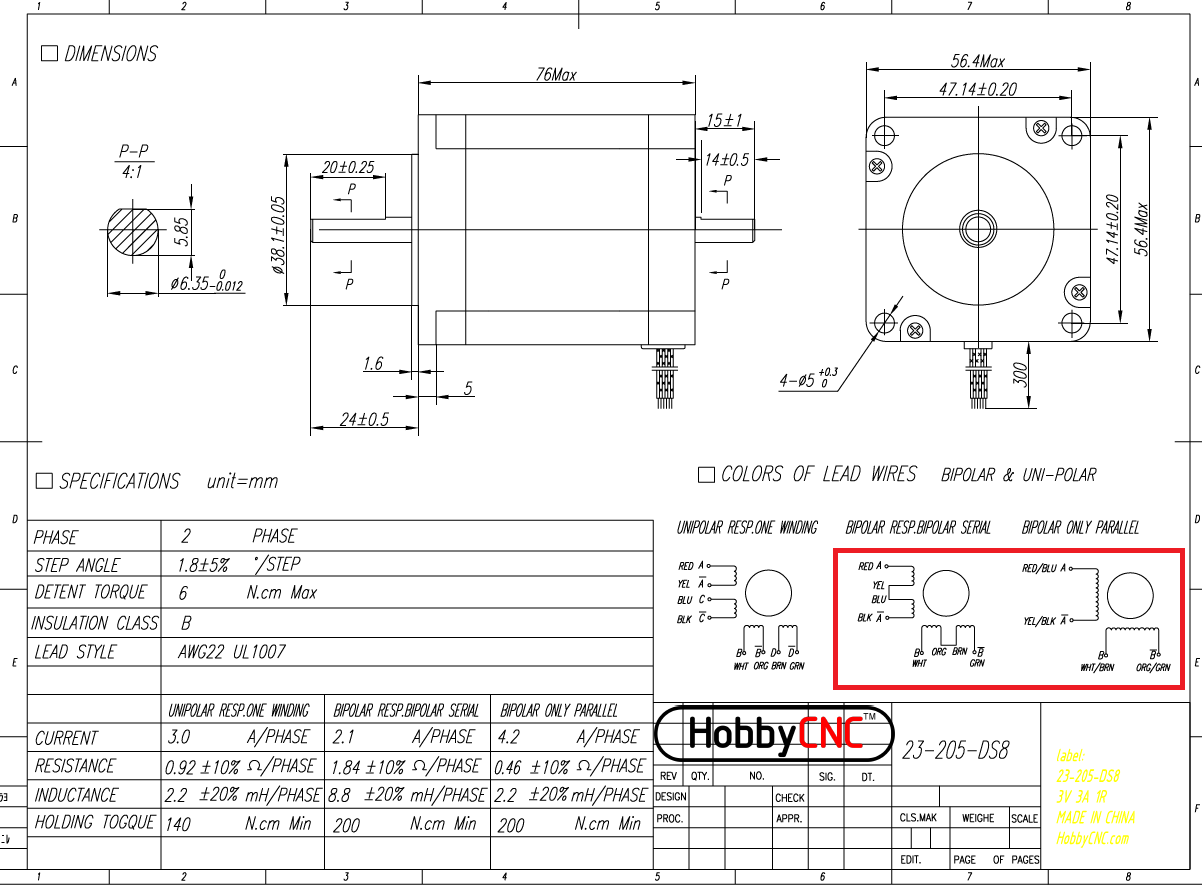

21 May 2021 18:41 #209776
Replied by andypugh on topic Setup a M545D driver with a stepper motor
I have had 8-wire motors where the wire colours in the data sheet were completely different to the motor. (Well, the colours were the same, but they were connected differently)
1) Work out which wires are the ends of each winding. You can do this with a multimeter, or, choose one wire and see which wire, when held touching it, makes the motor harder to turn. When you find a pair, make a note, and tty to find another pair. Make sure that no wires touch other wires, though.
2) Once you have the pairs you need to work out which ones are A and which ones are B. I have forgotten how to do that..
3) However, I do remember how to work out the polarities. Take both of your A pairs, and connect two of the wires together, Then connect the other two. If the motor is stiff to turn then either of the current connections can be a centre-point. If the motor remains easy to turn, swap one pair end-to-end, and then try again.
Basically with the correct polarity they add, and the motor feels stiff. With the wrong pairings they cancel, and it is as if there is nothing connected.

23 May 2021 05:00 #209878
by Goulven
Replied by Goulven on topic Setup a M545D driver with a stepper motor
Thanks Andypugh, I had already checked both wires with an ohmmeter.
To check if a pair is A or B and to check the polarity I used a 9 volt battery: if two pairs are A with the same polarity I can't run the motor otherwise I can.
I also tried to order the pairs differently without success, so I ordered a 4 wire motor to test the driver outputs.

24 May 2021 11:52 #210050
I think that you will get the same result if you have one half of A and one half of B (with any polarity?) That's one of the half-step positions.
I think that you can probably tell if you have both halves of a phase by checking that there is no half-step if you power the second pair of wires with the first pair already powered.

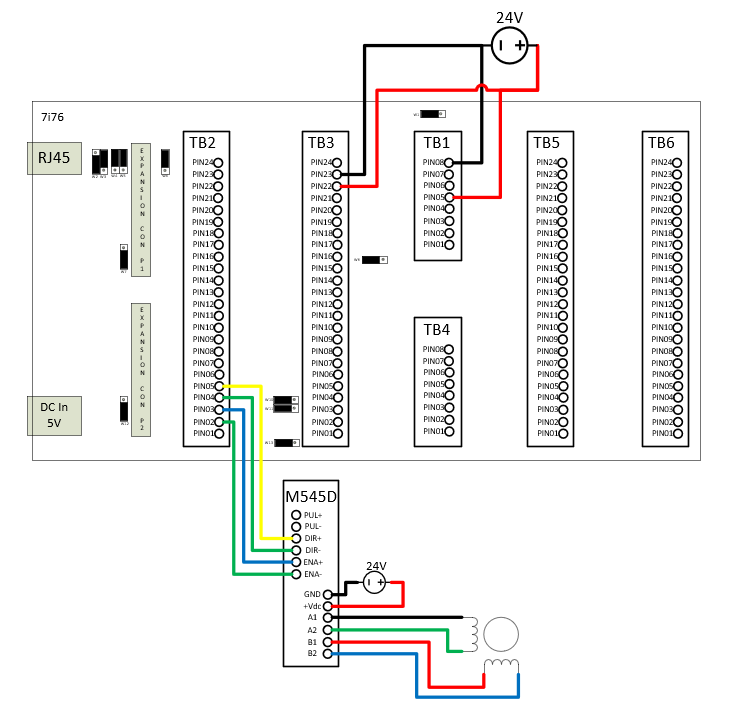

29 May 2021 09:53 #210610
by Goulven

29 May 2021 10:01 #210611
by BeagleBrainz
Replied by BeagleBrainz on topic Setup a M545D driver with a stepper motor
Is that diagram labelled correctly ?
Your diagram has the enable connections connected and the pulse connections disconnected. Usually its the other way around.
This thread maybe of help.
forum.linuxcnc.org/27-driver-boards/3191...-sheet?start=0#83565

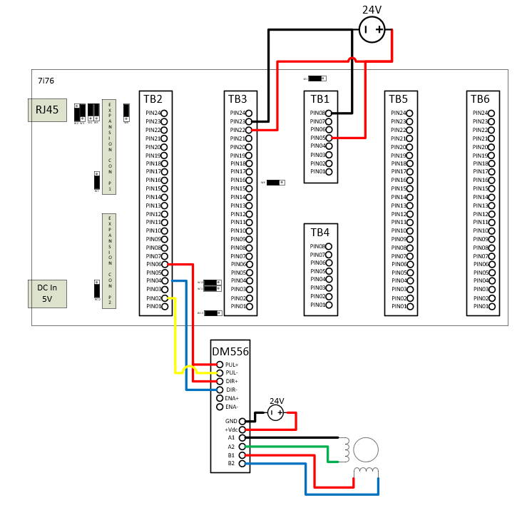

29 May 2021 11:16 - 29 May 2021 11:37 #210615
by Goulven
Thanks BeagleBrainz. after reading this thread it's working with DM556:
forum.linuxcnc.org/27-driver-boards/4013...t-it-to-move-stepper
Here is how i wired the driver (Don't working with M545D):
Last edit: 29 May 2021 11:37 by Goulven. Reason: Wrong driver
- Goulven
- Posts: 21
- Thank you received: 3
29 May 2021 12:54 #210620
by Goulven
it's also working for M545D with Hobbycnc 8 Wires Motors (23-205-DS8) with the same conection...ThX Andypugh and BeagleBrainz
