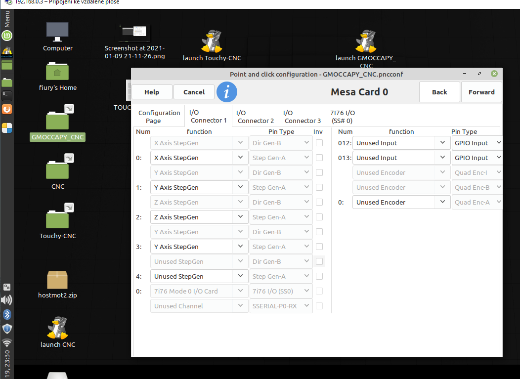

i am building router XYYZ , is it any chance to set "gantry" thru PNCCONF ?
I use pncconf to set 7i76e:
But still have in INI file only 3 joints.
I am newbie , this linuxcnc.org/docs/2.6/html/man/man9/gantry.9.html tell me nothing :/ .
In this moment function X,Z, spindle , but need to set 2x Y (and some "gantry" setting) .
When this will be ready i will start with limits..
Can enybody help with 2x Y (and some "gantry" setting) ?

Did you setup a tandem (Y2) axis in pncconf?

Replied by tommylight on topic Gantry thru PnCConf ? XYZY
Choose XYZ, then at the stepgens choose the usual X, the Y AND tandem Y, then Z.
Also a bit of care when choosing what input pin has what Y axis limits/home switches connected to it.

Hello,
now i set XYYZ (with tandem Y), i will change wiring.

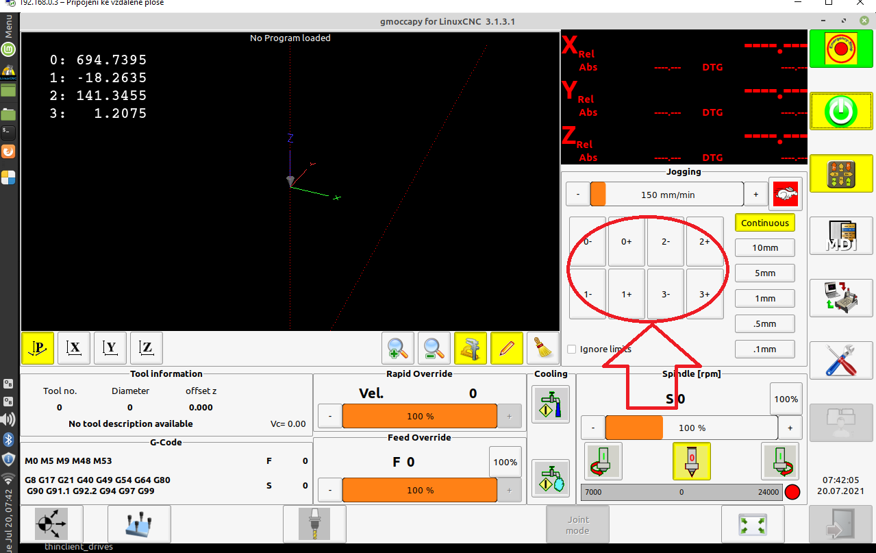

But one more thing , how to change gmocappy to have classic view of XYZ arrow. ?
(i tried tandem Y2 before, but this discouraged from this solution)
Thank you

- Posts: 21824
- Thank you received: 7453
20 Jul 2021 16:47 #215425
Home the machine first, then it will go back to XYZ.
