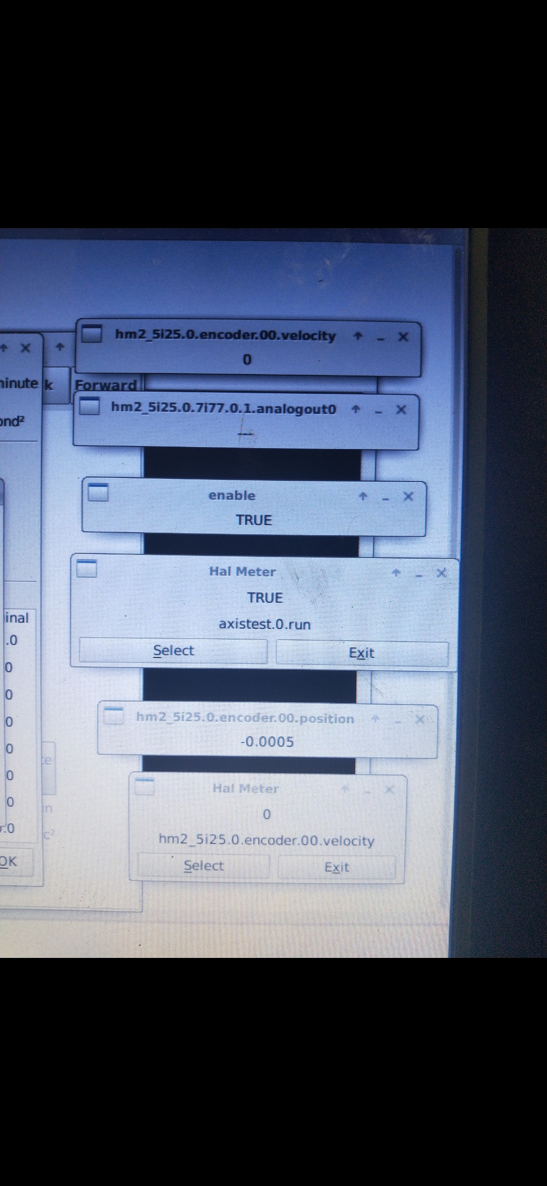

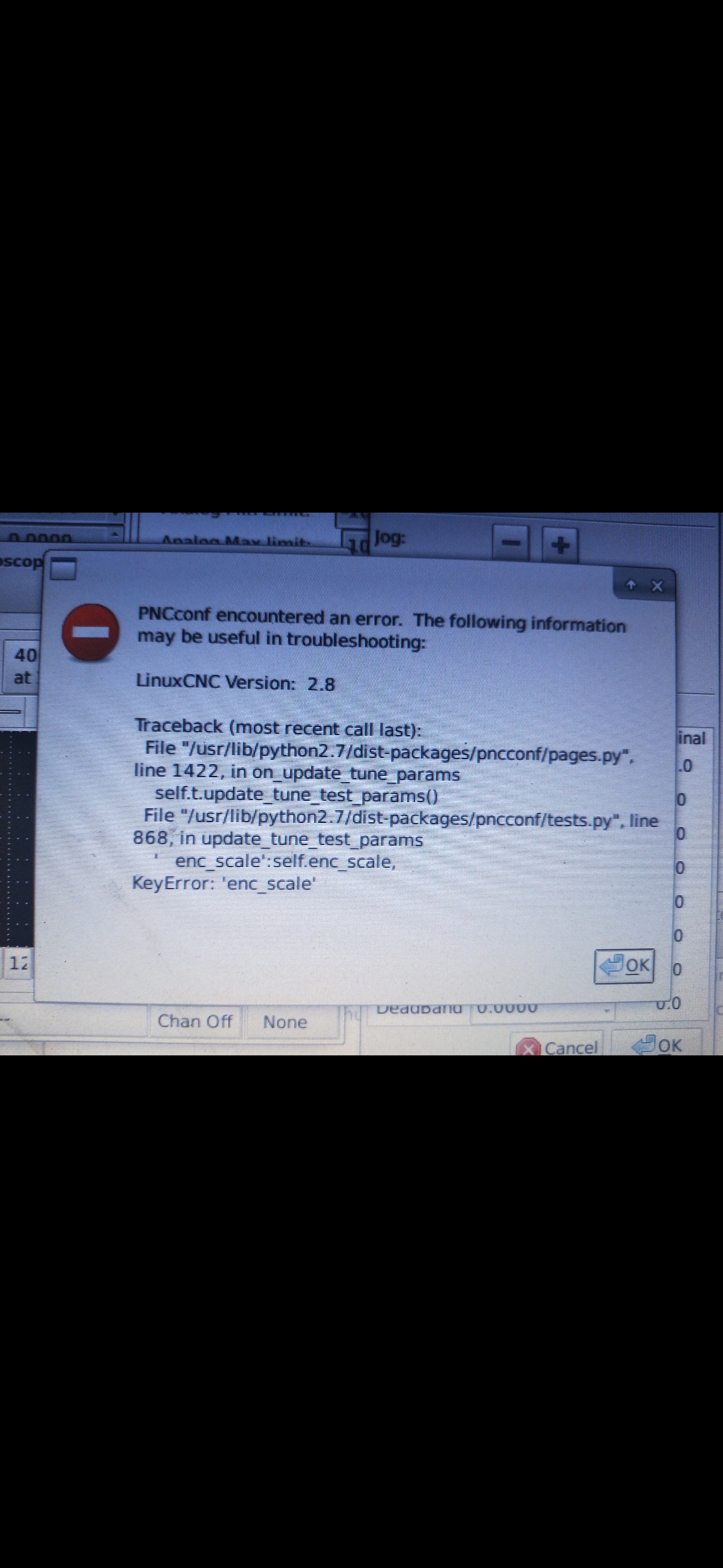

The problem is with pncconf. when i open the test and tune servo axis, a lot of hal windows open for analog out and encoder inputs. the linear encoder works fine and changes values when the axis is moved manually. but when i try to run servos , i get the following error. also, there is some active voltage(around 0.5v) in analog out pin of TB5, hence the motors start to run as soon as they are plugged in the mesa cards (even when red led CR16 is on). Also i get message "Servo tuning is not tested in PNCconf yet" when i click on test and tune servo.

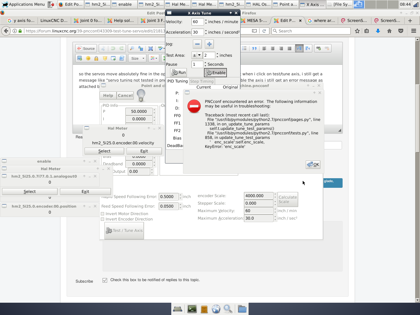

so the servos move absolutely fine in the ope loop mode, i can jog them easily. but when i click on test/tune axis, i still get a message like "servo tuning not tested in pncconf yet". and when i click ok and enable the axis i still get an error message as attached below.
Last edit: 19 Aug 2021 12:45 by Sourabh3.

19 Aug 2021 15:40 #218148
Replied by tommylight on topic test tune servo
- Posts: 7368
- Thank you received: 2181
19 Aug 2021 17:18 #218161
Replied by cmorley on topic test tune servo
I think I see the error. I'll confirm tonight after work. Thank you.
